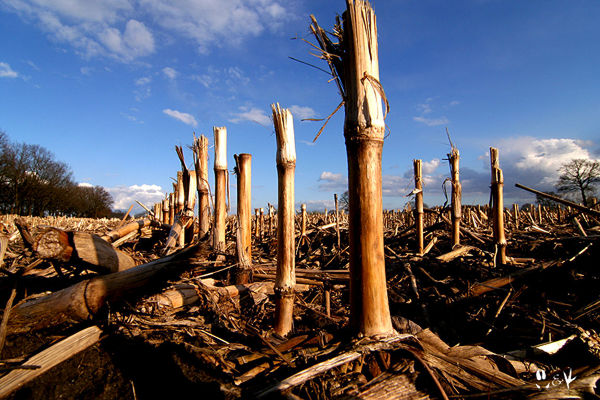

As for the EF-S 17-55 f2.8 IS USM, it is very pricey, but it does deliver... sharpness that exceeds the "comparable" lenses from Nikon, Sigma and Tamron, fast and accurate AF due to its USM motor, and IS of course, that can be invaluable in lower light situations at times.
If you do not want to spend just that much in that range, you could consider the new Sigma 18-50mm f2.8 macro. And the Tamron 17-50 f2.8. Both are quite good, and cost more than half less.
But you do have quite a good lens in that 28-105mm f3.5-4.5. So you might just get other lenses first... Personally I use a much wider lens for landscape stuff. A Tokina 12-24mm f4. Very good colour and contrast. Only downside: at 12mm quite some chromatic aberations. Another wide angle zoom worth to consider (but more expensive, and do not forget to order its sun hood, it does not come standard but is very needed), the Canon 10-22mm f3.5-4.5. These two wide angle zooms should give you very nice possibilities for landscape photos, and they would complement your focal range of the 28-105mm quite well.
Example of the Tokina 12-24mm f4 at 12mm:
