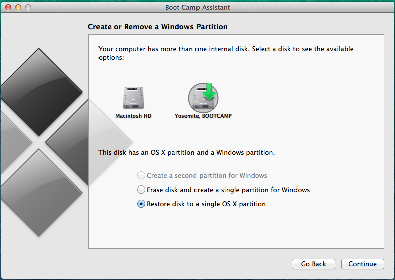

thats my macbook pro 13 inch early 2011 with 1 tb HDD (yosemite and windows 8.1) and 120 gb SSD with mavericks
i had mavericks on 1 tb hdd with bootcamp i installed yosemite on top of mavericks didn't affect bootcamp then moved the 1 tb hdd to optical drive bay and installed an SSD in main bay and installed mavericks on it all 3 operating systems are working fine

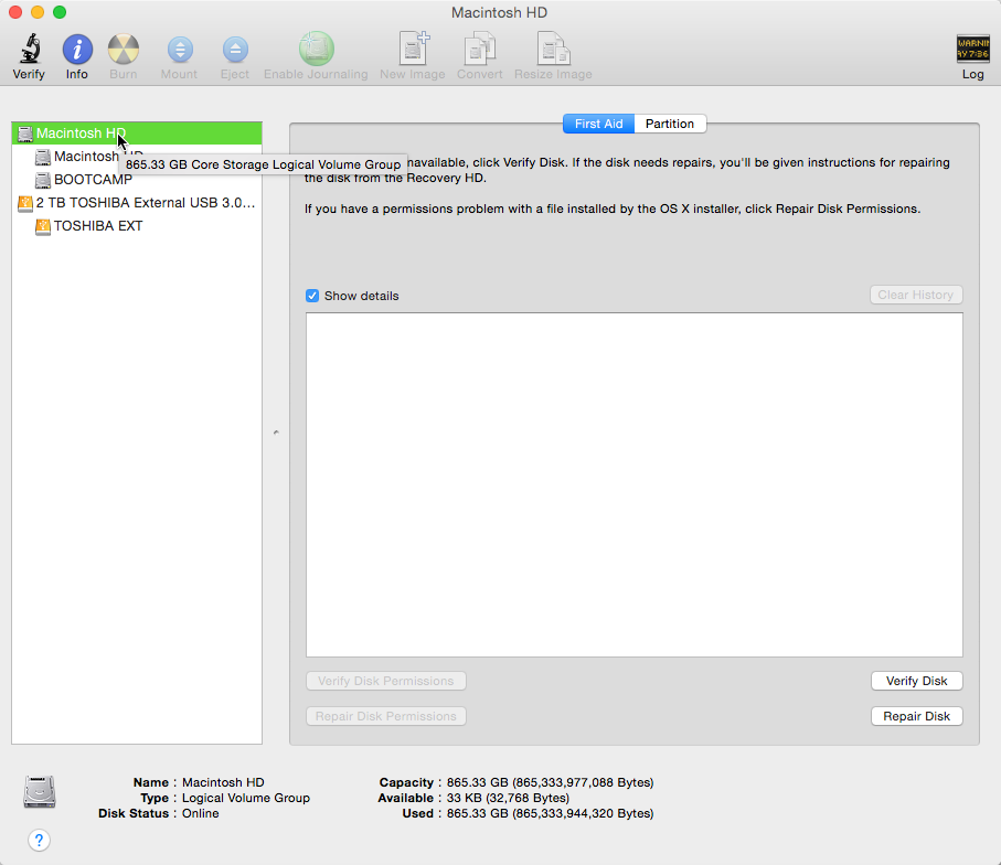

Some are reporting the Yosemite install converted the partition from a normal Mac OS Extended partition into a core storage volume. There is a support doc. here on page 7 that talks about it a bit.
It had been used for Filevault encryption and Fusion drives, but Yosemite seems to be using it on just standard unencrypted installs.
If you look in Disk Util (screenshot) it will look like this.
Here ya go:
Is that good or bad, that it converted it?
It does not create any issue that I can tell beyond not being able to resize the partition. There was a post in another Yosemite thread where a user reported this to Apple as a bug and they closed his bug report and told him this is by design. He was not told why they did this though.
I would just leave it alone. Hopefully at some point someone at Apple will reveal the logic behind this.
