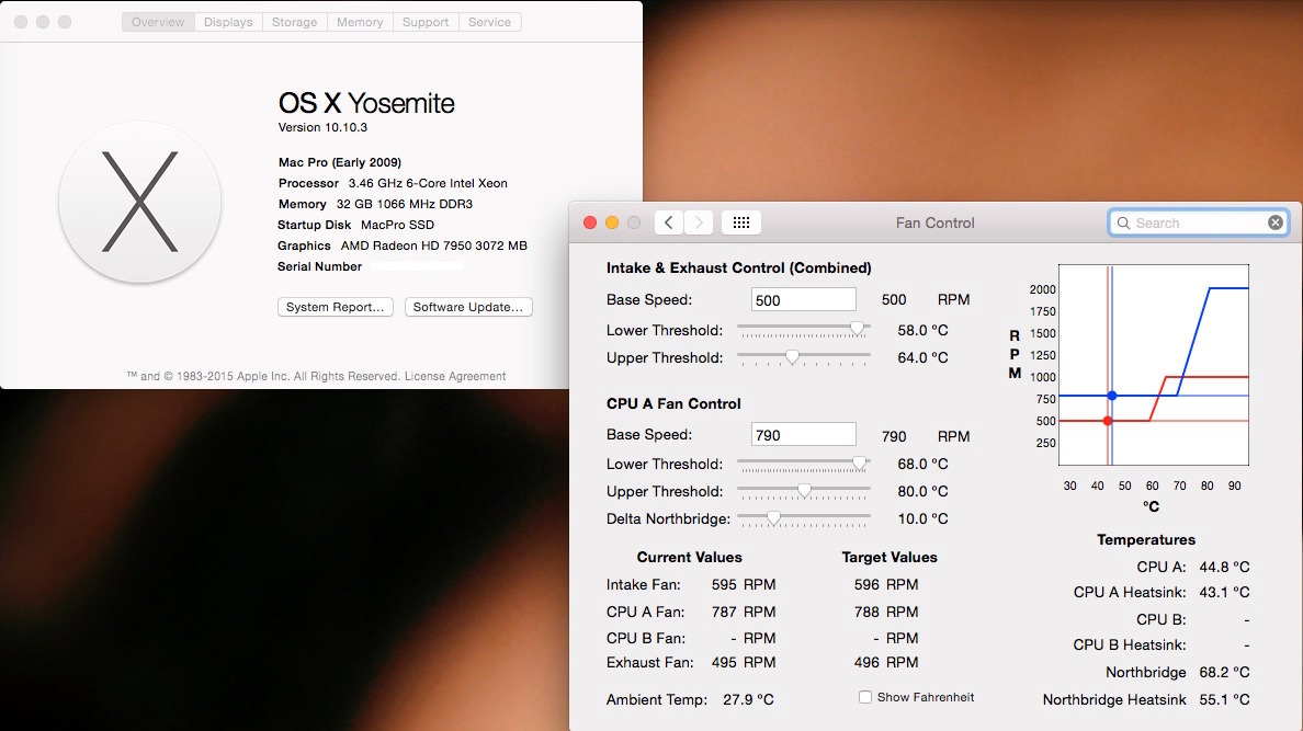

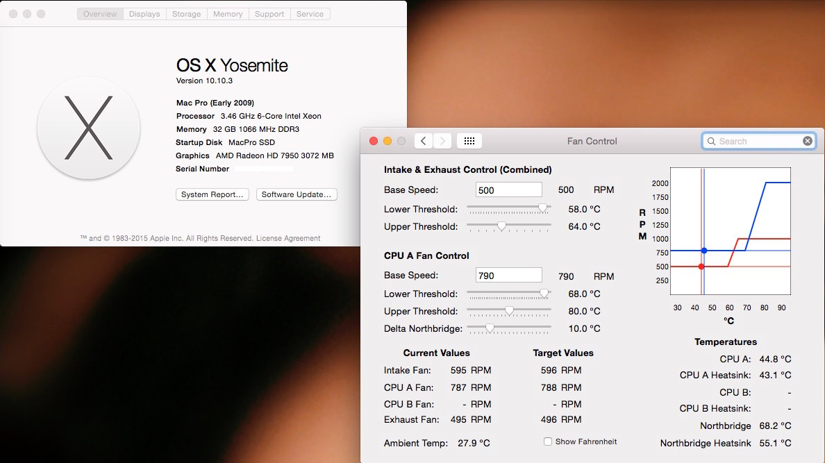

Someone in the Mac Pro forum made the Fan Control Mac Pro version works in Yosemite.
It's possible to modify the code and make it also works in a mini. Technically, I can make one with the following info.
1) How many fans in the mini.
2) The min and max speed of the fans.
3) The ident of the CPU (e.g. CPU "A", or CPU "0")
And I can tailor made the Lower Threshold and Upper Threshold range for you as well. However, I didn't own a mini, so can't test it. If you really want to try, you may give me the required info, be my beta tester, and we try to work it out together.

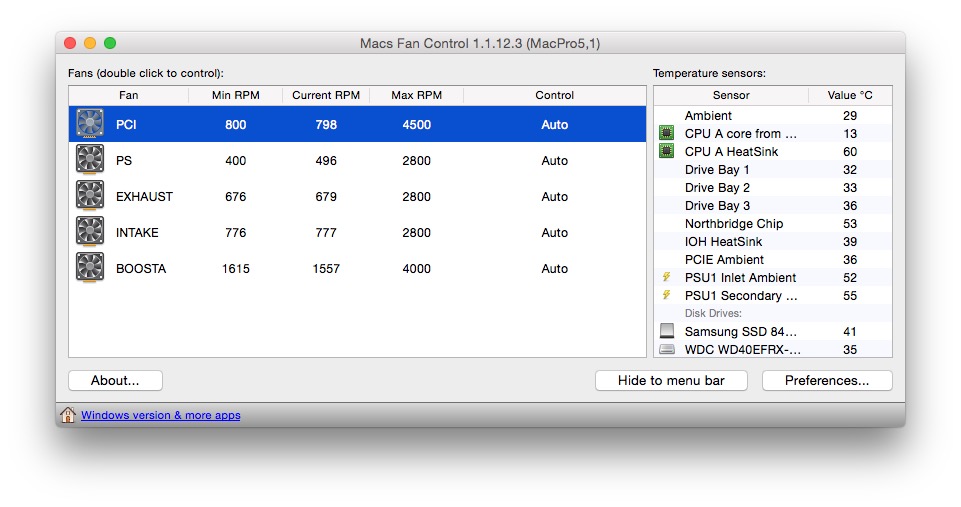

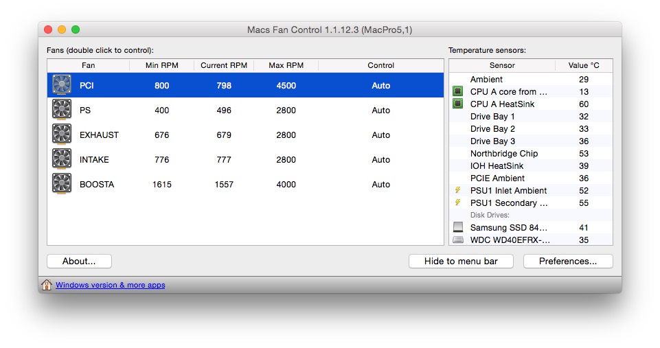

Can you post the screen capture of your Mac Fan control to here please?
Like this one.
Anyway, I've already PM you the source code of the Fan Control for Macmini5,2 version 2.0b7. The apps are also included, please check your inbox.
