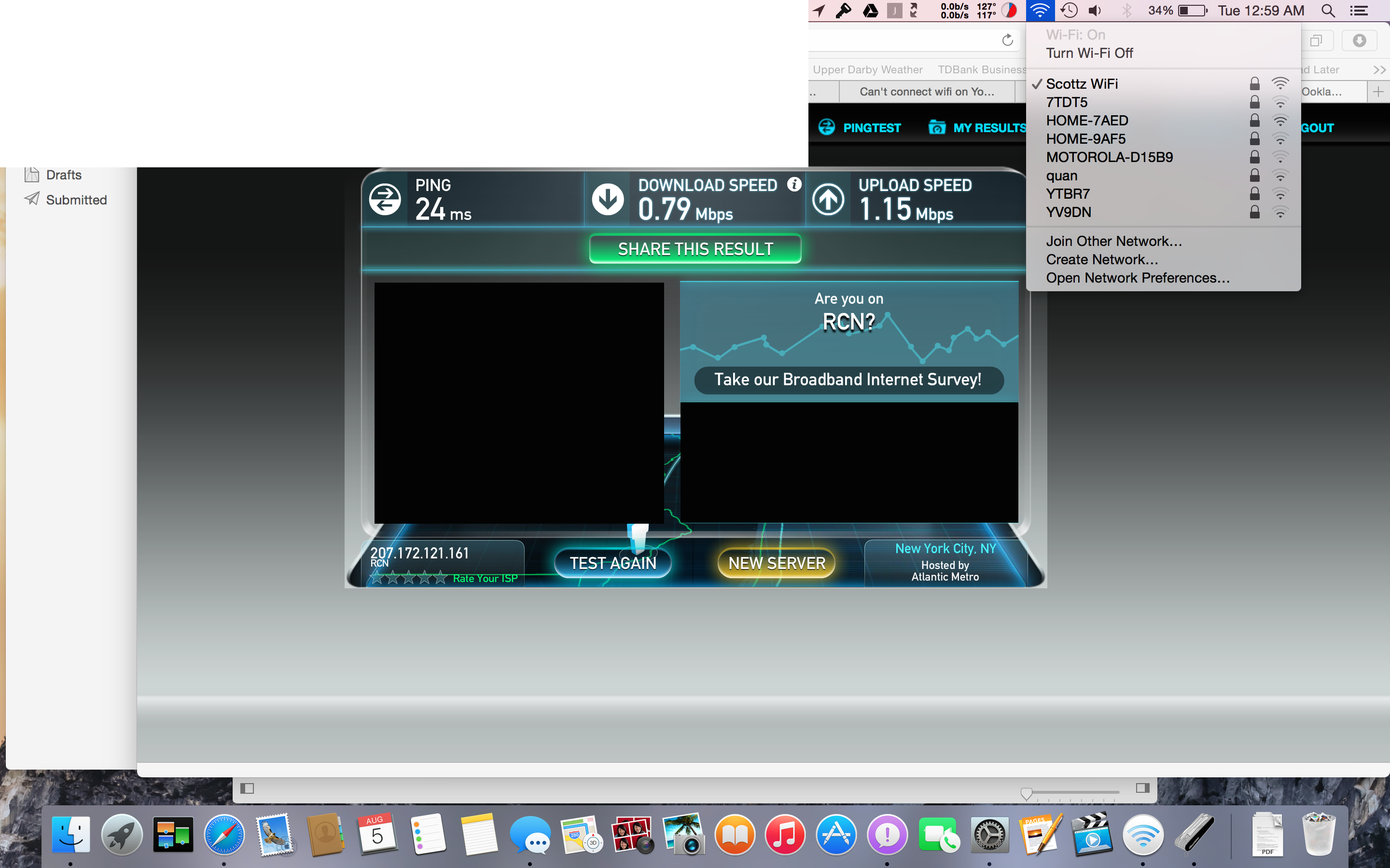

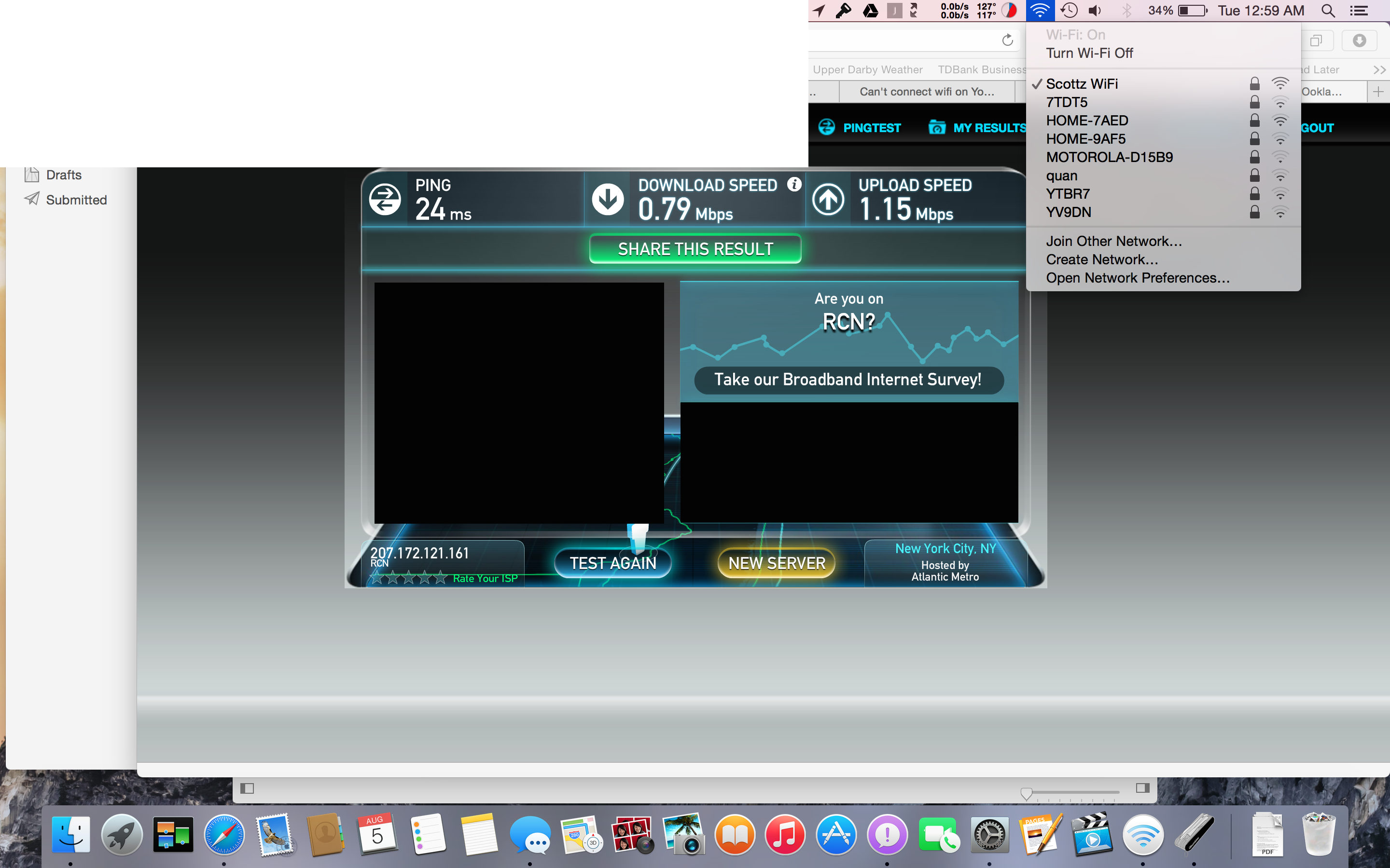

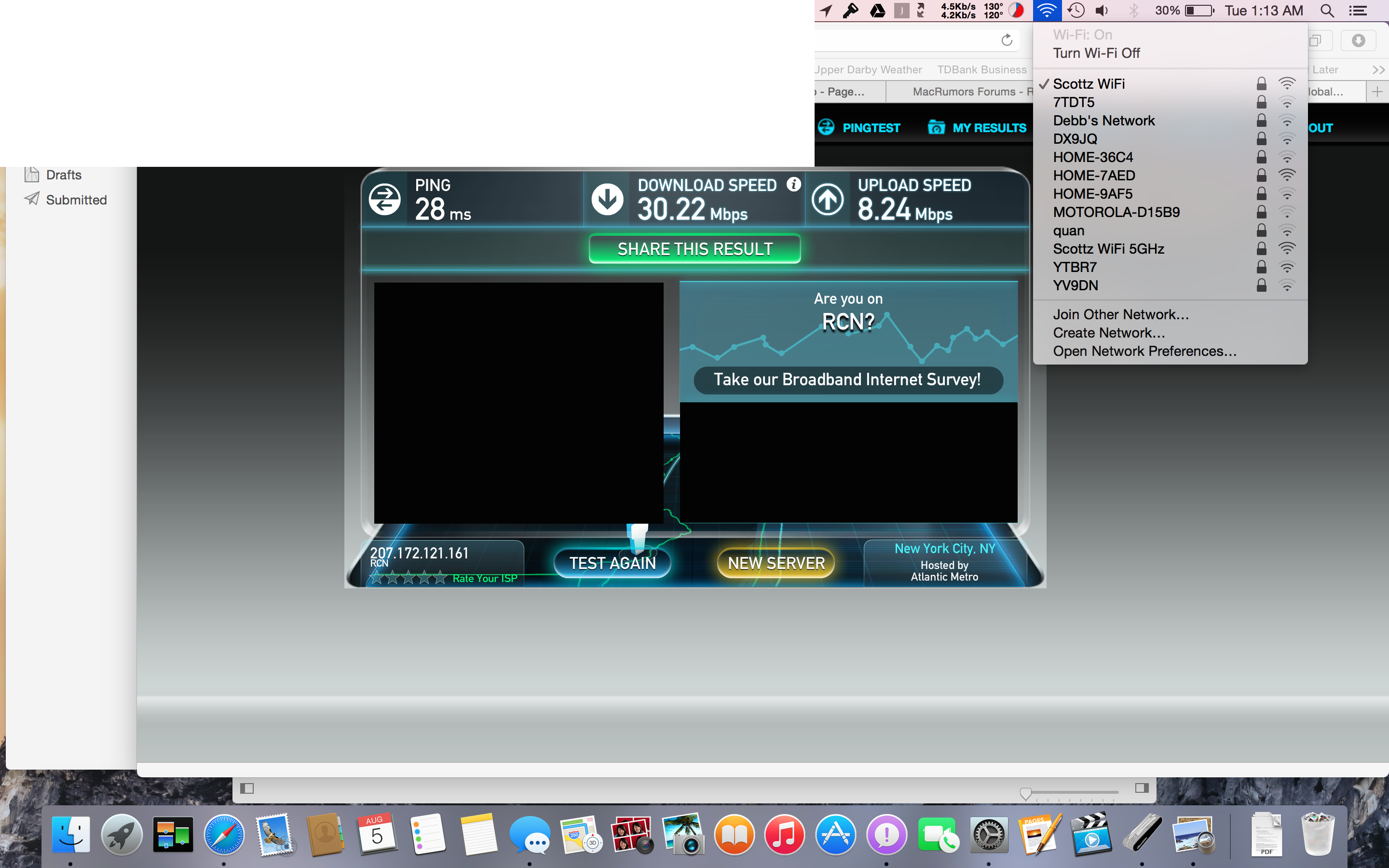

I don't know if I have the same problem but I also have speed issues on Yosemite. I have been trying to pinpoint the issue and may have figured out the cause of this. I have an Airport Extreme connected to my modem (1st floor) with another older generation Extreme (2nd floor) extending the network. In both speed tests, I'm 3 feet away from the second router.
Here's two photos. First is slow and second is fast. See the difference?
Both tests were using the same network. In the first speed test, I turned off the 5GHz network. Then I re-enabled 5GHz network on both routers without joining them and did another speed test.
Strange isn't it? 🙄
