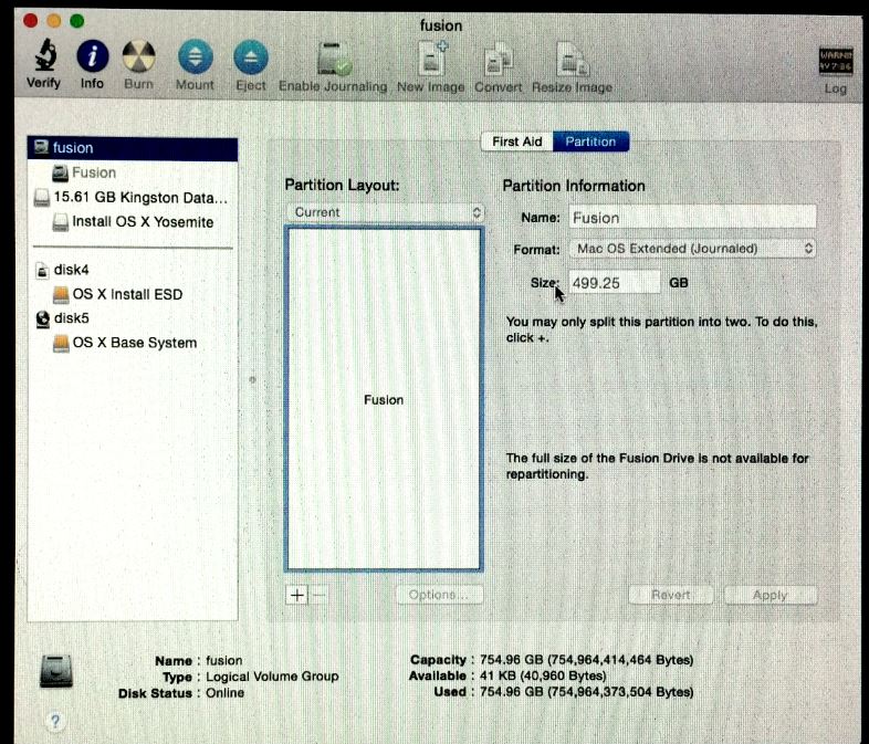

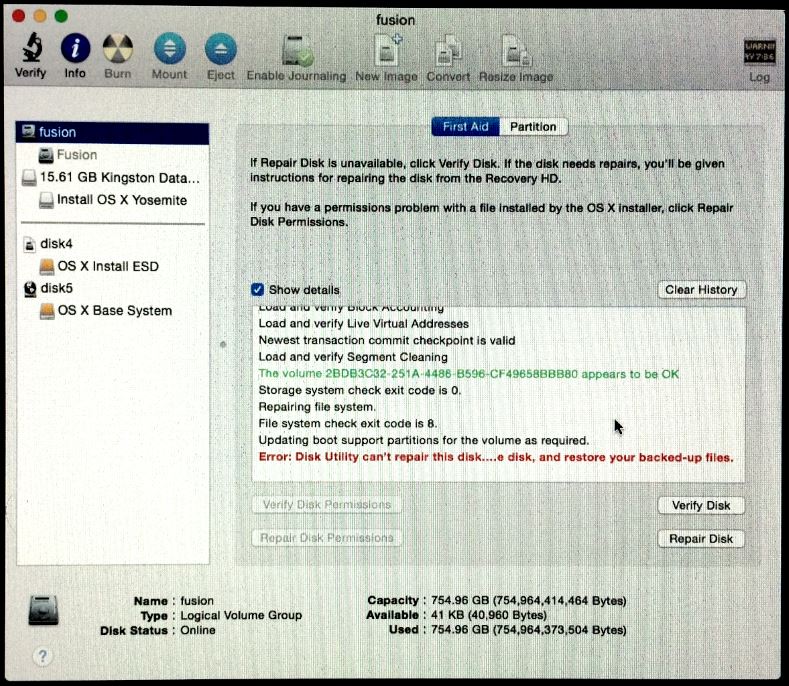

First attached crappy screenshot shows the log of when I tried to "repair disk".
Second attached crappy screenshot shows what disk utility tells me when I try to partition the drive.
I can't make sense of all the conflicting messages. It knows it's a fusion drive, knows it's 750 GB, but will only let me have a 500 GB partition, and won't let me reformat. At one point in the repair disk log (not shown in screenshot) it said "can't repair volume while it's in use", but I'm booted off a different drive, so how is it in use.
Can anyone give me some pointers how to get this working again, and maybe some insight as to why it got screwed up this way in the first place?
