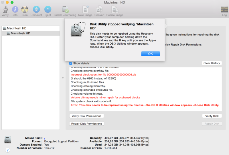

Hi all, please move this to the right forum if I have misplaced it.
I'm a long time lurker and I usually can solve my problems by reading other people's topics. But this time I can't find anything on the issue that I've encountered.
I'm doing a disk repair and it tells me to reboot into recovery mode and use disk utility in there to fix the problem.
The problem is, it tells me in there that everything is fine. However, when I do a disk utility in Yosemite again, I get the same error over and over again and it tells me to reboot into recovery where I again cannot fix the problem as it tells me everything is fine...

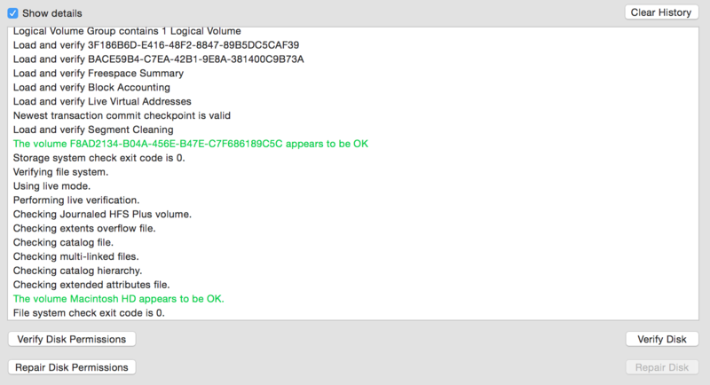

In normal usermode in Yosemite:

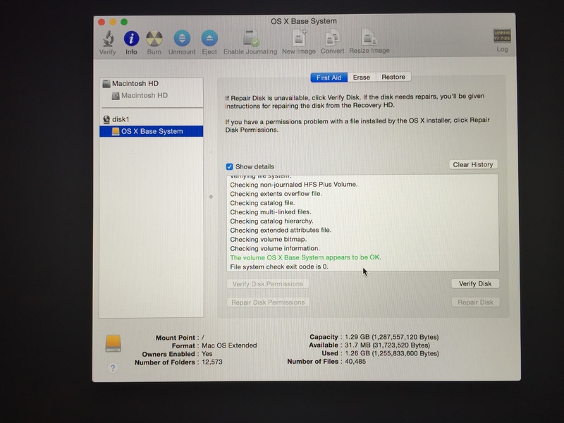

In recovery mode:
I also don't understand why there is a partition inside recovery mode. I didn't partition the drive at all.
I disk repaired Macintosh HD and the Base one and both give me no errors in recovery mode.

btw, you seem to be checking macOSX in that screen shot, not the whole hard drive

2) Correct, I did check that one, but I also checked Macintosh HD and both are giving me no errors = fine.

OS X base system is the hidden portion for recovery. You need to verify disk for macintosh HD that is greyed out.

There's no reason to revert to Mavericks. Elsewhere in that thread I linked to are two key Terminal commands - look at my post #36, and a few others following shortly thereafter that describe "what to do".
There's postulation that this conversion to Core Storage is related to Filevault. I used those two Core Storage commands on my two rMBPs and restarted, and all is back to how we've expected - I've had no issues whatsoever since reverting to non-Core Storage volumes. The only key result to look for after executing that first corestorage (or cs) Terminal command is whether or not the volume is "revertible" - if it is, the second command is non-destructive, and it's worked perfectly dozens of times with no loss of data. On the volume you have, the reversion takes maybe 10 seconds plus the time of a restart. Good luck...
Live verification of HFS Plus file systems: limitations of Disk Utility with fsck_hfs
If the block count error detailed in the first screenshot is detected only when verification is live – when the file system is locked down – then that error detection may be negligible.

I actually just tried it as Weaselboy suggested and then I just ran disk utility in Yosemite and the error is gone....
I admit, I don't understand why, but it's gone. It didn't work for me via Recovery Disk Utility, but this single user mode and the command did solve it.....
