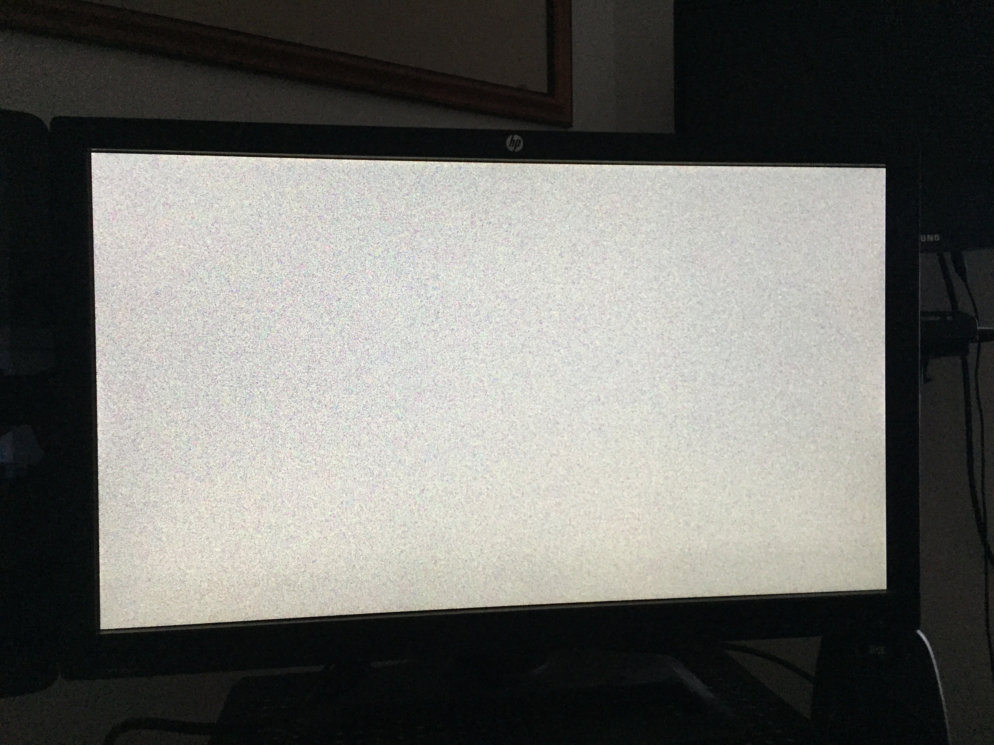

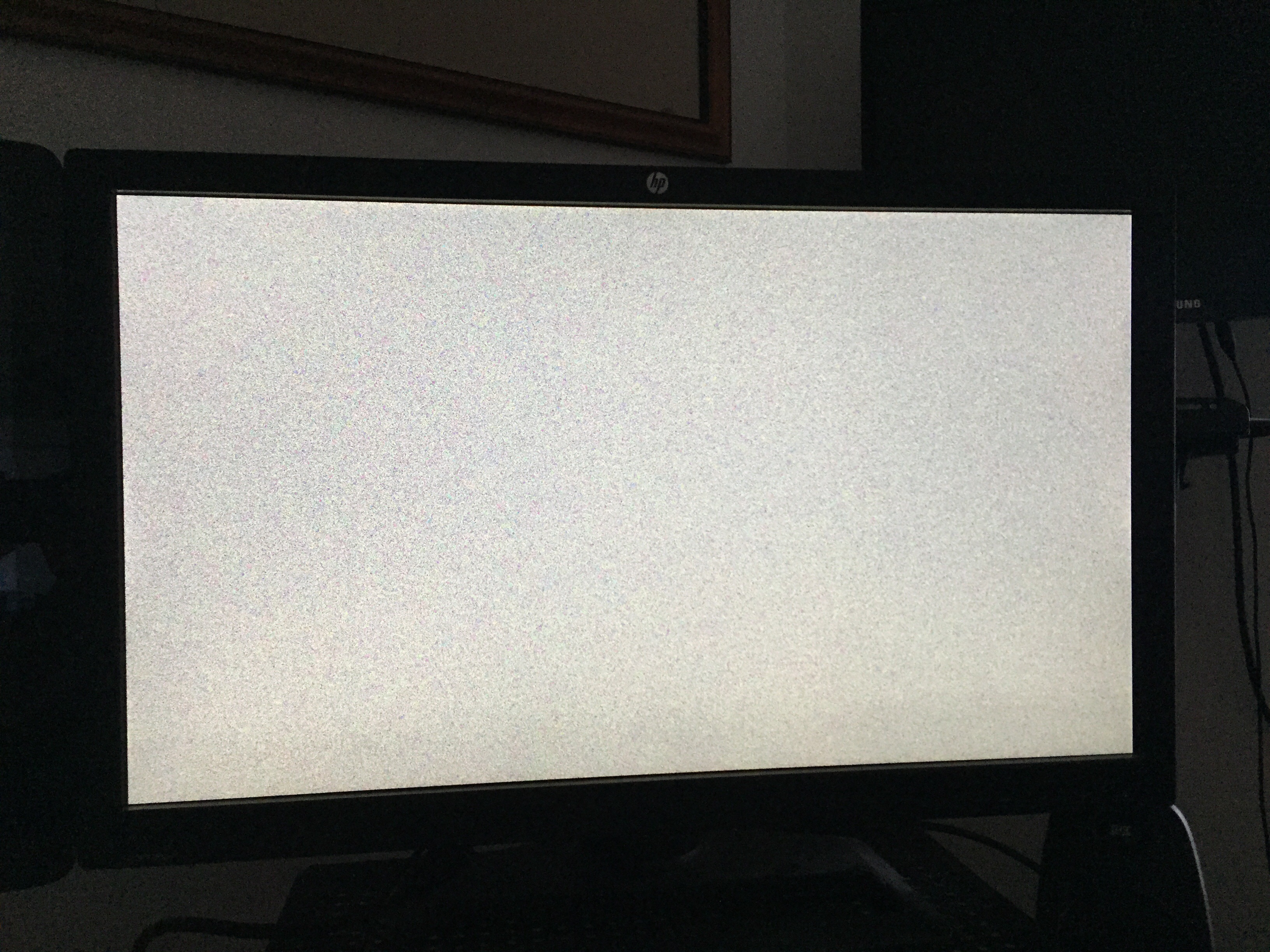

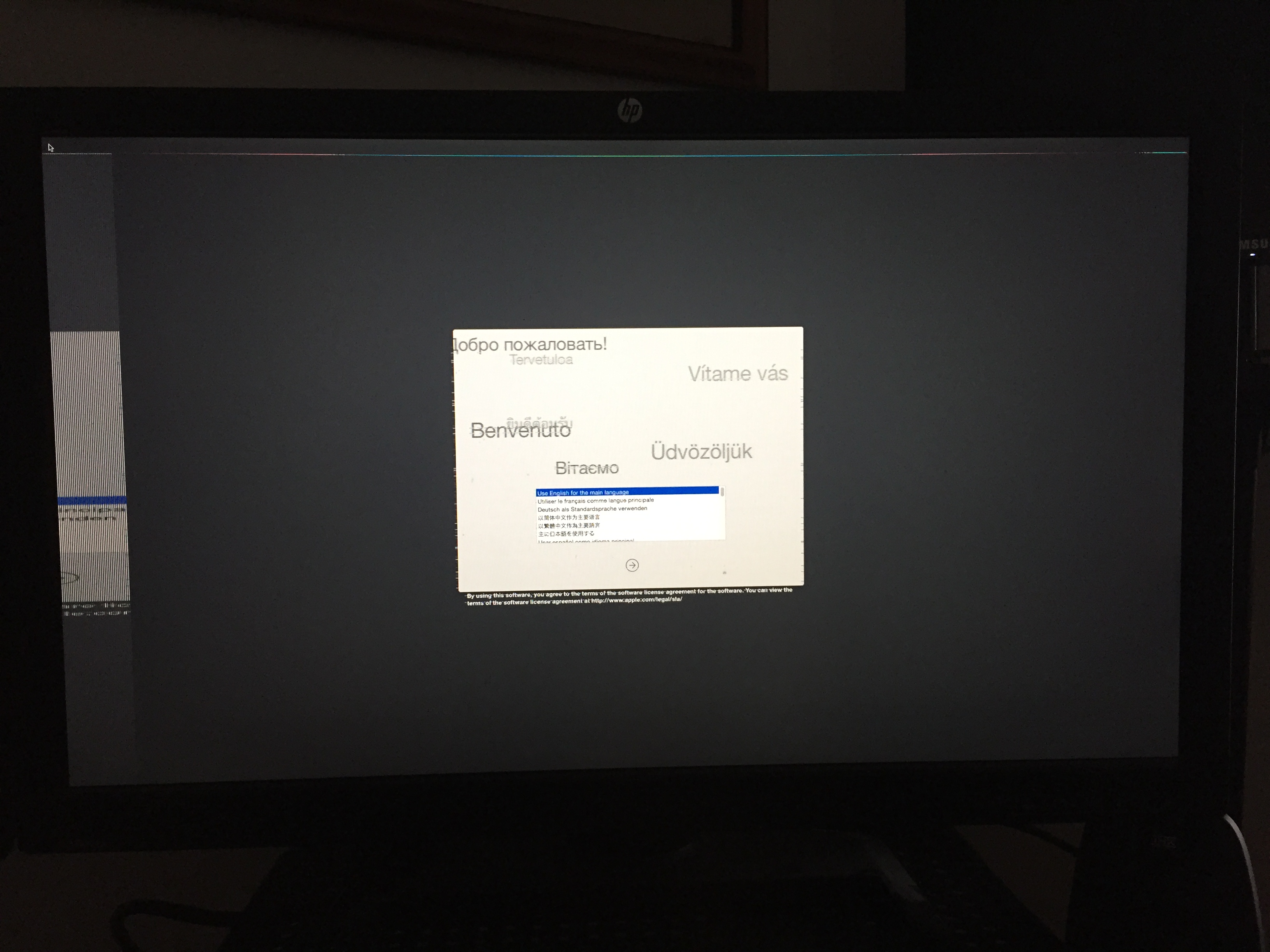

I'm updating this thread to provide 2 more kernel panic logs and images.
I attempted with the GTX 570 installed to boot to the USB stick to do a fresh Yosemite install. I received these graphical issues in the image.
I then took out the 570 and trying a GT120 with a unflashed 750Ti and booting to do a fresh install of Yosemite. This system wasn't happy with this. Maybe because I needed to do a NVRAM reset? I did that and still had issues. I took the 750Ti out and now only the GT120 is in the system.
Going to try a reinstall of Yosemite with just the GT120 and then with nvidia drivers and the 750Ti to try to rule out any other system issues.
EDIT: Fresh install running with temporary 750Ti seems to have fixed all instability issues thus far. Run and completed numerous benchmarks, no quicklookUI issues. Seems to confirm something happened to the MVC GTX570 that had up to this point been rock solid.
Any help would be appreciated.

… 2 more kernel panic logs …

Thanks for the help. I can all but confirm it was the card. I had issues going back to Mavericks as well.
Tonight I just put in a new GTX 970 with the fresh install of Yosemite and so far I've seen no glitches, panics or anything. Every test and place it crashed before is working with flying colors.
Can't quite get my head around how the card was fine and then going to Yosemite seemed to break it. Literally nothing else changed or happened between the period it was working in Mavericks to pretty much instantly crashing after installing Yosemite. Odd.

… OS X randomly crashes after waking from sleep, fully booting etc. …
A reset of the SMC would do no harm.
… Clean install of Mavericks …
How clean was the system when you first encountered a problem after that installation?
Did you migrate (or otherwise put in place) any apps, user data or other data?
Sure lets see.
It is a MacVidCards flashed GTX 570 that I bought from them several years back. It's served me well and can say nothing but positive things about MVC. I don't know specifically what's flashed on the card but had no issues with it til now.
I did do an upgrade from Mavericks to Yosemite, not clean so all user data transferred over the first time. Since then based on suggestions I've created clean new users in Yosemite, rolled back to a clean install of Mavericks running nothing else with it, run a clean install of Yosemite...
With the card in the system in all those situations the system crashes. Things that seem to reference OpenGL whether that's quickview in Yosemite, safaris home screen when you select a recent site and it does a card flip transform, running OpenGL benchmarks and also in other seeming random situations all end with a crash.
This is with or without other cards like the GT120 in the system.
