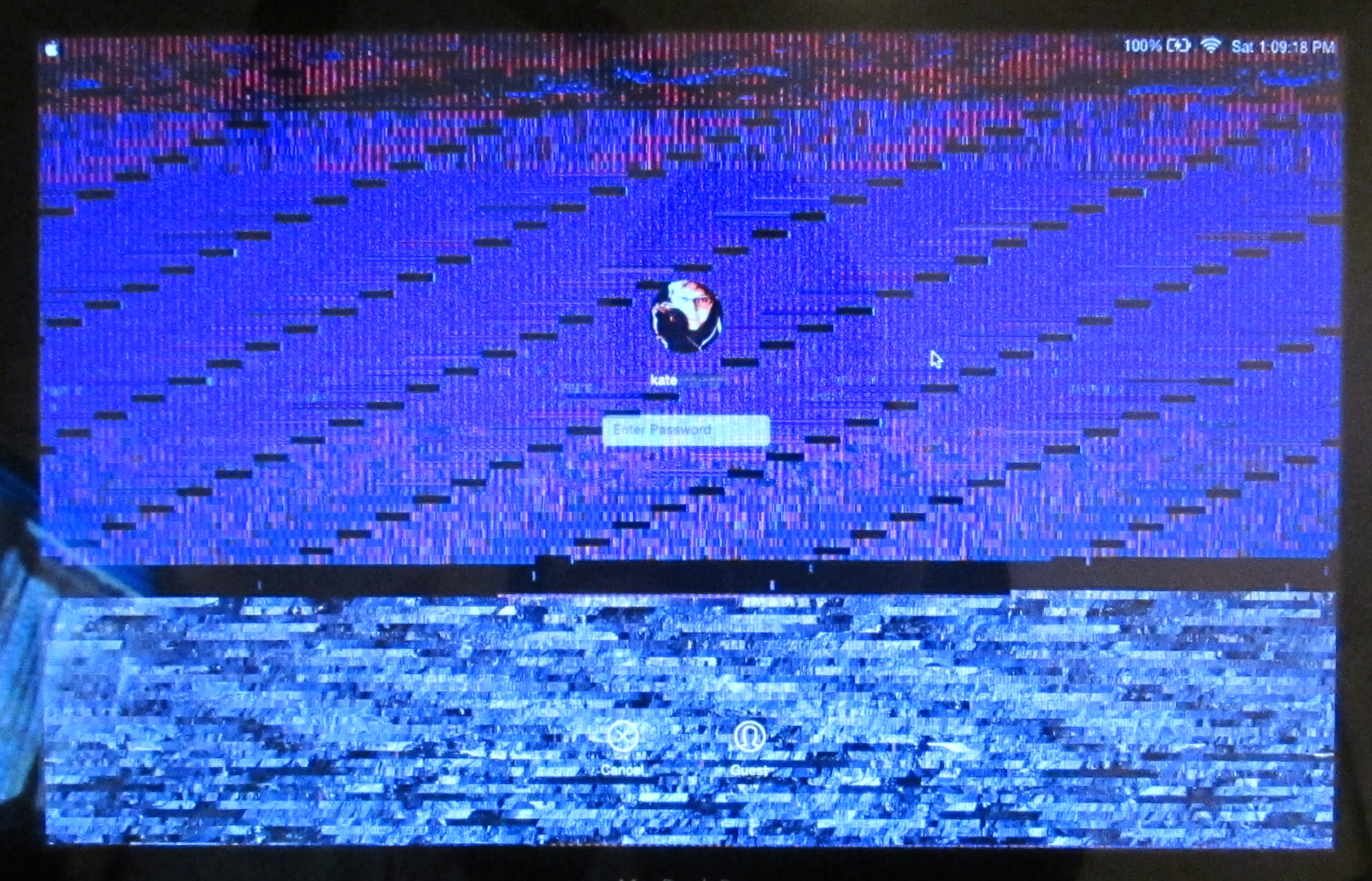

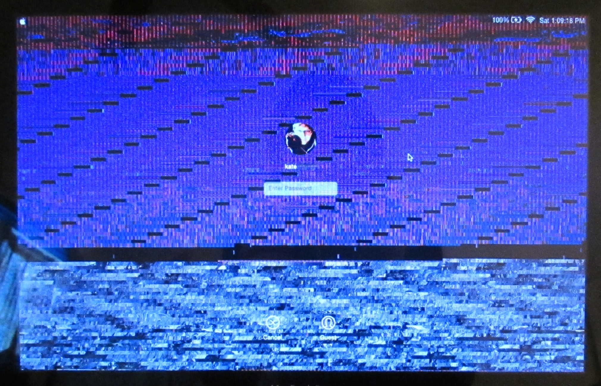

I get a cool-looking glitchy screen after the screen goes to sleep, and then I wake it up again. Once I enter my password, it works fine, so it doesn't affect the functionality. Image attached.
