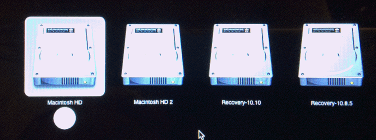

Here are before and after photos of my startup manager illustrating the problem caused on one of my computers by the yosemite recovery update.
The first one is as it should be before installing the update.
Macintosh HD is mountain lion and Macintosh HD 2 is yosemite and the two recovery partitions are also showing. All 4 boot up properly.
Then after installing yosemite recovery update 1.0, the Recovery-10.10 partition has been renamed as Macintosh HD 2, i.e., the same name as my yosemite partition. Starting up from this just starts up yosemite, not the yosemite recovery partition. Recovery-10.10 is gone altogether from the startup manager.
Using the workaround I posted above in the first post in this thread will restore it back to normal.
A bug report has been sent to apple for this second issue.
