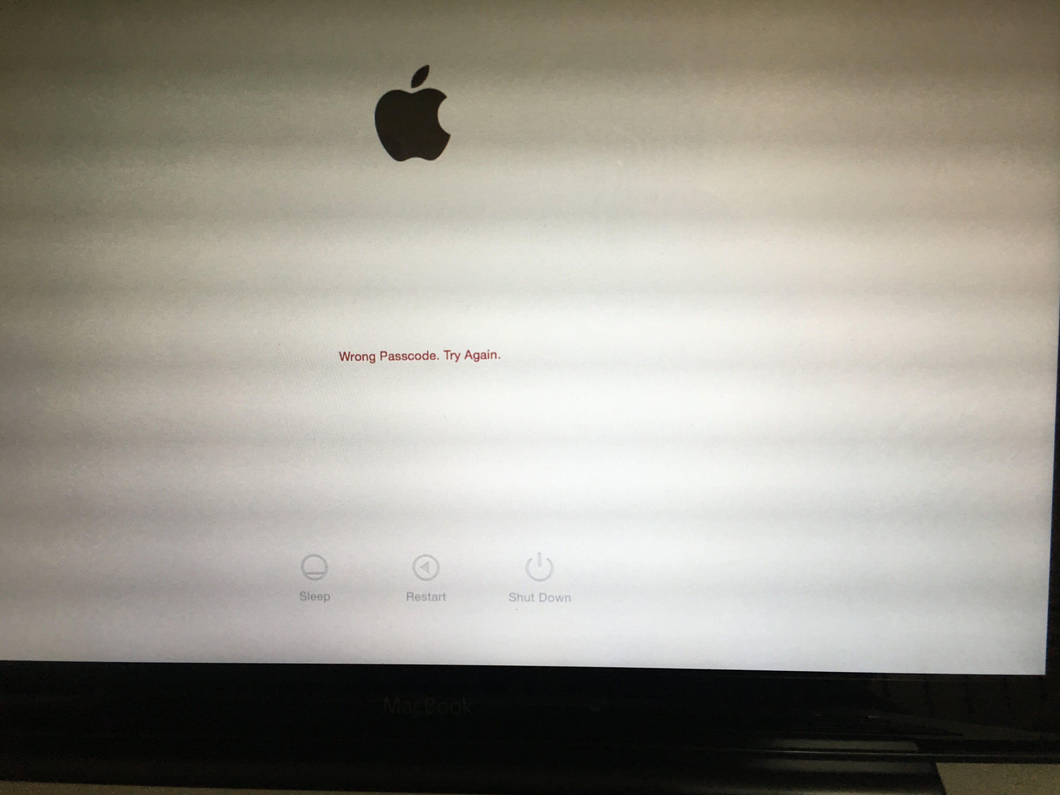

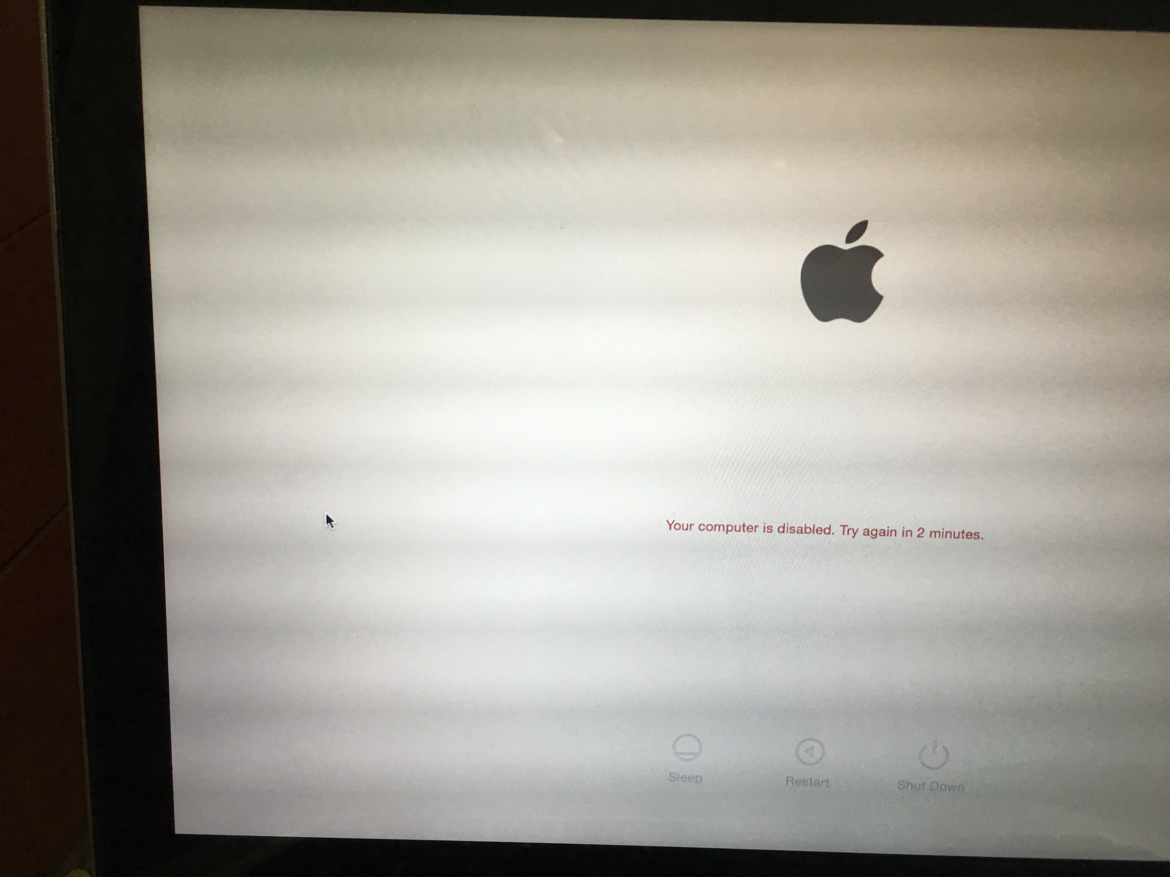

Ive uploaded two pics; one is with a couple of minutes left, and the other is what shows up directly after the timer done. There is no place to put the six digit password, which does show up before I try to boot from the USB.
OK....so after letting the computer sit for about 10 minutes, with the "Wrong Password, Try Again" message, the boxes showed up for me to enter the password. It restarted, and all seems to be OK now. Is there something I need to enable/disable so I dont have this problem in the future?

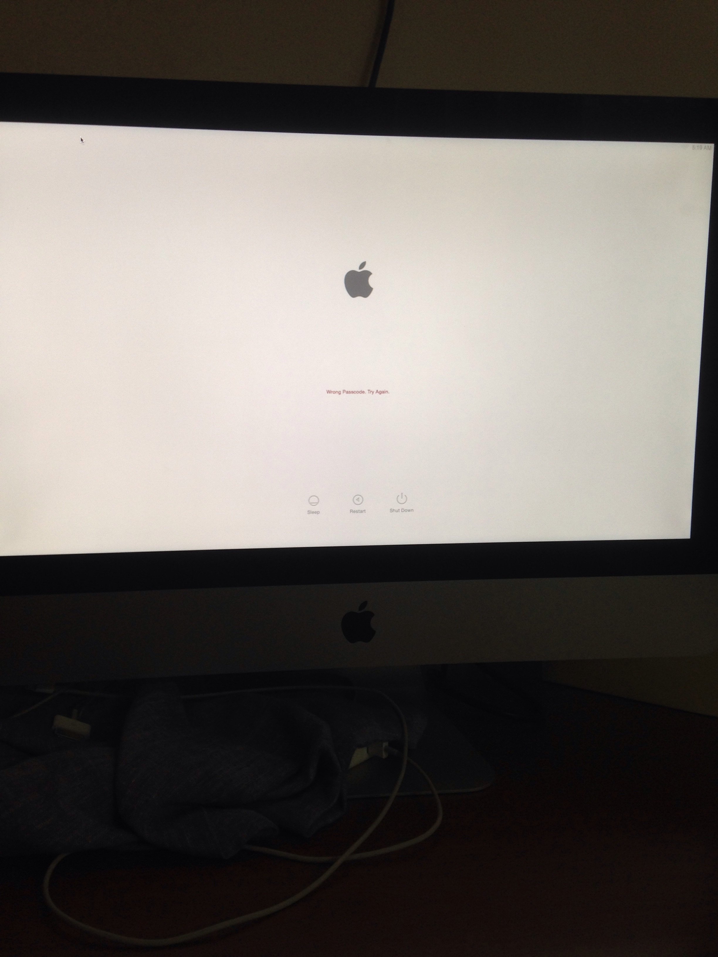

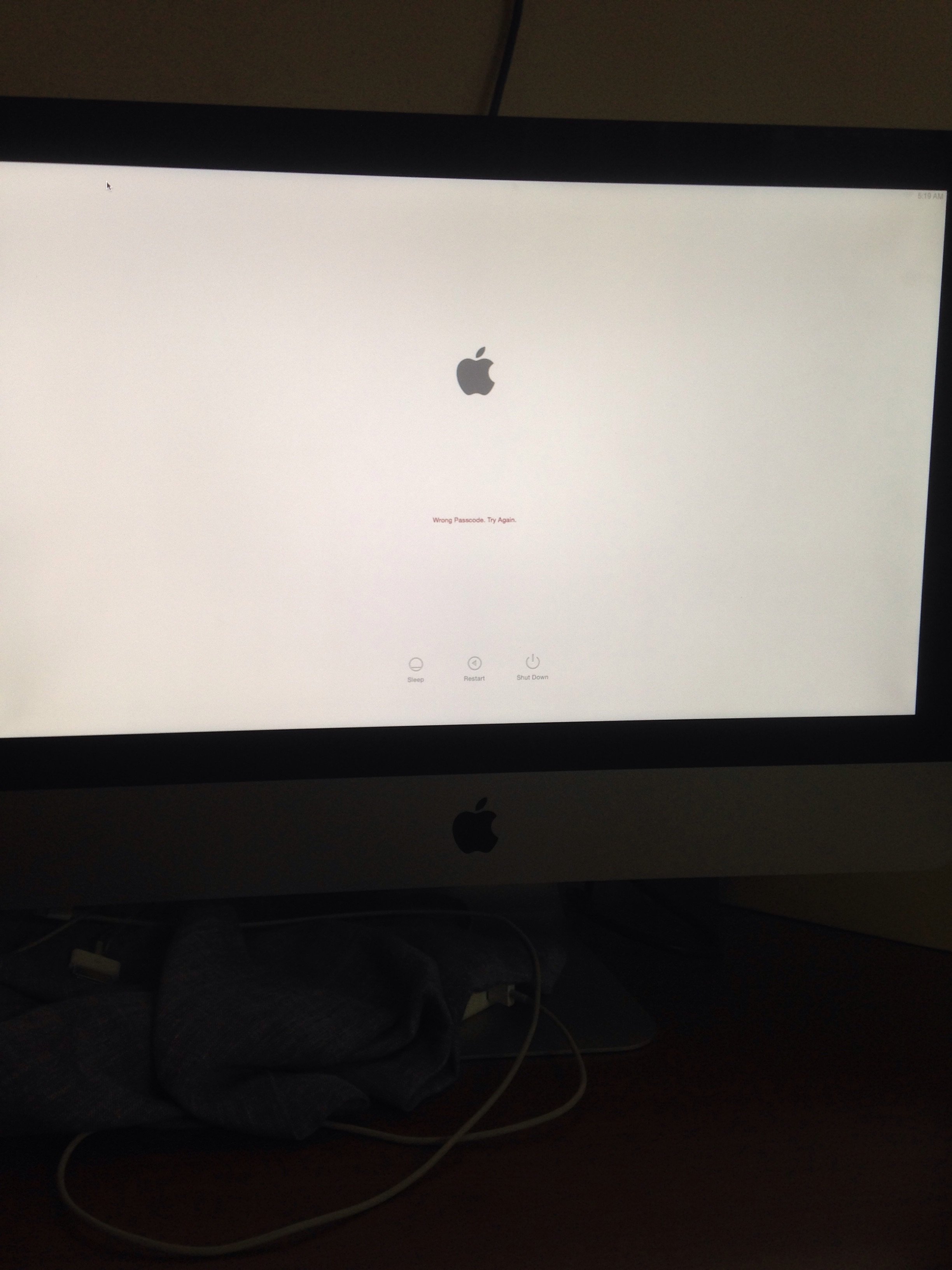

i have waited around 30 min but it just show "wrong passcode . Try again . "
Right. If all that you have is a firmware password (which is what that padlock screen needs), Apple is the only place you can go to attempt a fix by clearing a firmware password. There is nothing that the owner can do, except provide proof of ownership when taking it to Apple.
There ARE third party businesses that "claim" to remove firmware passwords, but you would have to hunt one down for yourself.
Hopefully, your user will be able get the firmware password reset, and that's the only block to accessing the drive. If the "hacker" also locked access to the storage drive by encrypting it, that will be more challenging, and probably not recoverable (unless, of course, the user decides to pay 🙁 )
