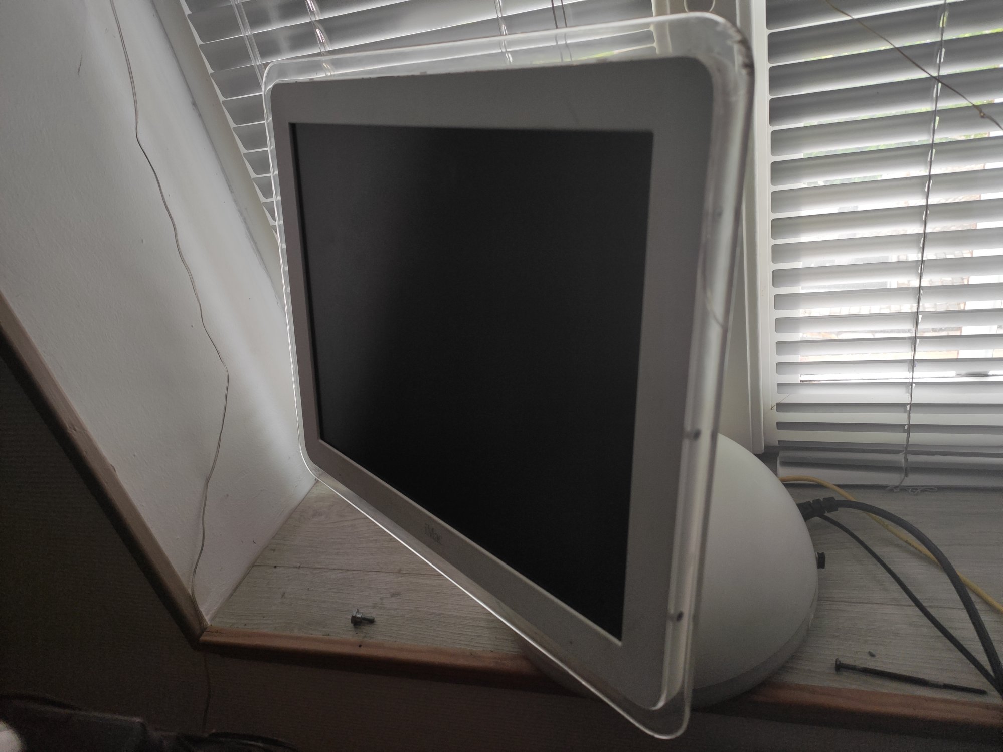

Anyways I'll add my own: my ol' iMac G4.
Currently, I don't know why but it's starting to act iffy, sometimes it refuses to power on and emits a worrysome buzzing noise (think the 60Hz mains hum on steroids), other times it seem to be rock solid before hardlocking solid.
I tore it apart yesterday (and forgot to put thermal compound *facepalm*), couldn't find anything wrong, no swollen caps or leaky PRAM battery. (note to self: buy thermal paste and don't forget how difficult a iMac is to tear down!)
I wouldn't consider it as "dying" but rather "temperamental", on the other hand my '99 G3 is rock-solid, nothing to say about it.
Also quite bizarrely, my G4 has a later logic board in it, despite being a early 15" unit, when I looked around on iFixit on teardown guides, I could see that the unit they tore down had a different LB (the IDE connectors were laid out differently), on my unit the IDE ports are side by side. 15913581521004352951351004829764.jpg

@Alexis Trinquet Before I tore it apart and put the mod project in hiatus, my 800mhz 17" iMac G4 behaved the same way. I ended up replacing the PRAM battery, and wouldn't you know it, it boot up every time it was turned on afterwards.
Issue solved, just like that.
I would also test the battery's voltage with a multimeter. Even if it seems good, I would replace it anyway to see how the iMac responds.
Reactions: AphoticD
I don't have a PRAM battery on hand unfortunately, but it's still holding up a good charge (about 3.4v, still surprising given how aged this battery is).
I only had left it out for 30 minutes then put it back, maybe that fixed it? I'll probably never know.
My iMac G3 on the other hand, even without a PRAM battery it doesn't act funny at all, save for the clock loosing time (but that's expected behavior).
