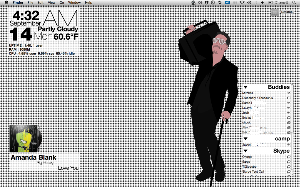

also here's my desktop when the weather condition is working right:

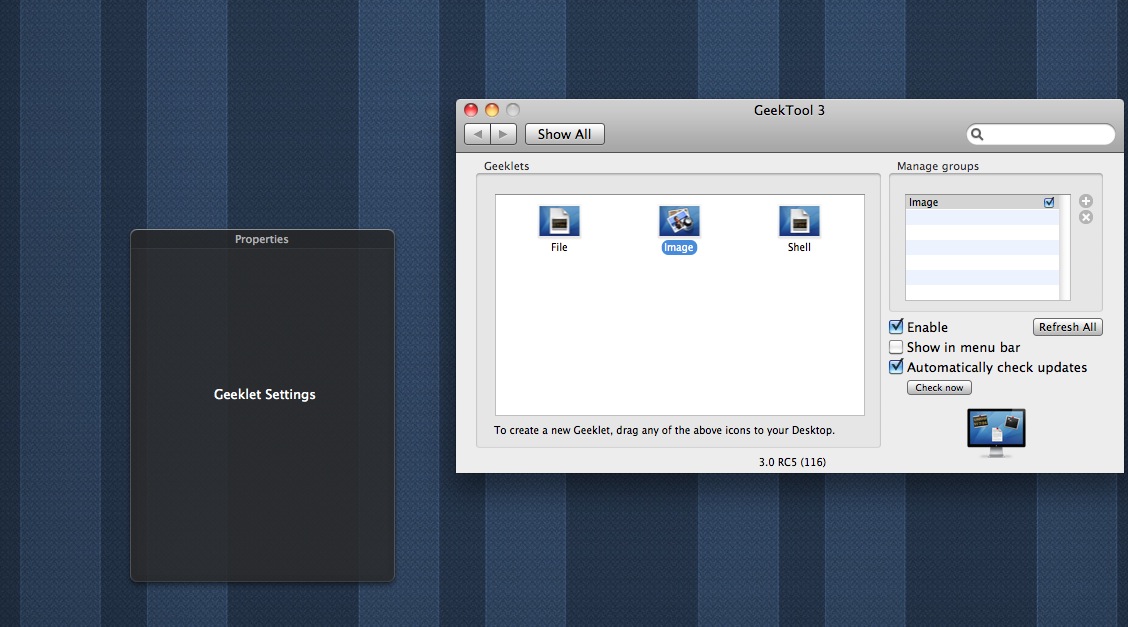

n00b question. I had Geektool 2 with Leopard, but I've gone straight to Geektool 3 for my Snow Leopard installation. When I drag an icon to my desktop, I can't figure out how to input any of the scripts into it. I'm sure it's easy and that I'm missing something, but I'm at a complete loss abt what to do.
I end up with the Geektool pref pane, and what looks like a HUD display with "Geeklet Settings" in the middle. Also, I'm not having much luck looking for a tutorial for GT 3, so any help with that would be great.

Sorry to be so blatant, but I'm hoping someone can help me out with this. Thanks!
In the center of the HUD window, after you've dragged your shell "geeklet" to wherever you want it on the screen, is the "Command" text box. Paste your code in there, and wait a second for it to refresh.

Hi Scotty96LSC,
Just saw your desktop in the Sept desktop thread. Any chance you could post your scripts that you are using? They look great, and the desktop pic is awesome too.
jW
Thanks. Still having no luck. Here's a grab of what I'm looking at; I can't paste anything into those windows, and I know it's a shell command that I've pulled out there. Again, Geektool 2 was no problem for me, but this one on SL is frustrating me. I know it'll be fine once I figure it out, but for now it's a pain.
I don't see where you've pulled anything out. It's behaving as if you haven't pulled out a shell script at all. Make sure you're pulling it to the desktop (and annoyingly, not onto any window of any type).

Hi Scotty96LSC,
Thanks.
Click and HOLD on SHELL and drag it to the desktop.
