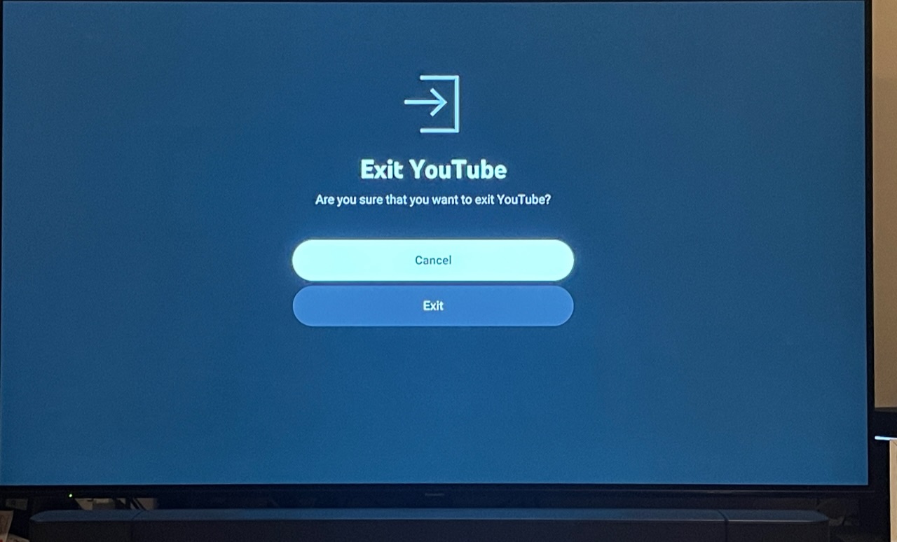

The YouTube app on Apple TV 4K is a clown car joke
It flashes to black every ad, & start of every video. The typical video has two 5 second ads at the start. Thats *5* black out flashes every video
It also asks if you want to exit the App for some insane reason when you want to leave it & turns off the tv!!
I have a quality HDMI cable connected to a 2 year old Sony OLED screen, with an AppleTV 4K
Is anyone else experiencing this?

it also asks if you want to exit the App for some insane reason when you want to leave it
Not sure how, or why, you are leaving the app. I never leave it. I stop whatever video is playing so I can return to it then hit the TV button which is configured to go to the Apple TV home page. Run another app, then repeat the process to re-select the Youtube app where I can continue with whatever I was watching.
