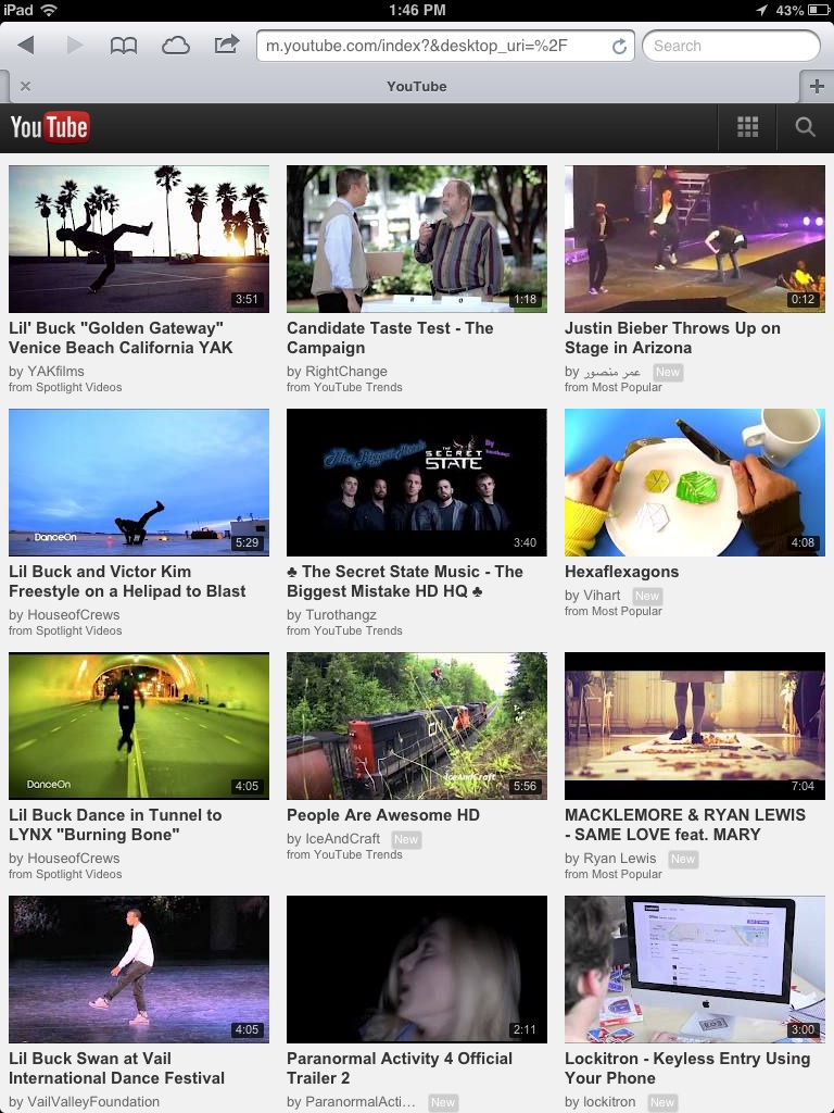

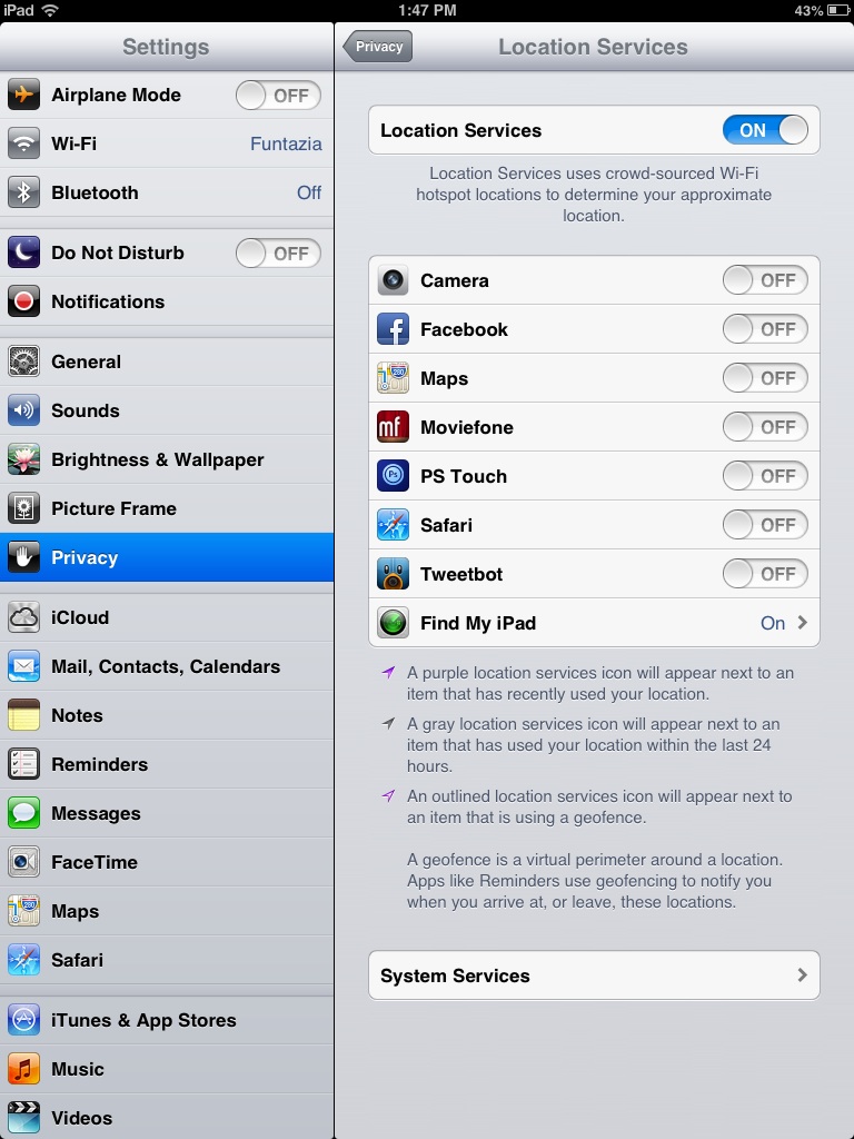

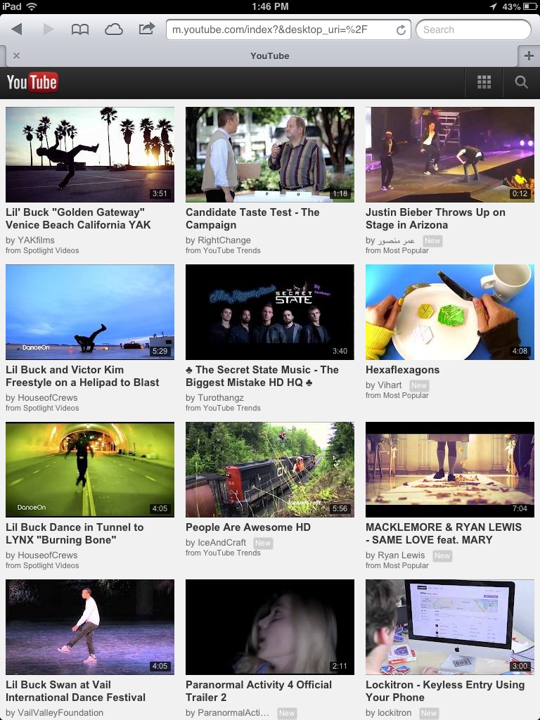

I noticed today that even though I have Safari Location Services turned OFF on my iPad 2, when I go to the YouTube website the Location Services arrow shows up on the top right next to the battery meter. What gives?

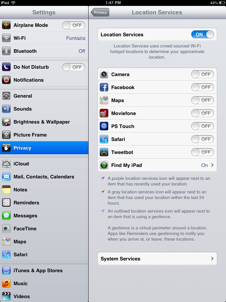

Location Services for Safari are OFF

Do you see a gray or violet arrow under Privacy/Location Services after quitting Safari? If not, also check under System Services at the very bottom.
No arrows of any color in either place after quitting Safari.

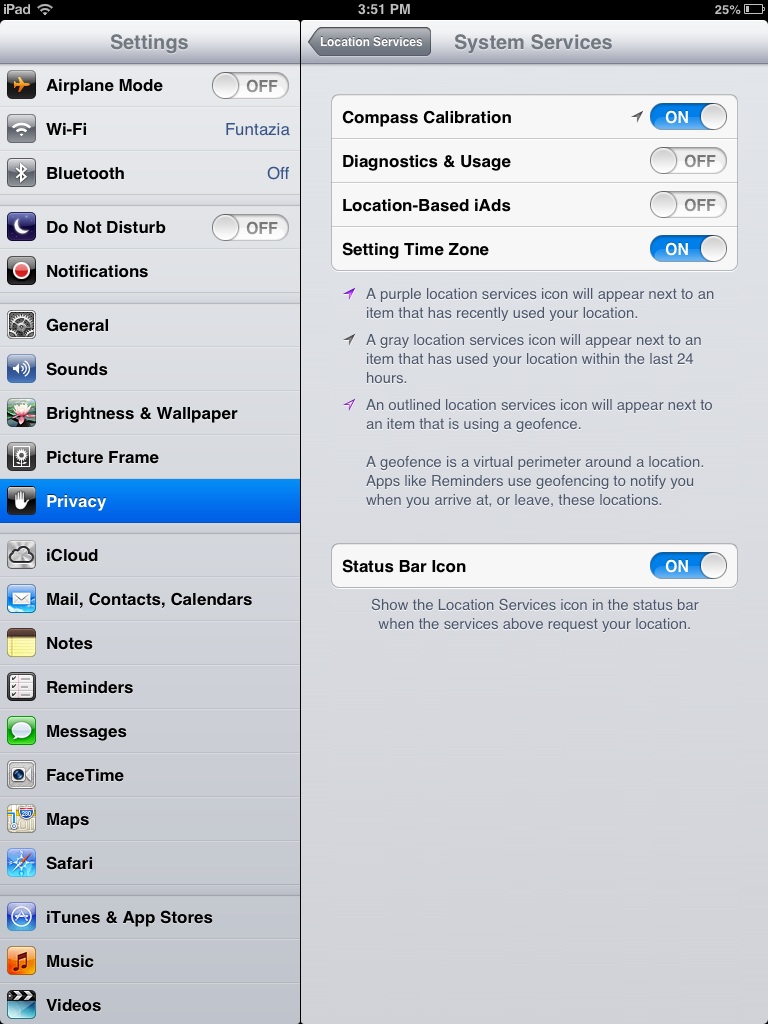

System services. It's iAd location based services

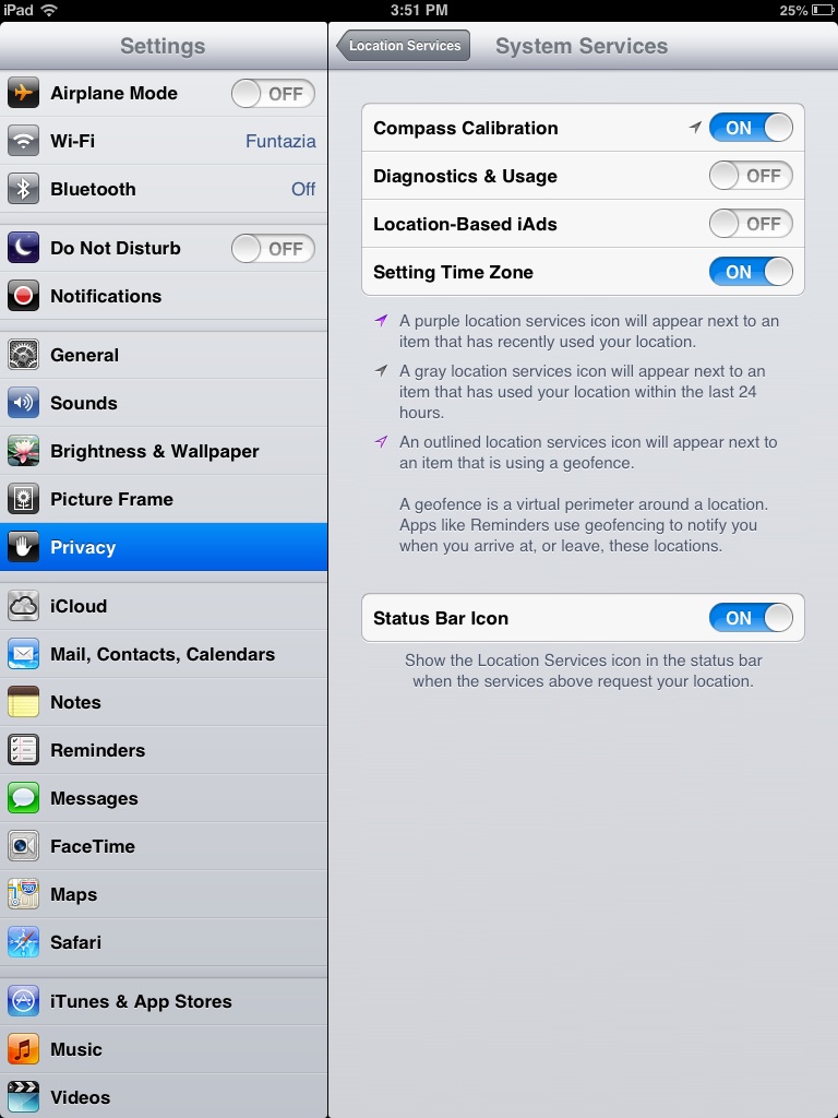

I have that turned off and have attached a picture.
Turned off Compass Calibration
OK so I turned off Compass Calibration and went to the YouTube site and the arrow didn't show up next to the battery meter.
