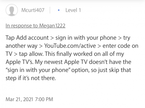

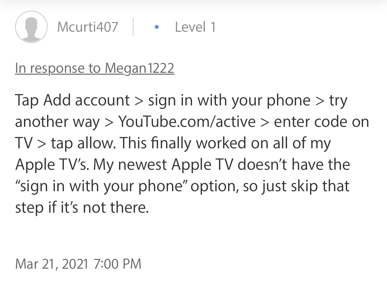

All: this works; from the Apple Forums:
I couldn't back-trace exactly but try to sign in with 'guest' on the tv...don't use 'phone' when offered...then go to the site that it offers per above and enter the code thats on your tv to sign in 'your tv' via you Mac .....it will then have your tv YT up and running. Can then go , via Mac , to Google security page and disconnect phone/iPad or Mac or anything else you don't want connected. Sorry if somewhat confusing as I followed what Mcurti407 has above but then followed what was on my TV....the site he mentions 'Youtube.com/active' is incorrect but your tv will give you the correct address.
