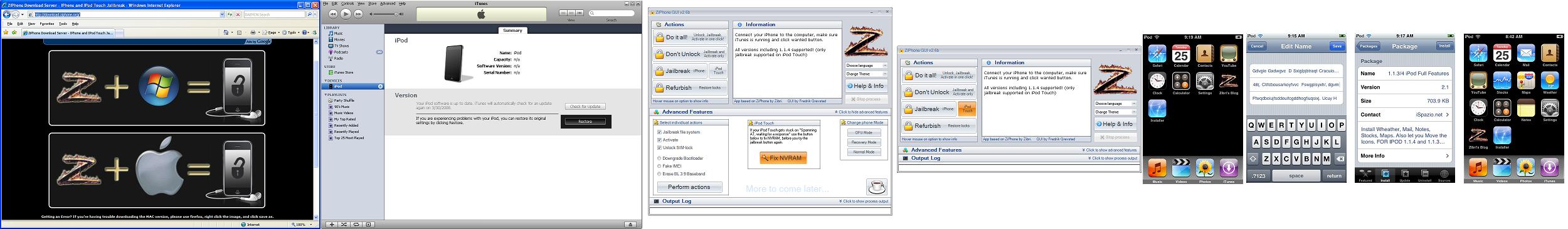

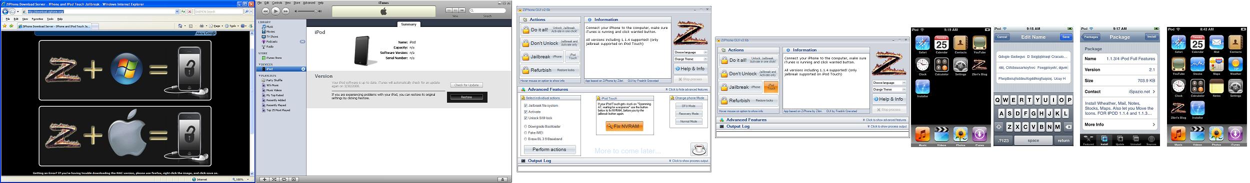

I have 16GB, jailbroken with ZiPhone at 1.1.4... Heres how i did it:
1.) You NEED to have ZiPhone 2.6b, if you have an earlier version, please go to http://download.ZiPhone.org/ and download it.
2.) Plug your iPod into the computer
3.) Hold the Sleep/Wake and Home buttons until the iPod disconnects from iTunes. Let go of the Sleep/Wake button and hold the home button until your iPod goes into recovery mode
4.) Restore your iPod to version 1.1.4
5.) Open ZiPhone
6.) Click on "Fix NVRAM"
7.) After it is done, click on the "iPod Touch" button next to the Jailbreak button
8.) Before you do ANYTHING, go into contacts
9.) Press the "+" button
10.) Then press the text field labled "First Last"
11.) Start spamming with the keyboard (DO NOT SKIP THIS STEP)
12.) After you have spammed random letters for about a minute or so, press "Cancel", press "Cancel" again, and then press the home button
--Doing steps 8-12 will save you from freezing up later--
13.) Go into Installer
14.) Add the source "http://repo.ispazio.net"
15.) Goto the catagory "iSpazio Unlock Tools" and install "1.1.3/4 iPod Full Features"
congratz, you now have jailbroken 1.1.4 iPod with $20 apps🙂
I attached some pictures if it helps (I am on windows)
(click on it to enlarge it, it is hard to see when it is that small)
