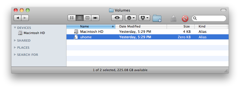

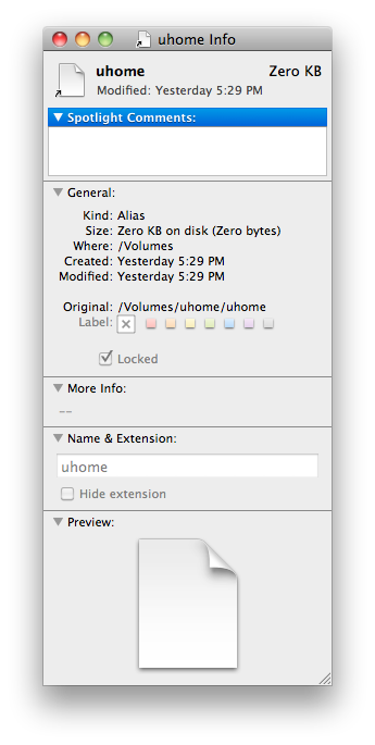

I'm not familiar with the -Orbitlake options, but Terminal doesn't show the file as being an alias, and its owner has changed to root after the last time I deleted it in single user mode:
Code:
$ ls -Orbitlake /Volumes
total 5
2601509 lrwxr-xr-x   1 root  admin  -         1 Jun 18 17:29 Macintosh HD -> /
      7 dr-xr-xr-x   2 root  wheel  -         1 Jun 18 17:29 uhome
      2 drwxrwxr-t  36 root  admin  -      1292 Jun 18 17:31 ..
  26277 drwxrwxrwt@  4 root  admin  hidden  136 Jun 19 15:59 .
 0: group:everyone deny add_file,add_subdirectory,directory_inherit,only_inherit
But Finder does (see screen shots).
Yeah, there are some sneaky filesystem tricks going on in /Volumes (by design). Finder always shows mount-points as aliases, whereas Terminal sees them as directories. The interesting bit here is also the inode number (7 in this case):
