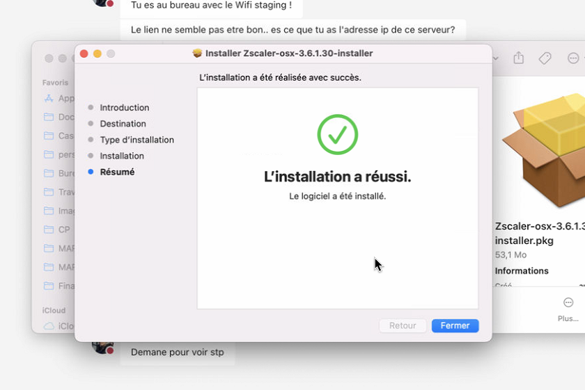

Thanks for your response, at the end of the installation it said that Zscaler is installed. but I can't find it... in the applications, the software is not there!
Did you search for it with Spotlight? Both /Applications and /Users/<username>/Applications are common installation paths for applications. But searching for it with Spotlight will find it regardless of where it installed to.
Yes sir I did a search with the spotlight, unfortunately no result!!

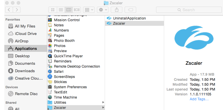

According to their docs it should create a folder in your applications directory as such

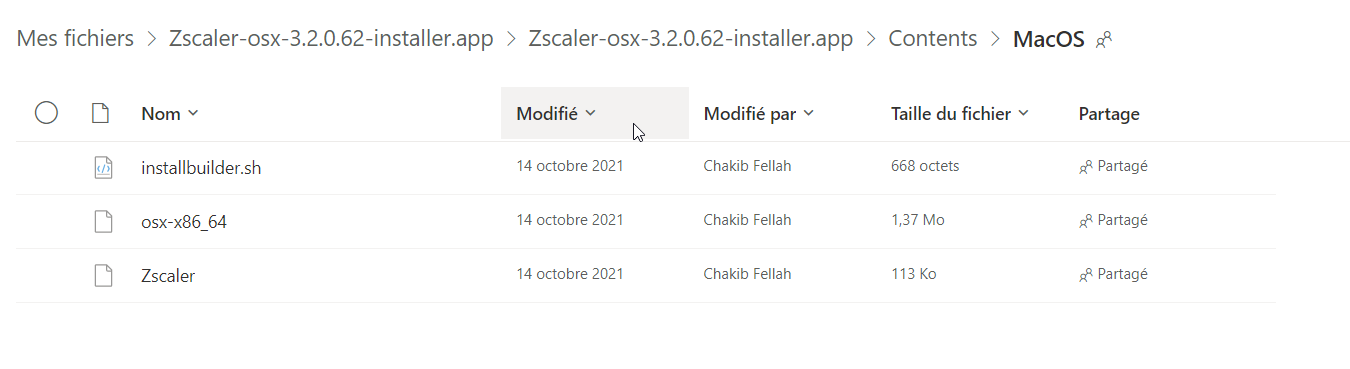

Thanks for your help, I would like to ask you .. I have another folder installation (Zscaler-osx-3.2.0.62-installer.app) ... can you help how to do the installation on a MAC, When I Unzip the folder I can't see all the folder and files I need ... can you give the right way to unzip this folder and do the installation:
2022-11-21 11_38_07-MacOS - OneDrive et 26 pages de plus - Travail – Microsoft​ Edge.png
Thanks for your help, I would like to ask you .. I have another folder installation (Zscaler-osx-3.2.0.62-installer.app) ... can you help how to do the installation on a MAC, When I Unzip the folder I can't see all the folder and files I need ... can you give the right way to unzip this folder and do the installation: View attachment 2116760
What program are you viewing this with in the image? That doesn't look like Finder
A .app is a special folder that, on a Mac, you can open as a program. It technically has a folder structure inside it, where Contents->MacOS contains the binary executables, in this case you're viewing a shell script and two Mach-O executables. These are not normally run manually, instead you simply run the .app itself and macOS will run one of the binaries from within this structure and have access to any resources from the app bundle as well if the program references them. This allows apps to be very self contained within the .app bundle.
Nothing is zipped
