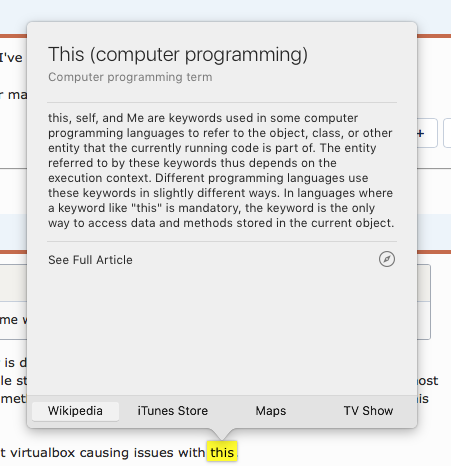

Really? That seems like a strange bug. "Look Up" still works here (MBP5,2).
Very strange.

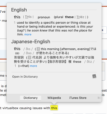

Oh. Hang on. I think Dictionary (the application) just need to download itself. Why it wouldn’t, you know, just BE there as part of the installation is a question Apple will have to answer to Steve more than anyone else.
EDIT: There it goes. So weird.
Now… if I can figure out how to “download” the rest of iBooks’ UI, we’ll be in business. :p Seriously, though, I’m never going to be able to read ePub files in iBooks again, am I…
