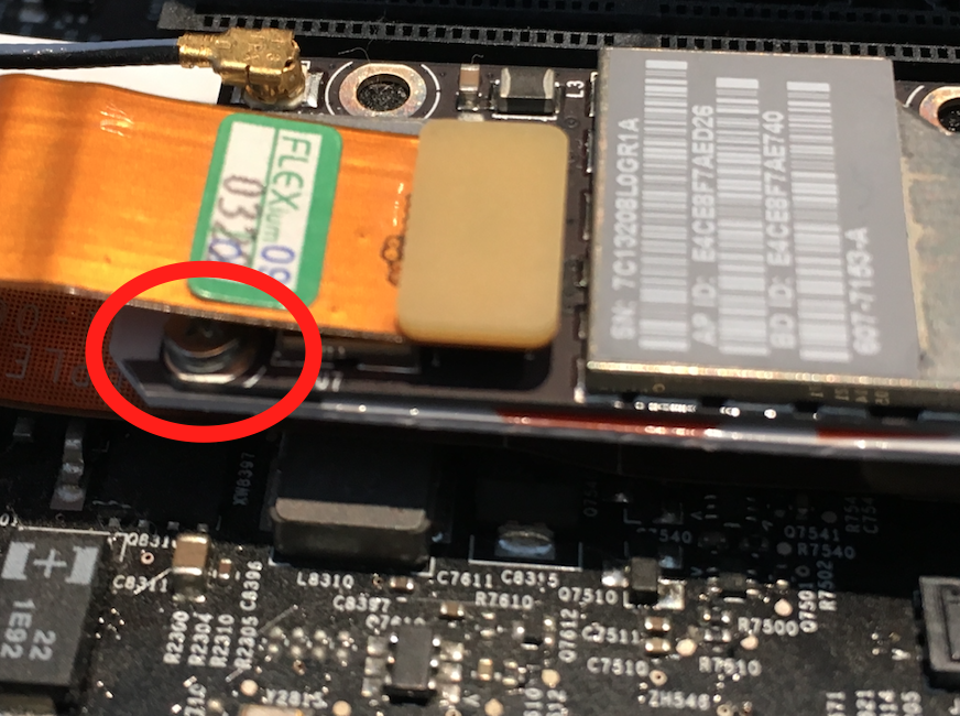

Little update:
Just put in the last piece of the Mac mini 3,1 Sierra puzzle. The WiFi
Tools used:
Standard tools for opening Mac mini 2009
Old plastic card (gym membership card)
I cut the card to size of the org. wifi card.
As the new card is smaller it will only be attached to the card with 2 screws (pic1) right top and under the flexible cable in (pic 2).
To make the 3 acres from the org. card work I drilled slightly smaller holes in the card the last screw is located in the bottom left (pic 1) where it should.
The new wifi card if firmly in place, but the antenna cable on the bottom (pic 1) is a bit on the short now, but is still fits.
Totaling my Mac mini 3,1 setup

Little update:
New WiFi module from a A1342
This module from the A1342 uses the BCM943224PCIEBT chipset as 802.11n BT 2.1, which is the same as the original, which doesn't support Continuity (Handoff, Airdrop), so it's nice to have a working module, but it would be nicer to have an upgraded 802.11ac BT 4.0LE to get the full Sierra upgrade working.
I have bought and tried the module with the BCM94331PCIEBT3B #607-9561 which came from a 2014 Mini A1347 Mini 7,1. While I was able to get the smaller card to fit, it must have different ribbon cable wiring because the Mini wouldn't boot at all, no chime, no nothing other than small white light when the card was plugged in. When the card was swapped back for the original, it booted normally. Unless I bought a dead card, it appears the BCM94331PCIEBT3B #607-9561 upgrade will NOT WORK for a Mini 3,1.
This leaves other possible options. The 2011 & 2012 Mini 5,1 & 6,1 both have 802.11n BT 4.0. I don't know if the BT 4.0 is the "LE" or "low energy" version required for Continuity support? Still, either of these may work? Since the BCM943224PCIEBT card isn't from a Mini, but rather a MacBook, it's possible MacBooks or MacBook Pro's may have an adaptable card.
When I was fitting the BCM94331PCIEBT3B #607-9561 the antenna cable connector fittings were slightly different, and wouldn't snap positively. My solution, which was moot since the card caused an unbootable status, was to use a small washer & thin plastic with a miniature paper clamp to hold the antennae cables firmly in place. I mention this in case other cards have this antennae cable fitting issue.
