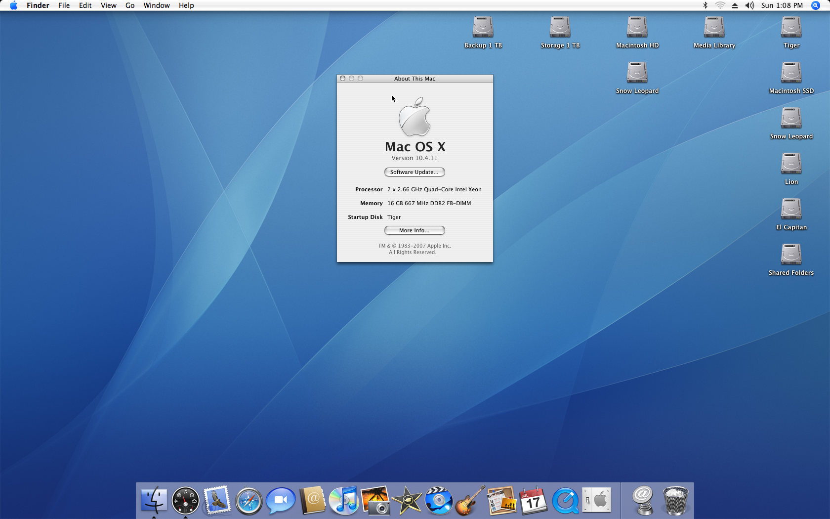

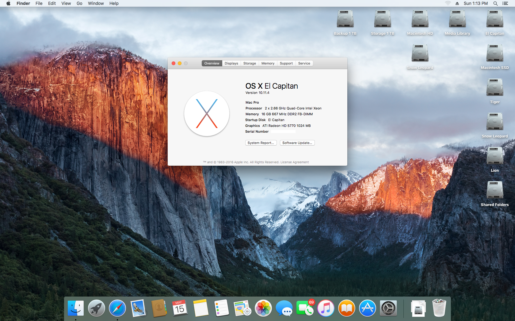

My 2006 Mac Pro is running happily with a couple X5355 SLAEGs, a Radeon HD 5770 Mac edition, 16 GB RAM, 512 GB 850 EVO SSD, and a collection of OS X versions from 10.4.11-10.11.4 (excluding 10.5, 10.8, and 10.10). It's an awesome Mac. @Morpheo, you'll certainly enjoy yours after the upgrade.
After reading this thread I learned that I can install operating systems greater than 10.7.5 on the 1,1
You can, it's just not as simple as installing on a supported Mac. You need a GPU upgrade for decent performance and a supported Mac to obtain an installer from. See this thread: https://forums.macrumors.com/threads/2006-2007-mac-pro-1-1-2-1-and-os-x-el-capitan.1890435/
It's interesting to to see a decade of OS evolution on the same hardware. 🙂

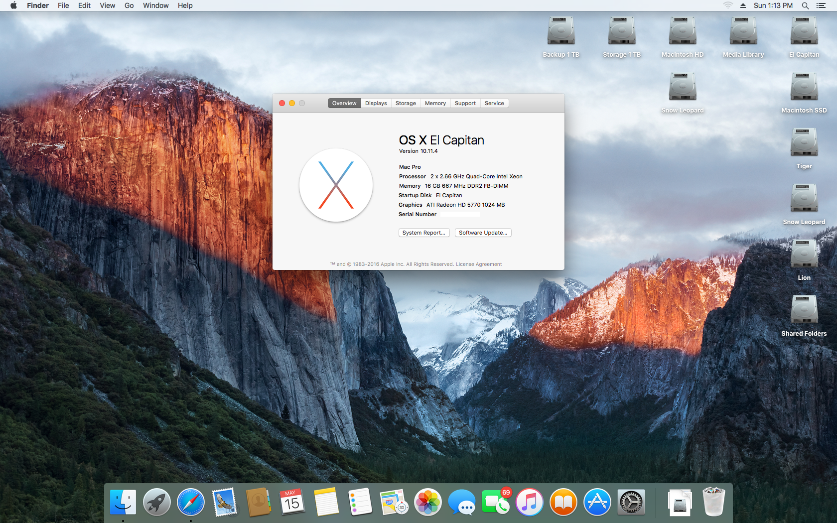

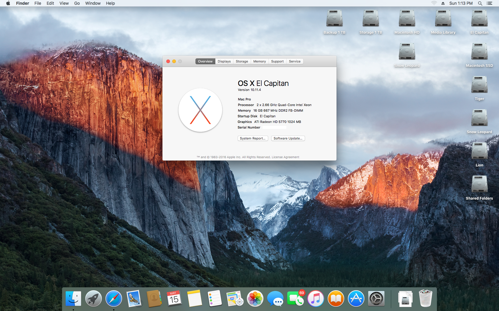

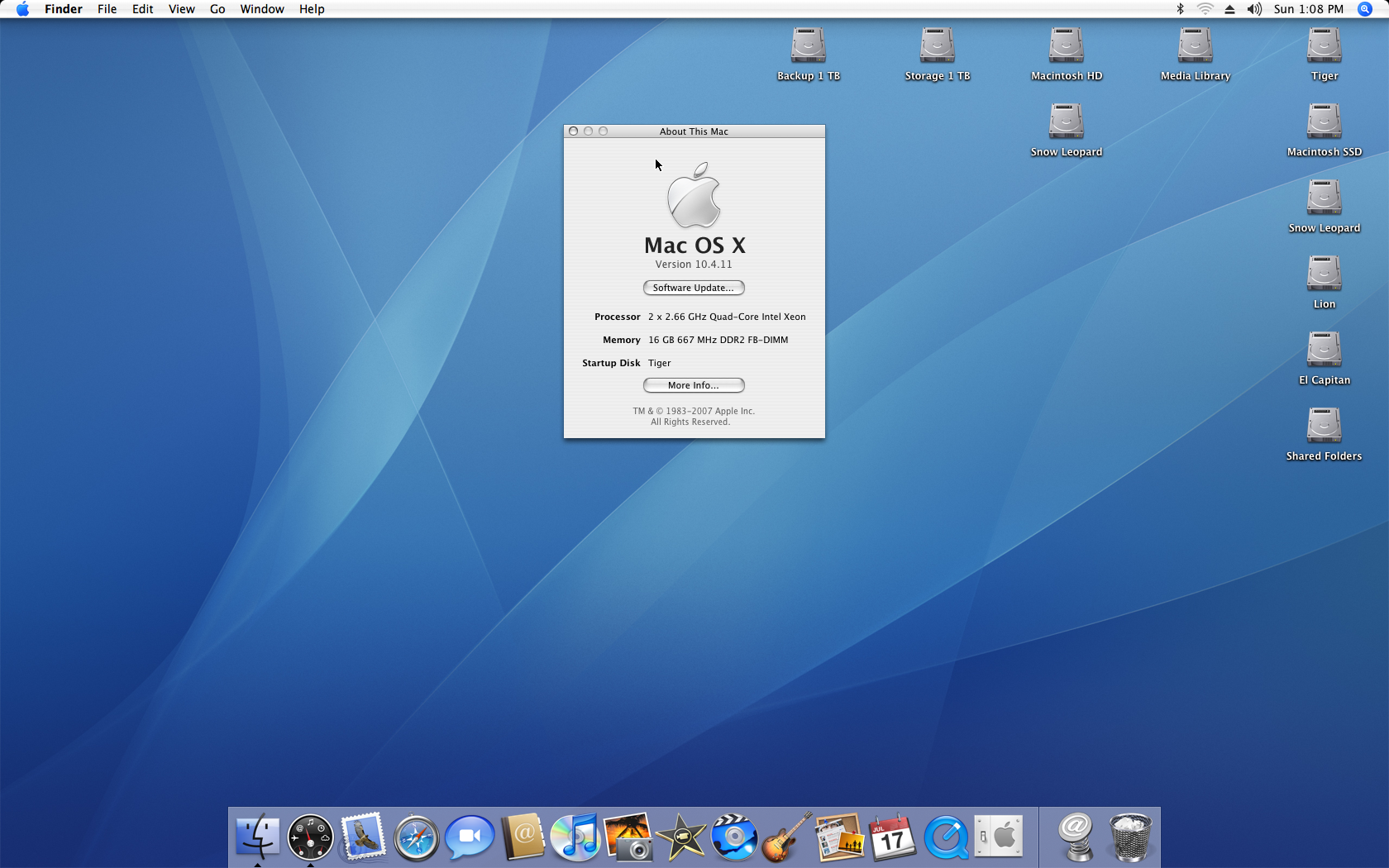

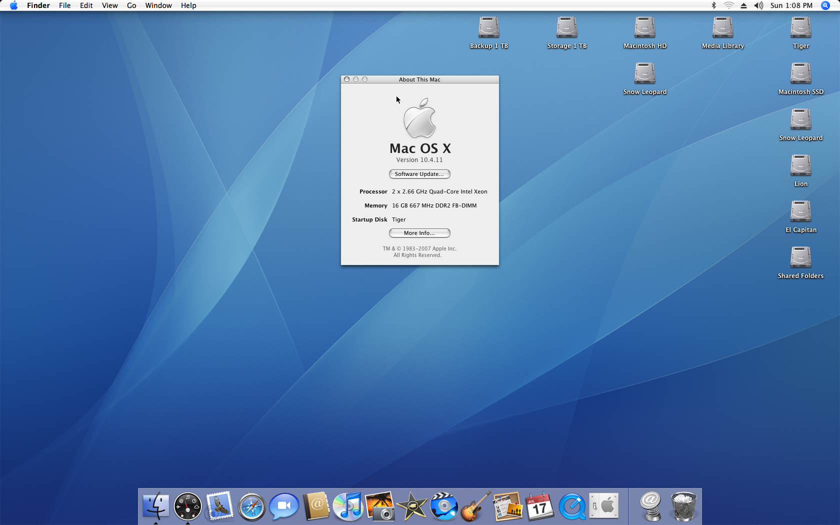

View attachment 631402 View attachment 631401
