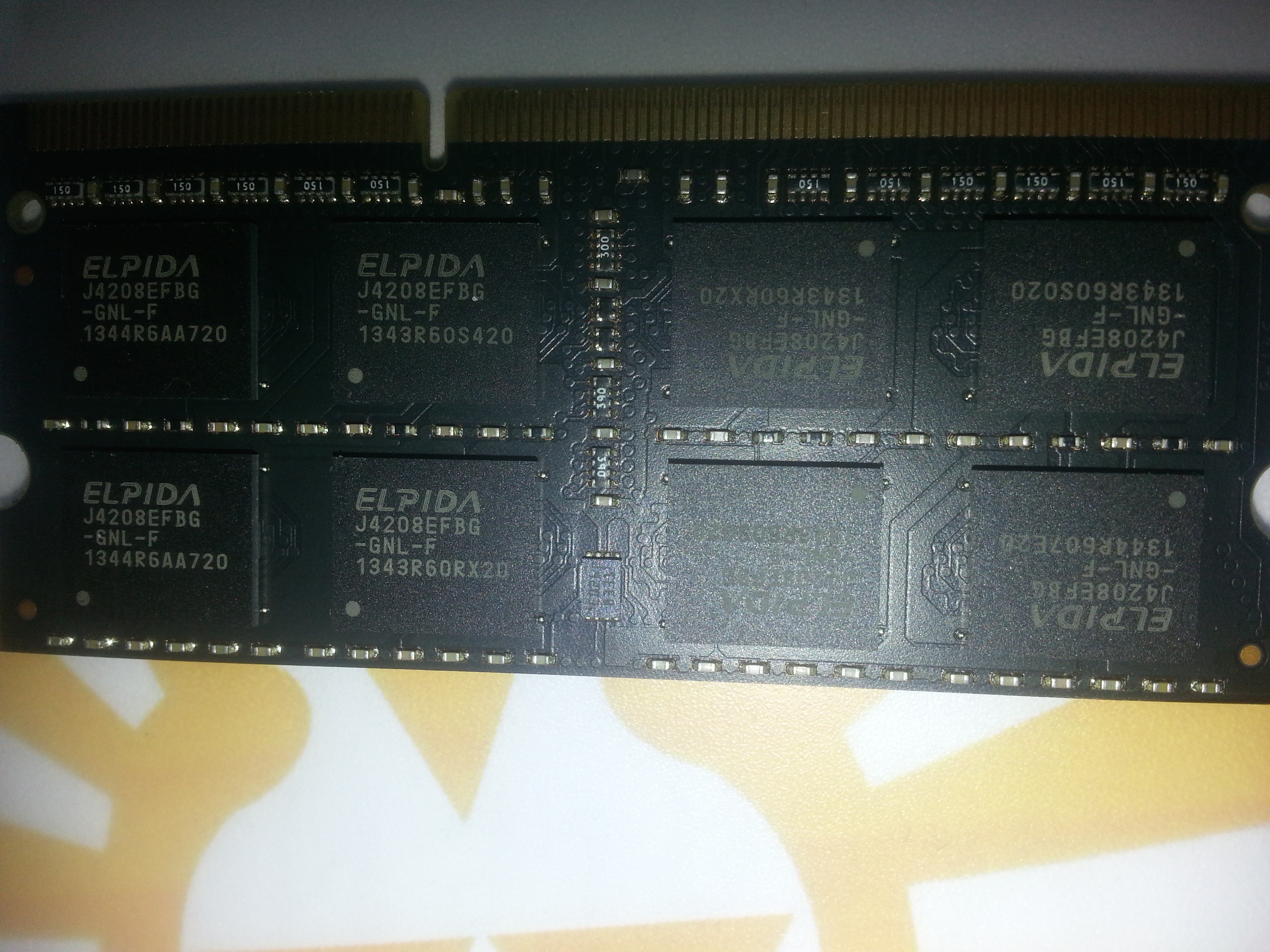

This is the RAM on my iMac
4x

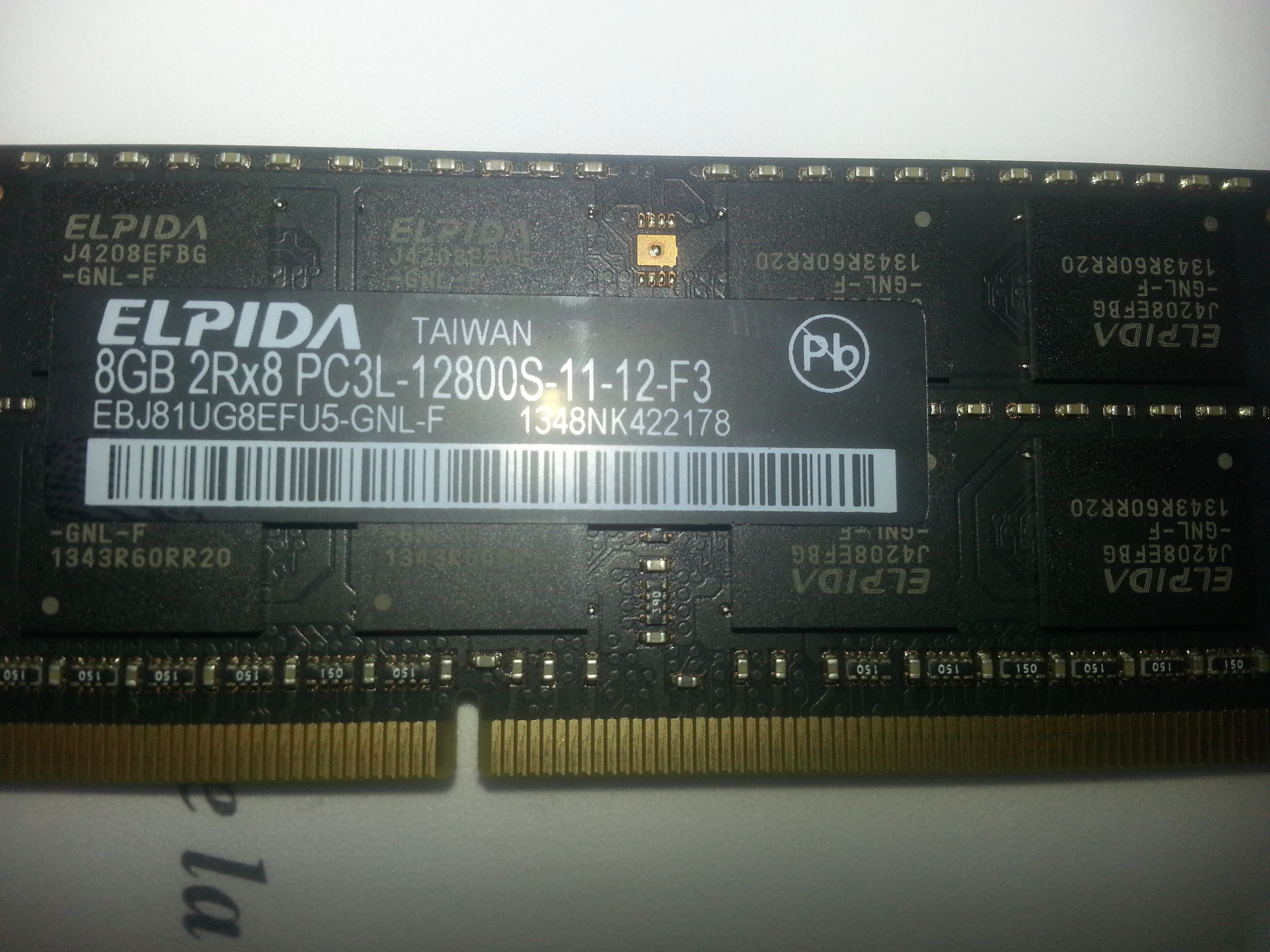

Is there a label attached to the other side of the DIMM? I think that would glean more useful information.
Please post with the results of your Memtest.

If that runs without errors, please post a pic of the label side of the DIMM. On the Apple Elpida in my machine it says DDR3L 1.35V right on the label.
Well this is weird, because the test got 0 errors.
Photo of the memory

That is definitely Elpida 1.35V DDR3L, although I believe the model number is slightly different than my own.

That's the problem, it's the stock RAM! I tried to remove some modules to run with 16-24GB but my iMac refuses to power up without the 32GB.

EDIT2: I managed to boot with 24GB, extracting the first dimm from the top instead of the bottom one.
Let's see what happens from now

With 24GB i got one KP, and now I'm on 16GB with >16h uptime, let's how this ends up.
When I end the tests and the work I'm doing I will call AppleCare and explain everything
EDIT: WELP, that's it, another one 🙁
This seems something more deep than bad RAM
As I stated earlier, as soon as I finish what I'm working, I'll call AppleCare. Will keep you informed
Yeah, I have to agree there is definitely something wrong there under the hood. I'm sure Apple will sort it out for you. Looking forward to hearing your good news.
