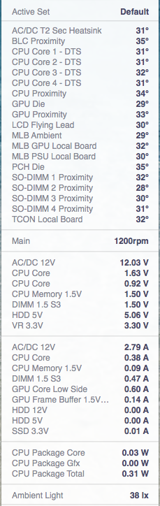

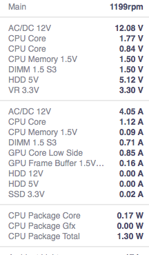

I installed IStats and my ram seems to run at 1,5V, as announced by Corsair.
I also performed a memory test with TechTool Pro 7 and there were no errors.

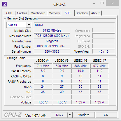

Looks like iStats reports incorrect voltage across the RAM.
Mine is 1.35V but iStats shows 1.5V also. Under Windows it's 1.35V as shown in CPUz
Yeah, it's weird. When I checked iStat Menus yesterday it was reporting around 1.15 V to 1.30 V but now shows 1.5 V. Nevermind iStat for the voltage testing.
TechTool Pro shows the correct 1.5 V. I have CPUz in BootCamp and I will also run that to confirm but I'm sure the RAM is now all running at 1.35 V.
I checked in Windows 7 Boot Camp and have confirmed that all of my RAM is now running at 1.35 V.
I also found out that the kernel panic I experienced yesterday was most likely due to an outdated driver for Tuxera NTFS I had loaded. I've since uninstalled it and have experienced no further problems yet.
I also checked with TechTool Pro 7 and it also says 1,5v for me, normal as my ram is annouced at 1,5v.
Same here. TTP 7 reports 1.5V whereas my RAM is running at 1.35V
Looks like both iStats and TTP read from the same source whatever it is.
Could be also a bug with Mavericks. No idea tbh.
If someone knows another program under OSX to check voltage more precisely I could check again. I do not have Windows on my Imac, cpuz was nice...
