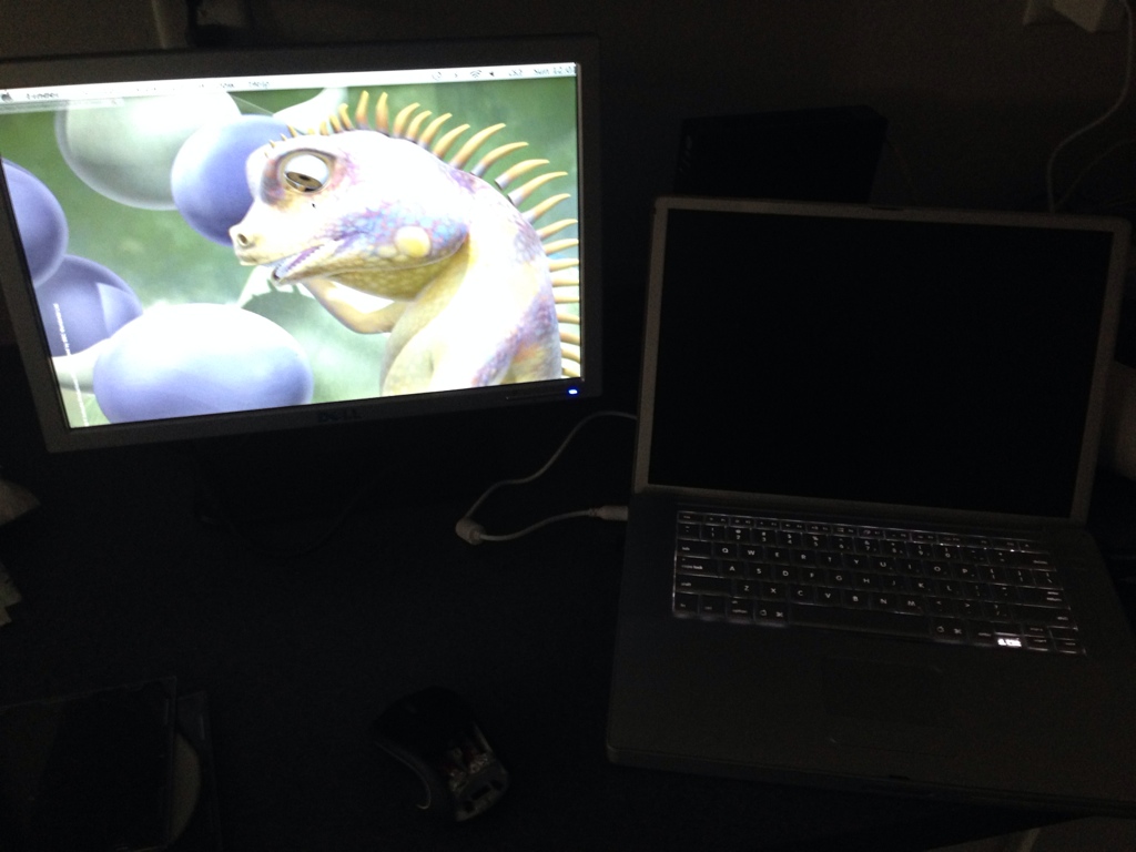

So the ram I got from California works! The system boots to a corrupted version of Leopard, that won't load anything but the mouse. I will try to re-install the os tomorrow.

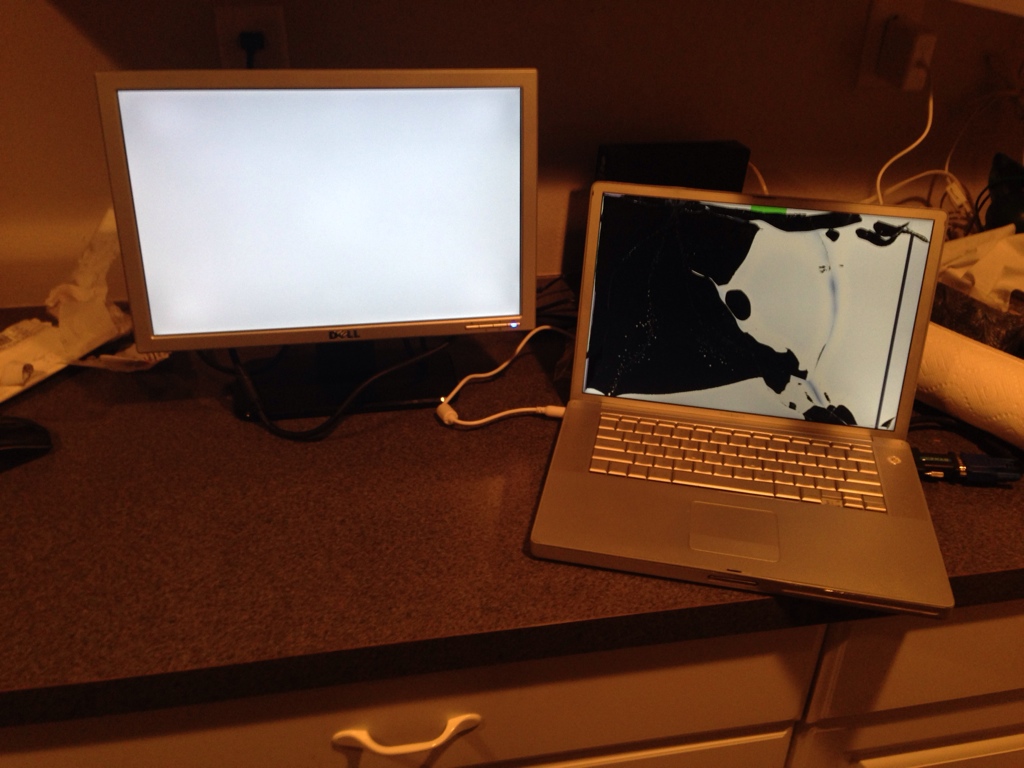

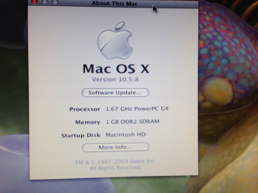

So the OS is not broken! I realized that it was booting in dual screen mode. I was able to log in to the "kid" profile because the password was so easy. Unfortunately it has barely any access to anything. Also, it only is registering 1GB of ram.
