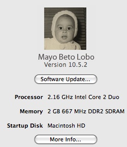

It only gets better, I would advise switchers to repair permissions after any update or repair permissions before, learn how to diagnose your system, there are plenty of basic tools to assist you in this and you don't have to be a technician to understand its data, for example the Console logs provide a lot of good basic info, the Terminal app is great to and all you have to do is learn a couple of commands, also do not be afraid of researching your issue here on these forums and on the Apple site, I cannot believe that I will be posting the "sleep"issue yet again on these forums (which is to disconnect the battery from your laptop or disconnect your desktop, press the powerbutton for about ten seconds then reconnect,restart, other wise known as the PMU reset!) I was racing against this update to solve the connectivity issue and I did before the update was issued, the update was good. no known issues, works well on my mini and powerbook g4. There was a user in the Apple site that kept posting the same B.S on a thread about the connectivity issue and claimed that he did not need to try any hints or research any fixes since it is Apple's responsibility too keep his machine stable, "he demands the update now" silly Chamcox got the thread locked-out, he did not try any of the hints and I think hes still struggling, so avoid being like Chamcox an acute passive user, learn how to do basic trouble-shoot and do try the hints and fixes and learn in the meanwhile a new thing or two. Expect things to get bad once in a while with some update as well, but remember you have very good Mac users here in Macrumors willing to help.

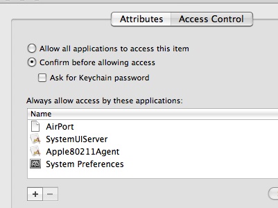

did you check you network keychain?...
In the Keychain Access Control tab you should see the following elements in your wireless or network keychain:
the systemuiserver.app
I had to delete all the plist files because it did not re-connect after I awoke the computer from sleep, so I threw away the system configuration folder, all airport plists files and the keychain, upon restarting the keychain showed the files I was looking for which is the systemUIserver and the airport deamon, (in the keychain lists as: airport) I added the System prefs and the apple80211agent. I think this stabilizes yet again the network.

in 10.5.1 the airportd (airport daemon) was located in /usr/bin/libexec, after the update it was relocated to Groups:// I do not know where this last section is but it may explain some of the initial glitches regarding connectivity, some users had achieved good wireless connectivity with some of the hints posted during 10.5.1, but after the update people started to wonder if the update ruined it, after some inspection I saw that the wireless or network keychain was altered after the update, the System preferences icon was missing from the allowed list in the control access tab, so I added it plus the Apple80211Agent, and I have not had a drop-out since.
the Apple80211Agent is located System>library>coreservices.
In the pic it shows the Airportd icon but its actually a small hack that I did but Im not sure it works as it should.
<NEW EVENT> the network was dropping yet again, so threw away the keychain and plists files and restarted, when I registered the network these new files appeared in the new wireless keychain which are the ones I think helped maintain stability or achieve connection as in 10.5.1
