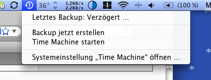

Hi, I installed the update the day it came out. I'm using a USB HDD connected to my Airport Extreme n as TimeMachine Volume.
First: TimeMachine still works, BUT anytime i switch off the external HDD or power up my MB in a non-home-environment I get the '!' in the menu-bar-logo, that he couldn't do his backup job becuse there was trouble.
I never had this problem before. He never tried to backup while his backup wasn't connected
Does anyone else have this issue?

I restarted my MB and let TimeMachine run. After that I switched off the backup HDD and waited. Now he tells me that the backup is delayed again 😡
Same thing happened to me and I mentioned this in a couple of threads. Whenever I was on another network (other than my home one) - I got that exclamation point and delayed error. I called support - they had no idea and just told me to "turn off Time Machine when on a network other than my home one."
What I did was change the disk in preferences back to my TC - because the current disk when I was home, said "Time Capsule-1" which wasnt the name of my TC. I changed it back when you go to "change disk" and its been fine since.
Def a 10.5.6 bug...

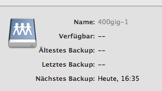

My USB-Airport-HDD is called "400gig" and that's the name I see in finder when I choose Airport. When TimeMachine is running he mounts an image called "backup of <username>".
In TimeMachine preferences he says the name is "400gig".
There are no diferences visible to me compared to 10.5.5

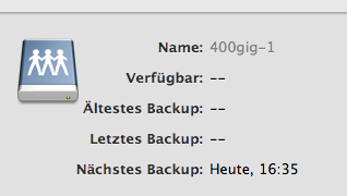

Go to Time Machine preferences, preferably when you are on your home network. Make sure the name of the disk is the correct one, if not change it.
Thanks, the disc-name was right but I reselected it in TM-Preferences. After the backup I switched off the drive and I'll wait what happens in about an hour...
Okay, after reselecting the real drive now he tells me that his backup volume is "400gig-1". He does that when the drive is not connected. When I connect to it in finder he switches to "400gig".
Rereselecting doesn't fix it, after ejecting the volume he switches back to "400gig-1"

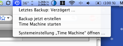

It's entirely possible that this behaviour is by design i.e. the've changed the behaviour of the menu bar icon to reflect the fact that under those circumstances your Time Machine backups won't be running. Previously you wouldn't have known from the menubar if the external disk had accidentally got unplugged, for example.
If it was a feature instead of a bug I'd expect TM to inform me that he has no connection to the backup volume instead of trying to reach it and fail.
So I don't consider this behavior a feature.
