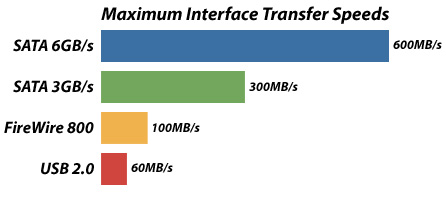

I see your point and I will probably go that route when I my boot drive get's full. Currently it hosts 4 VM's, all of them growing every day. So a second SSD will definitely be necessary in the next couple of month, which would require a decent controller.
For now I'm fine with software RAID, even though my drives operate pretty close to the ICH10s maximum throughput.
Thank you very much for your support, nanofrog. I will come back to you when it's time to install a proper RAID controller. 😀

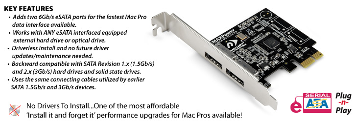

I didn't read the whole thread but this hasn't been posted yet to answer the eSATA question:
There is a new one coming by newertech and it looks really nice in my opinion.
http://www.newertech.com/products/pcieesata.php
I posted it earlier but no one seemed interested. Well, I'm running one right now (received it yesterday). I don't plan to benchmark it or anything but i'm glad to have an eSATA card that works booted in the 64-bit kernel. Driverless, nonetheless.
Could you provide details as to how your drive are setup?
Thanks. 🙂
