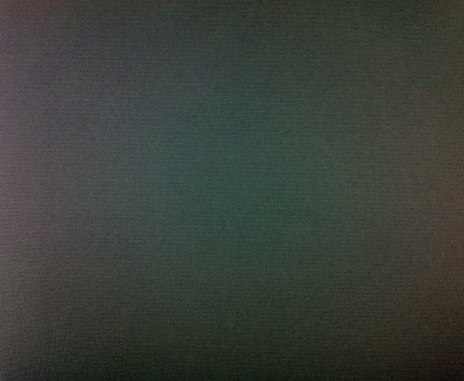

I managed to snap a picture that manages to roughly show what the pinstripes look like. They're a lot more apparent and clean-cut than how they look here though.

Although it's a little hard to see from the picture I provided, the stripes are horizontal. They're similar in size to the old OS X pinstripes of yesteryear.
