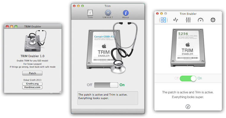

That is bad information. This was true of Trim Enabler V1, but since V2 Trim Enabler modifies the existing kext just like the Terminal command does. It does not use the old Snow Leopard kext.

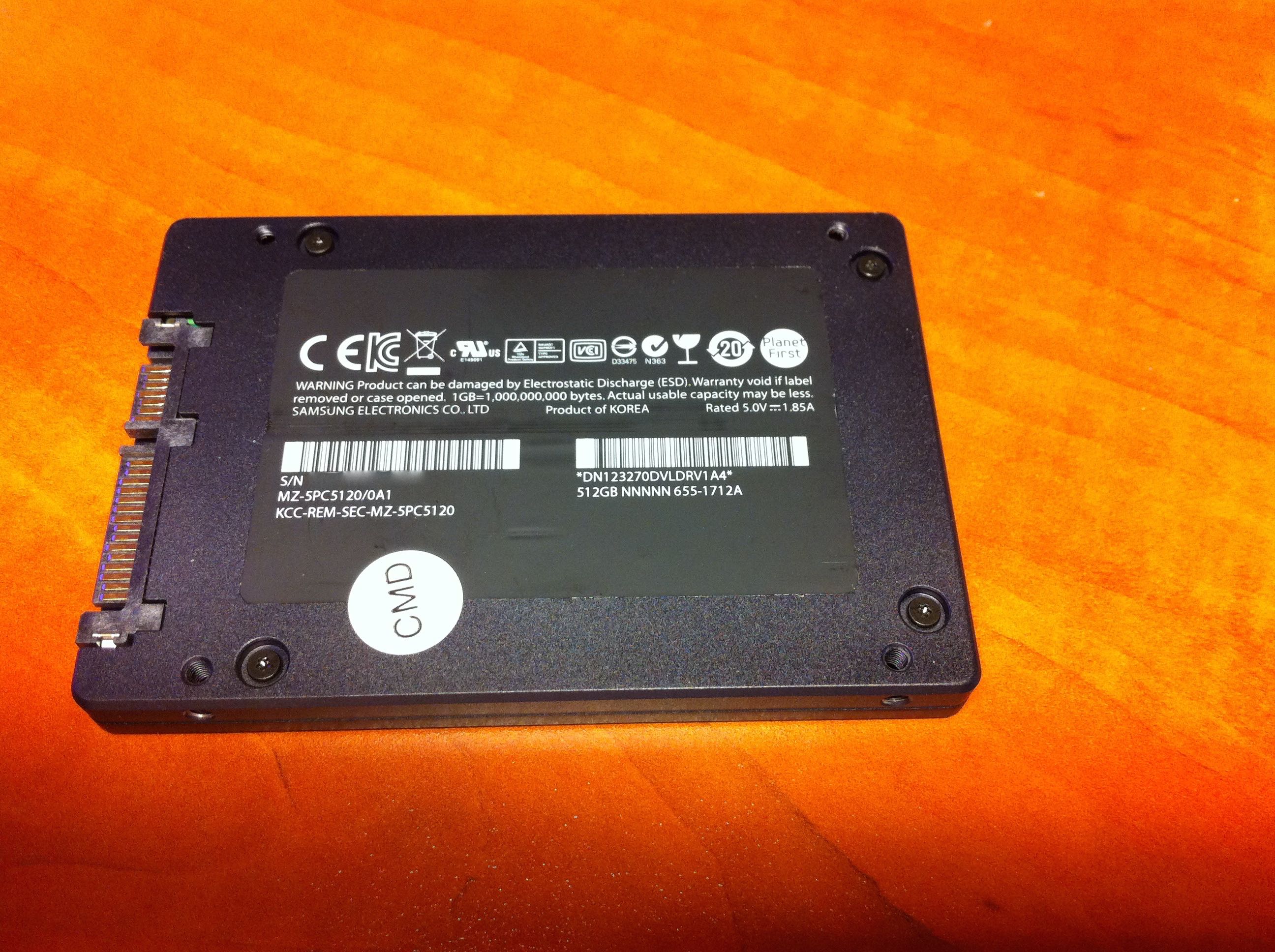

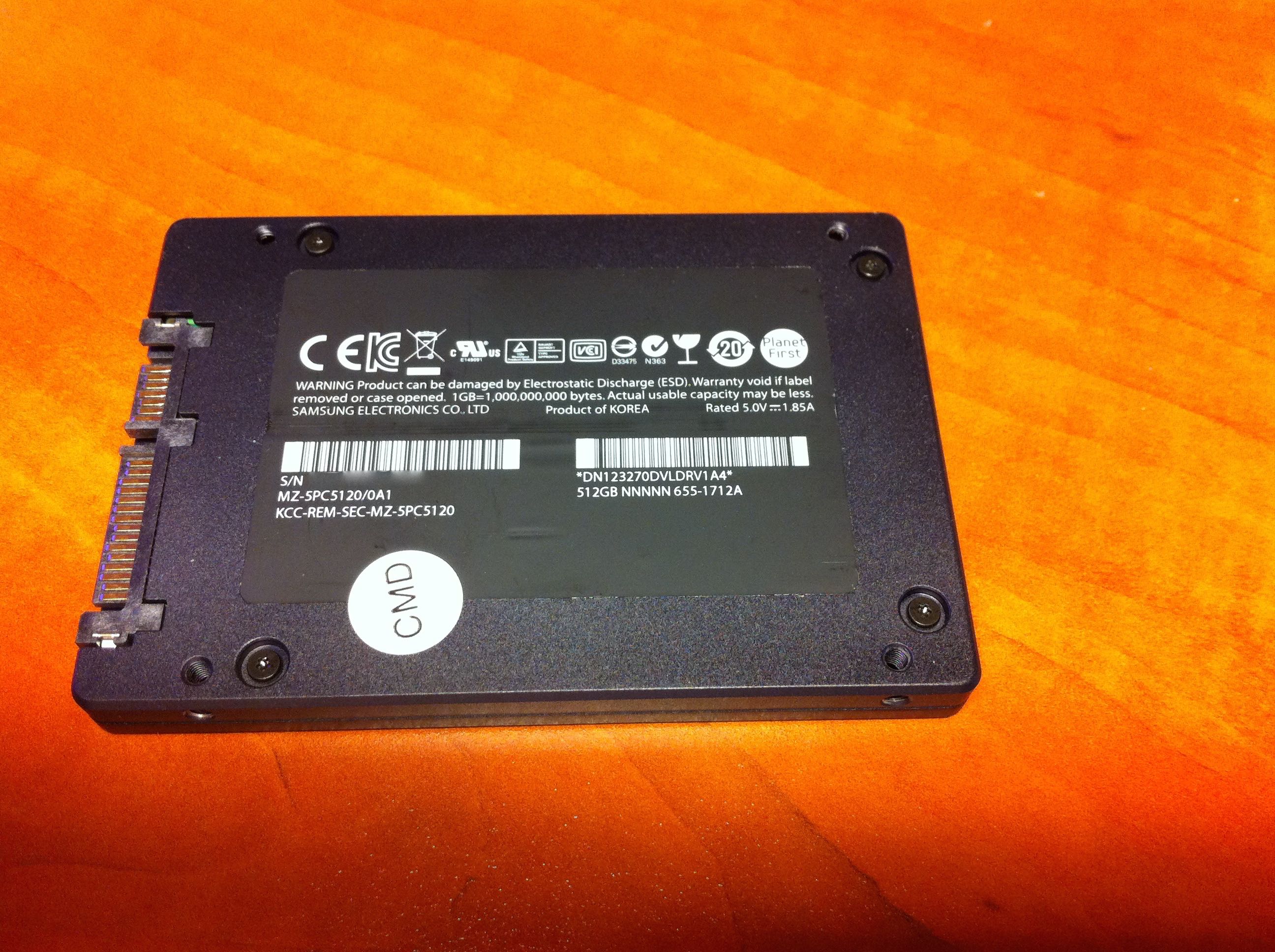

Because Apple wants to sell OVERPRICED SSD's for native trim support, with just a tiny 'tweak' in a Samsung SSD like the one that came with my 2012 MP 5.1! 🙄

Model and manufacturer + 500Gb or 512GB ?
What Samsung SSD did Apple use? The 840 Pro?
Tried to Google for the manufacturer and model of this SSD, what codes are best for this search? I'm even more curious why it's listed as 500GB in stead of 512GB that is printed on the label and is engraved on the original Apple SSD alu enclosure to use one of the sleds in the HDD/SSD bay. Popped it into my USB 2.0 disk duplicator for a quick view

Perhaps a read-out error?

Your drive is a 512GB Samsung PM830.

This is false information.
Trim Enabler 1.0 (released back in 2011) used this as a method. It also had a label stating "Only for use on Snow Leopard".
Ever since Trim Enabler 2.0 (released back in 2012), Trim Enabler unlocks the kernel extension directly, leaving your OS otherwise unaltered.
Trim Enabler has made quite a journey since then. Here are screenshots of version 1, 2 and 3 respectively to put things in perspective.
