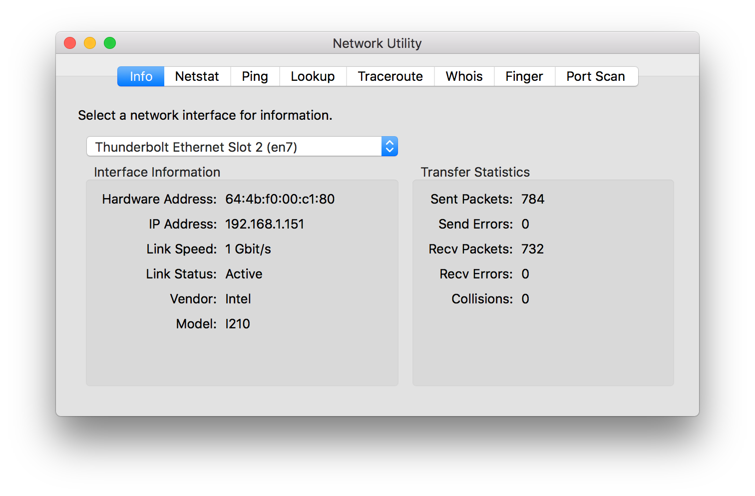

I read that the A1143 Airport Extreme can be either have ethernet speed at 100 Mbps or 1000 Mbps. How do I know?
If your computer is a Mac you can tell what speed your Ethernet connection is by looking at the Link Speed using the Network Utility application.
