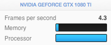

Four days ago I went away on a family trip. To have something interesting to come back to, I started a simple clay render animation from my apartment that I had modelled in C4D and then exported to Maxwell Render 4. I set it up so that it wouldn't finish before I came back.
The CUDA render support in Maxwell 4 isn't complete and on Mac it's 'experimental'. I've had hits and misses.
The good thing here is that I started the render before I left and it's still going strong! I had half expected a crash for one reason or another. The computer is extremely quiet. I'm using a MSI Gaming 1080 Ti will two pretty large fans on ball bearings.
iStat Menus has the GPU working properly.
Anyway... I just wanted to share this as I feel it's a good sign of stability. On the game side I'm running F1 2016 and that can be a bit flaky with the occasional hang. Hopefully that improves with one or two patches.

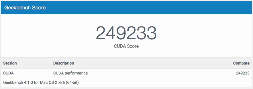

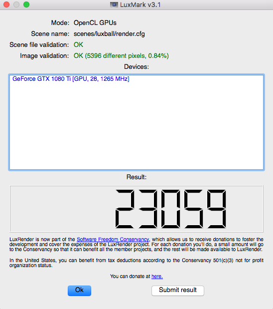

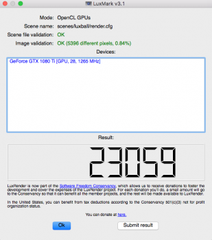

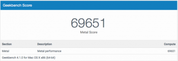

That was the first thing I posted when I installed the card. There are other threads for that, but I'll give you a few screen grabs:
GeekBench 4.1 OpenCL doesn't run to completion. This is Metal and CUDA.
Make sure to compare apples to apples: people post scores in various resolutions for Heaven.

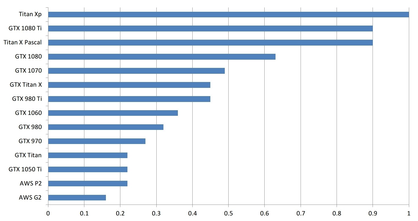

Although this is talking about a very different problem space (deep learning), you might find some interesting points in http://timdettmers.com/2017/04/09/which-gpu-for-deep-learning/ .
In particular one comment he makes is that it often doesn't make sense to upgrade from a top Gen-1 card to a top Gen-current card. Here's one rough chart:
Of course, every situation is different - and some people may be happy with spending extra for a modest improvement (e.g. if you have to meet tight deadlines, double the prices for a 15% improvement might be perfect).
With Volta on the horizon, rushing into Pascal might not be wise.
