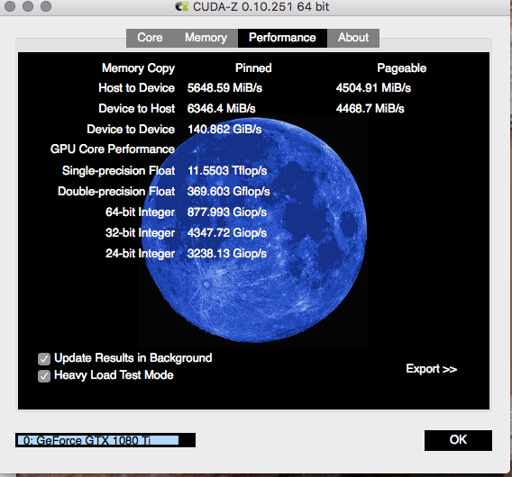

I don't think the Pascal driver lowers the clock. Why should it? Software can report wrong reading as you said Cuda-Z and Luxmark do not read same clock. Mine is founder edition, same as you, CUDA-Z and Luxmark read different clock.
In fact the CUDA Z in mac shows higher memory speed between device and host..
Exactly double of that in CUDA Z in windows 10.
