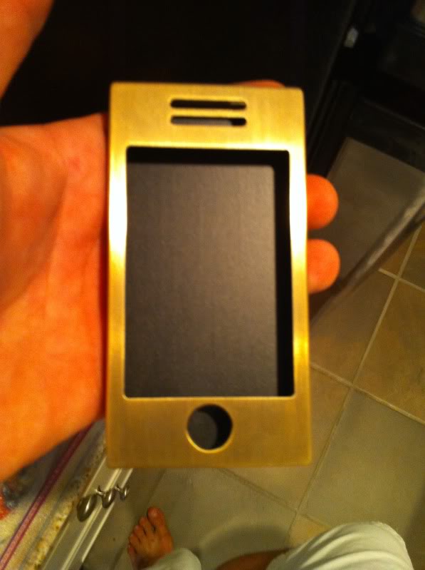

I did the clear case mod a few days ago and it turned out pretty sexy, but my current brass case was even sexier. So I need to cut the back out of my case. I am looking to have the clear phone exposed while in the case. I would just need the exact size hole for the LCD screen cut in the same location on the back part. For the front I want to be able to see above and below the LCD and I was thinking it would look good with a rounded corner (like an ice hockey rink) following the curvature of the phone. I am also looking to loose some weight from the case by cutting out some of it.
What do you guys think?

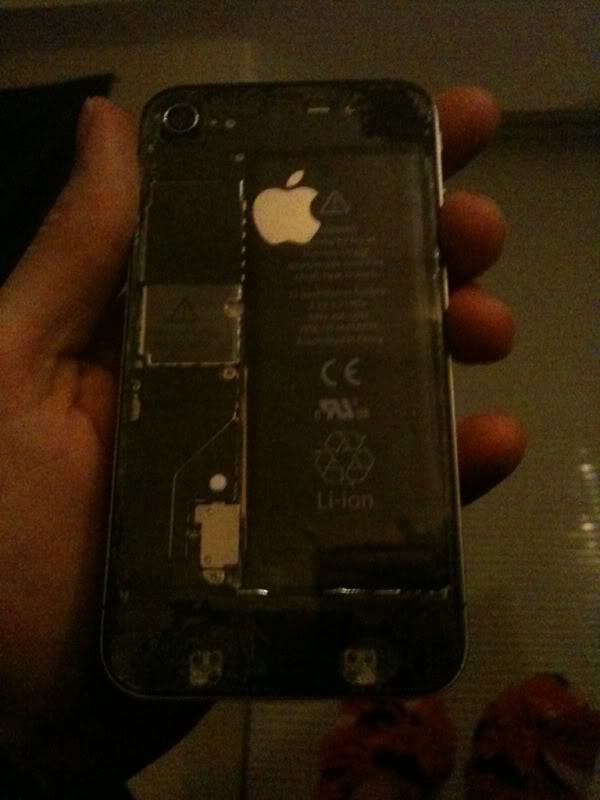

Well I watched a YouTube video of how to take apart the phone.
To do what I did you need to take off the back glass, heat it with a hair dryer, separate the mounting bracket from the glass itself, trim out the center of the mounting bracket leaving just the rim, i scratched off the paint with a scalpel leaving just the apple that I freehand cut, reglue it to the glass, remove the battery mount, the battery, the mic/speaker thing, the rear camera, the vibrating thing, the processor, unplug 5 connectors, 20 some screws, the front glass/LCD, remove the glue from what you took apart. It took me 7 hours having never done anything like this before and I had not much to go on.

Thanks for the info, I have experience with disassembly already having converted one of my iphones to white including headphone jack, and dock connector, it was more a case of wanting to know how exactly you removed the paint. I gather the paint is on the inside of the glass correct?
I don't quite follow with the Apple logo though, is this not on the outside of the glass along with the iPhone text?
Both the silver and the black is on the inside. I cut around the apple. The words looked too difficult.
Anyone know where I can buy the clear back glass online? Just the back. It's awesome!
They have green, white, and red ones on eBay, but no clear! What's the deal!
My clear is the original black. I scratched the paint, read above. I didn't buy anything.
