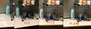

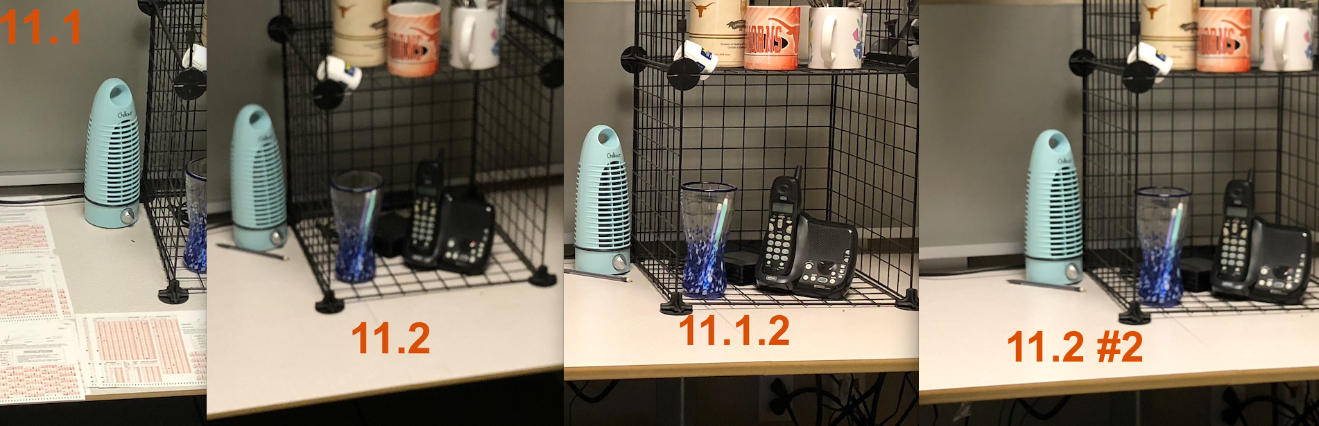

I'm uploading three photos ordered chronologicaly from left to right. All photos are taken from the same point and zoomed in to show the detail, which is where the focus issues are most apparent for me.
  • I took the first one (11.1) about a week ago, this is the control photo.
  • The second (11.2) is from yesterday afternoon. Taken from the exact same distance, there was no way for me to focus any better than this. Even using 3rd party apps*.
  • The third photo (11.1.2) is from this morning immediately after I restored my phone using the old firmware.
  • The fourth photo (11.2 #2) is from right now. Seeing that 11.1.2 fixed the issue, I was curious if I updated whether the problem would re-arise. There was a noticeable loss of detail, although it does seem like a better photo than the second one (11.2). Not sure what to make of this. Still obviously not as crisp as wither 11.1.x photos.
These photos perfectly illustrate the issues I've experienced. Something about the 11.2 update has dramatically altered the camera. I was able to compare my phone to a friend's iPhone X last night and, even though he was also on 11.2, he did not have any problems with the camera. So this problem does not appear to be universal. The issue seems to be limited to the wide angle lens. Using portrait mode fixes the problem because portrait mode uses the tele lens. Macro shots are unaffected, so the problem lies in the ability to focus at infinity. Something is holding the lens back.
I'm not sure what else to do at this point. One one hand, I'm glad that I have evidence that this issue is 100% software-based, but on the other it's frustrating to know that my phone is crippled until Apple acknowledges and fixes the issue. I can't afford to stick around on the 11.1.2 firmware until a fix is made, so I will just stay on the flawed 11.2 and hope for the best.
Until then, macro telephoto photos only, I guess.
*3rd party camera app permissions were my first suspect, so those were all denied permission/deleted when I first began to troubleshoot to no avail.
