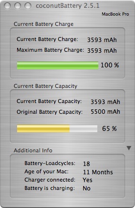

Oh great, after letting it charge to full overnight. Check out the new result. :rolleyes:

But are you sure you calibrated correctly? In any case, it looks like your battery has gone bad, or at least it isn't holding the charge it ought to. Calibrate once more (just to be safe) and then see if it remains below 85%. If it does, you need to contact Apple.
On my now dead battery, I had this happen several times, where after calibrating, it would have a precipitous drop in capacity. I found that if I let it discharge a bit, maybe down to 75% or so, then charged it back up to full capacity, it would regain the better part of its capacity.
Not all of it, mind you, but a good part of it.
This is why I just bought another battery off of a forum member. My battery, despite having been replaced, was still hinky as far as I am concerned.
I'm gonna try calibrating that thing one more time. From full charged state, drained the battery continuiously (no shutdown/restart), when it goes to sleep I'm gonna wake it up to shut it down through the OS, then plug in the power adapter and wait for it to be full charged (until green light). The last time I just hold the power button when it got to sleep, I realized that it didnt actually shutdown but just went into a powerless sleep (data saved to hard drive, power off).
I hate to contact AppleCare for replacement, I really prefer my hardwares to be as original as possible.
That's not how calibration works. You need to let your computer rest for 6 hours (at least) WITHOUT plugging in the AC adapter. This is to ensure that the battery dies completely. Once your battery has been dead for AT LEAST 6 hours, you can plug the AC back in. Read more here.
As for new hardware, Apple will probably just send you a new battery.

I did another round of calibration after my last post, even let it rest in sleep for 7 hours before recharging. Unfortunately the health stayed at 65%.

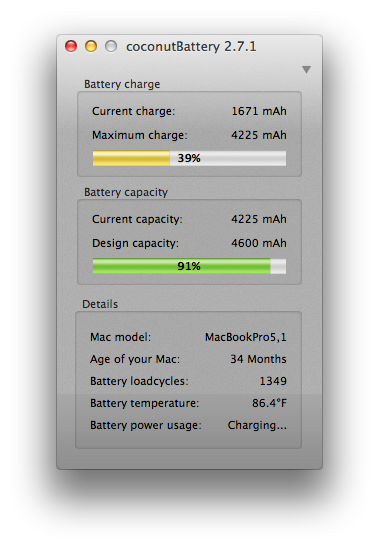

How can the capacity be more then the original?
12 weeks, 5 cycles, 91% :(
Calibration took even one percent from my previous 92%... :(
