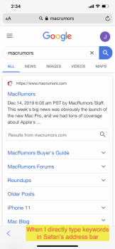

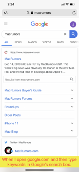

Hi,
First of all, English is not my first language, so please excuse if there're any mistakes.
I have an iPhone 11 Pro Max, and I'm not sure when this started, but when I do Google search directly in the Safari's address bar, result pages are displayed like they're in the zoomed mode. Everything on the pages looks bigger than when I search on Google website by opening google.com and then typing keywords in the search box (as you can see from the attached pics).
Is there anyone experiencing the same issue recently?

I just tried it and confirmed it works properly on a private window! But what's strange is that on a general(non-private) window, the issue is not fixed even when I've completely signed out from my google account.
Is it only me experiencing this...? 😭

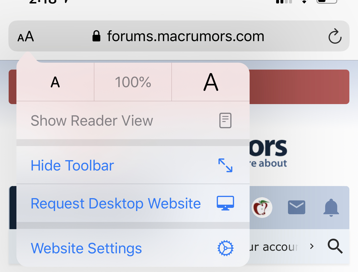

The other possibility is...
Go to Google.com, tap on the "aA" on the left of the menu bar. You might have accidentally set it to a larger font. Not sure why it wouldn't respect it when going via the browser bar... but it seems plausible.IMG_0980.jpg
Go to Google.com, tap on the "aA" on the left of the menu bar. You might have accidentally set it to a larger font. Not sure why it wouldn't respect it when going via the browser bar... but it seems plausible.View attachment 883050
This solved my issue!!! The zoom was accidentally set to 115%. Thanks a lot for your help! :)
