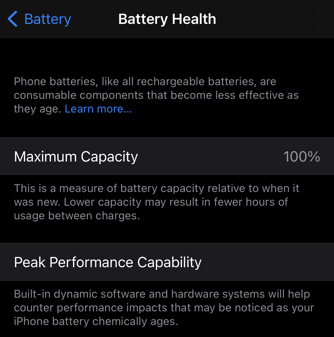

Reports 100% in both the settings under battery and Coconut Battery.

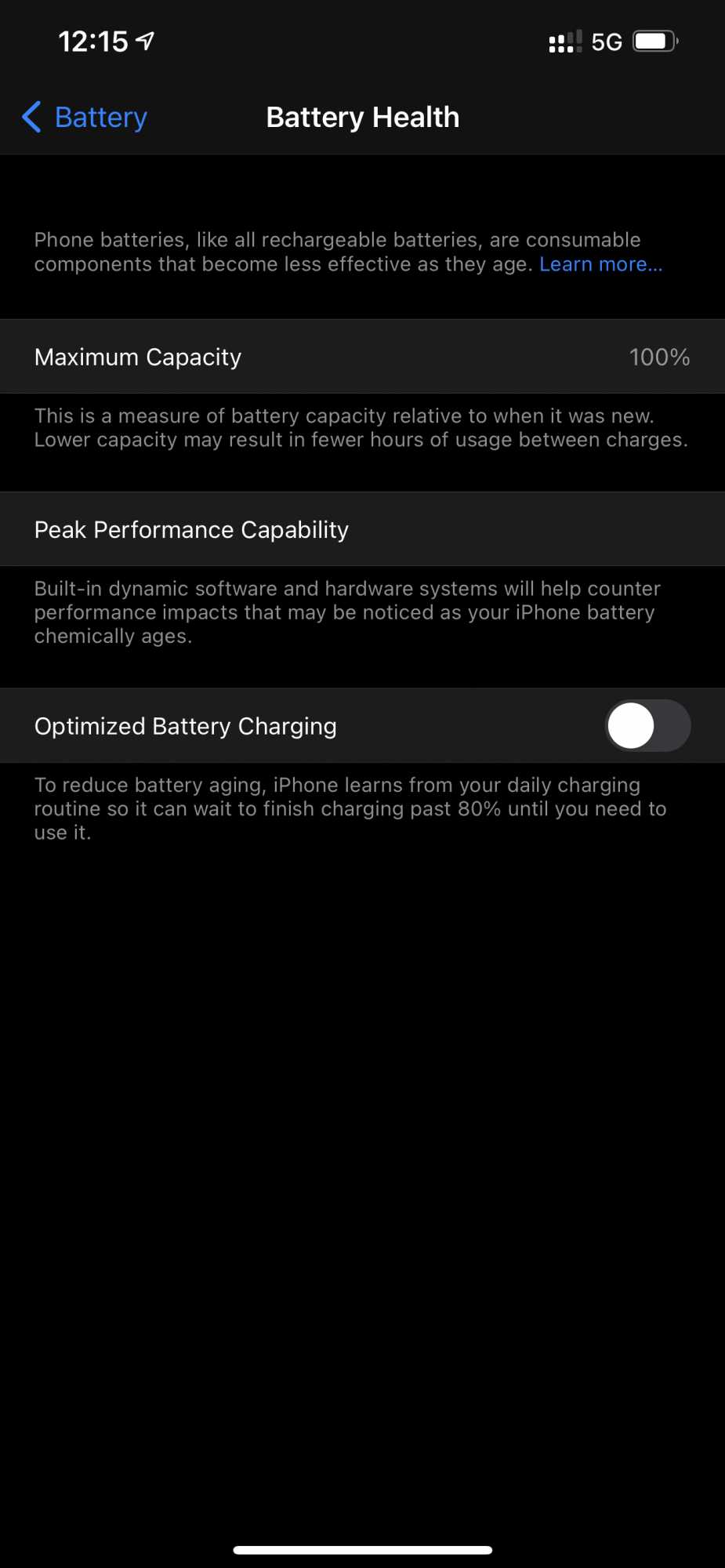

12 Pro here - put in service late November. 100% battery health. I put it on the charger every night with a 5w charger that came with my iPhone 11 Pro. Usually I end the day with about 70% left on a charge, so I am relatively low use during the day. Charge it overnight, every night..... optimized charging is on and working.

This is the first phone / device that I've ever manually tried to do the 40-80%. My phone spends most of its time between 60-85%. It is not used heavily. I am very lucky to have received a battery that is quite a bit over design capacity and not showing any wear. Apple health showing 100% of course.

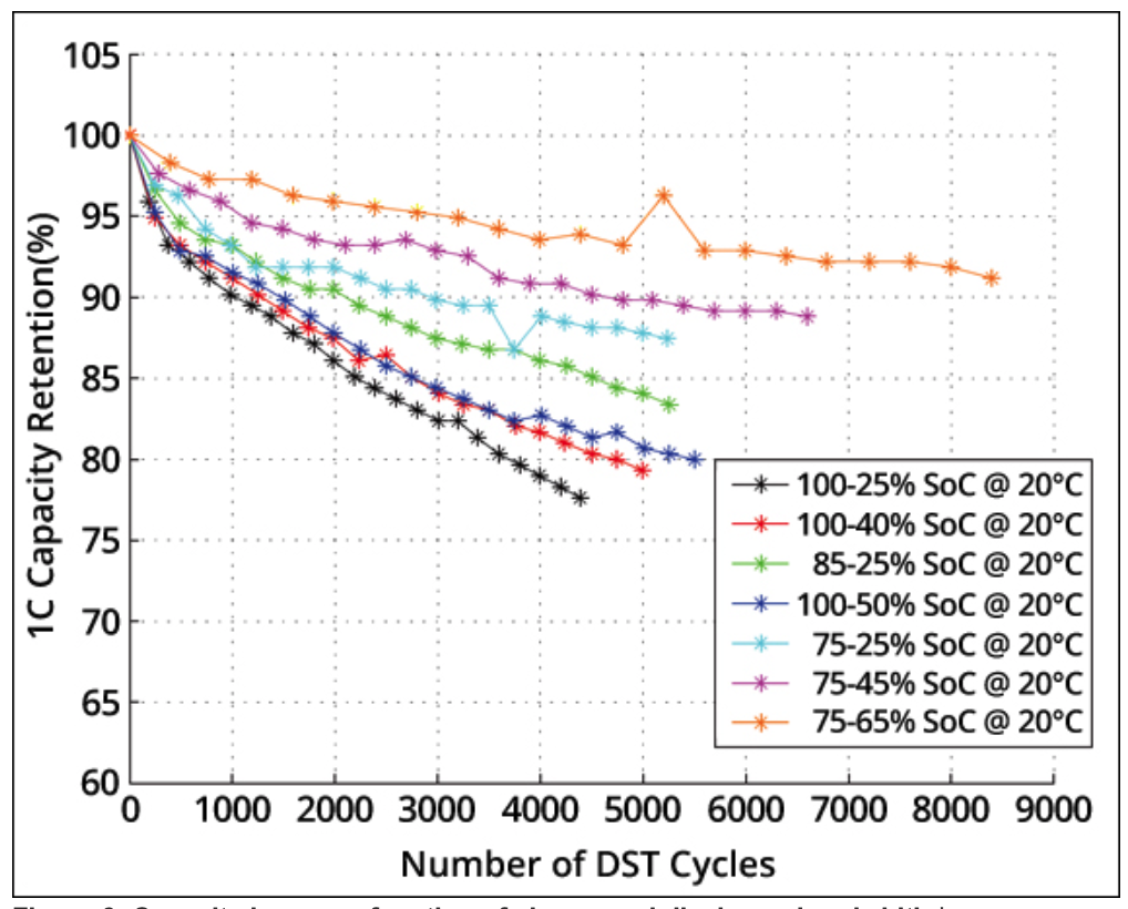

Some batteries come several hundred mAh over design capacity and can retain 100% a year after. I have watched all my iPhones since the 6+ and - most have come at least 100mAh over design capacity. I had one come 96% design capacity from the factory. Isidor Buchmann's book - https://www.amazon.com/dp/B071NJZCGF - reports that lithium batteries can actually grow in capacity during the first 100 cycles or so if treated well. Then, of course, they start degrading after. But depending on how you treat the battery, one can cycle a long time and see little degradation.
