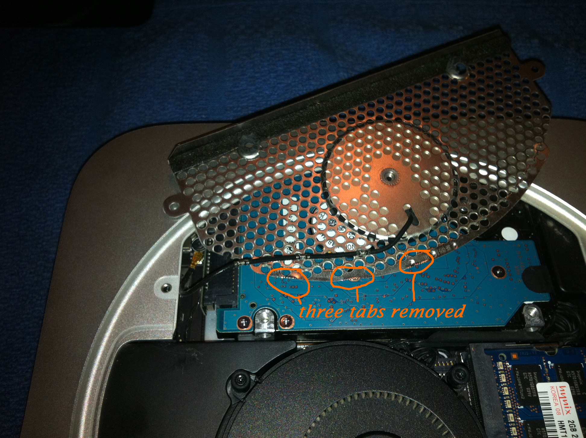

Confirmed. Got my 12.5mm Toshiba to fit inside the 2010 Mac Mini.
I had to remove the airport antenna wire from the shroud and cut off the metal tabs that hold that wire down so it would slide back in. After that small modification. Fits snug like a bug.

Yes regular Mini with DVD drive. Only required a small modification. The little tabs that hold the airport antenna on the airport shield have to be removed as they were blocking the airport shield from sitting flush. Other than than it fits just fine.

Here's the pic of the 3 tabs removed. Sorry I don't have a picture of them before I cut them off.
