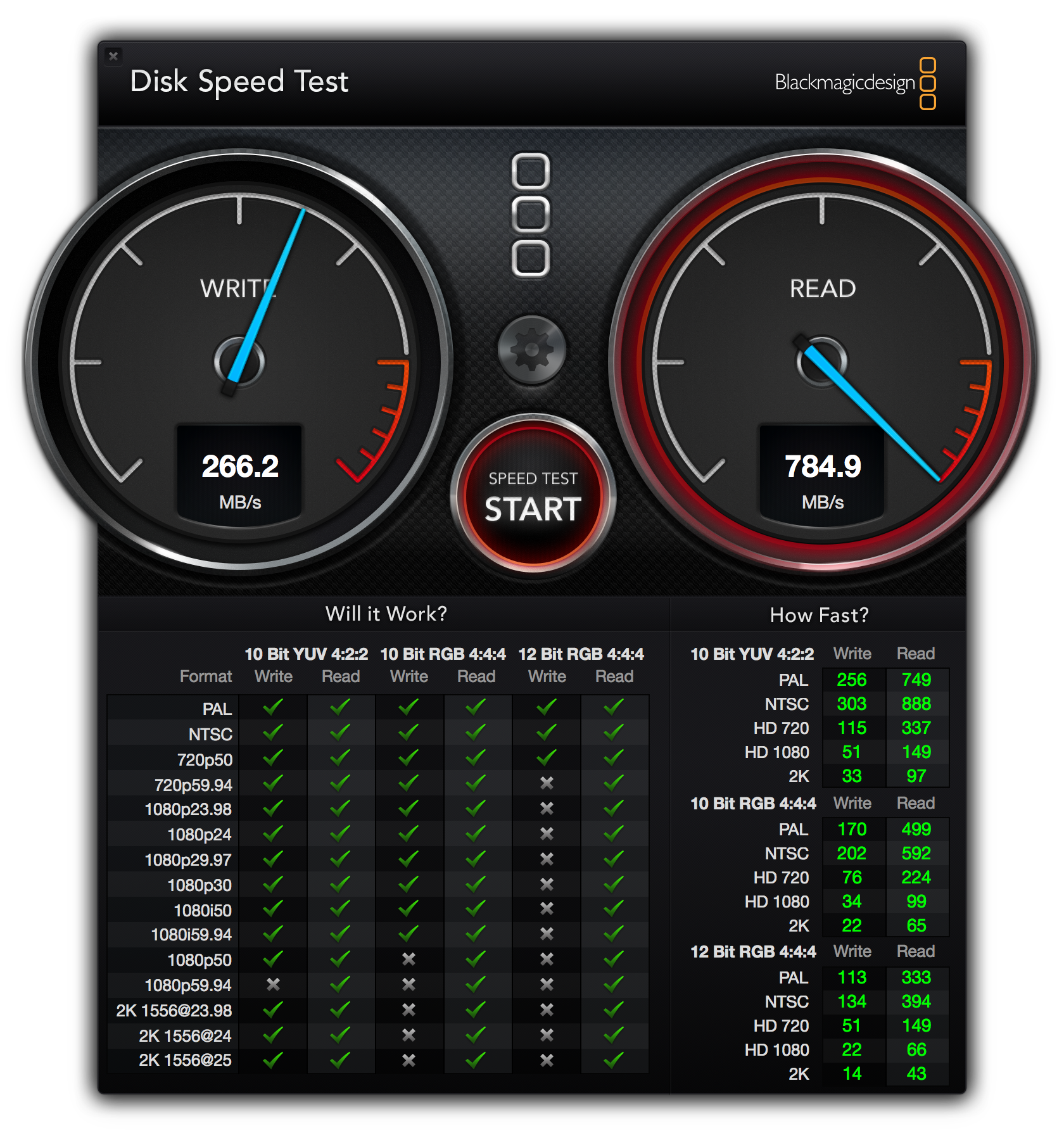

Anyone know why my write speeds are so poor? This is a 512GB model and I've tried restarting a few times and made sure nothing else was running in the background. It took so long to transfer my time machine backup because of this.

Is it brand new? I say this because if file vault is still processing in the background it will nuder your speeds.

I got it yesterday and yes, I turned on the vault security but it was a full day ago and I haven't kept it shut. So by having this encryption on will that affect backup transfers indefinitely?
Those speeds are standard for the rMB (250-400) for write. Let the app run for a little bit.
^ This. I suppose we'll find out eventually why, if you let the test run for a few minutes, the measured read and write speeds get faster and faster.
I also got the same results. But if I let it run for a few seconds it will "catch up" to full speed.

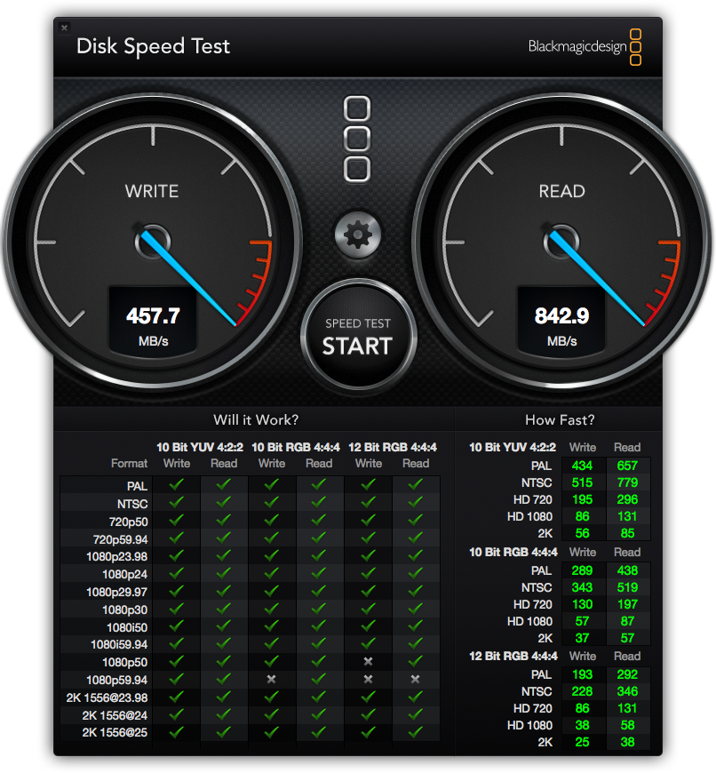

If I just let it run this is where my rMB caps out:

I don't think so. I ran this test before and after FV2 encryption and the speeds were the same. Like within +/- 5MB.

No, having encryption on is fine. I'm speaking about when you open the box for the first time and setup the laptop, for the first hour or so file vault is processing.
You would need to go into preferances/filevault to see it's status. But if it's been a day it is done.

Can't believe I'm quoting C2R here and agreeing 😉, but this is right. FV2 is not a zero-impact situation but once the disk is encrypted you'd be very unlikely to see the difference without doing a careful side-by-side test.
