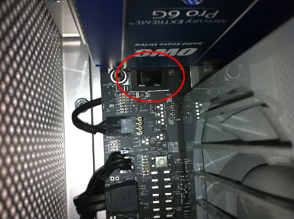

One thing I did notice tho, when you put a 3.5" drive into a bay, just under the Sata plug is a metal contact. And it gets pushed in when a drive is put in. When I put the 2.5" SSD drive in with the 2.5"-3.5" adapter, the drive doesn't reach the contact.
I assume the contact is one if two things. A temperature sensor, or switch telling the computer a drive has been placed there.
Could anyone confirm what it is and could this cause issues?
Cheers.
heres an image
