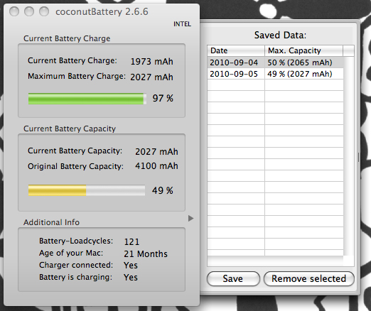

Suddenly, yesterday, the battery health went from 96% to 54%, and now every day 1% goes to the Creator😎
Yes I calibrated regularly 😕
Maybe it has to do with :apple:🙄$
Live long and prosper was the initial idea, wasn't it?
coconut image
here is the coconut
coconut will answer your questions

I would try calibrating again, and make sure you do it the way Apple recommends. Many people don't understand that simply draining the battery and recharging is NOT the same as calibrating. The specific steps for calibrating a notebook battery are here: Calibrating a portable computer battery
GGJ,
calibrated as prescribed, at least 2 hours held the thing at 100%, than drained the battery all the way down, and after at least 5 hours of no juice, connected the MagSafe.
For last 10 days I am calibrating daily, battery health went up all the way to 89%😛, on 5th day, but dropped yesterday (after calibration) to 44%😎

All reliable battery information IS common knowledge, since Apple posts such information publicly. If your battery health is really 44%, there's nothing you can do to improve that. There are no "hidden secrets" that will restore health to a dying battery; only recommended tips on how to minimize depletion though proper use. All batteries are consumables, wearing out over time and use. That's why they're not covered by warranty, except in the case of manufacturing defect. If yours has reached the end of its useful life, replace it.

Assuming that 21 months and 121 charges are accurate, then it's not likely Apple will be replacing your battery. Those readings indicate that you're rarely using the battery and discharging your battery once a week over two years will likely result in a bad battery. I'm no expert in how battery works and some will argue with what I said doesn't matter and the battery is defective but constantly connecting to power will result in a shorter battery vs. using the battery occasionally. I don't think the 300 charge/80 percent will apply here.
(read: http://www.apple.com/batteries/notebooks.html)
