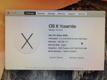

Theoretical memory limit has been breached!
So far I have 160gb of ram, I think it can go further.
At 160gb using 5 sticks of 32gb I tried adding an additional 32gb using two 16gb sticks and I got a kernel panic.
However when using just 32gb the system it works perfectly.
I attached a screenshot of it showing as 160gb of ram.
So at least we know for sure it goes above 128gb, it doesn't seem to recognize my 6th stick that should put it
at 192gb.
Anywhoodles, any thoughts?

That's great news! Weird that it doesn't show the speed.
1) Can you post a screenshot of System Report -> Memory? It may show the speed.
2) Clarification - you say your system doesn't seem to recognize your 6th stick. Is your 6th stick a 32GB DIMM or a 16GB DIMM?
3) Have you tried adding just a single 16GB DIMM instead of 2? Did that work?
4) When you get a kernel panic, did you attempt to boot in safe mode? Did that work?
5) Can you try booting into memtest86 with 192GB of RAM? If memtest86 shows 192GB and memory tests fine, that could hint that OS X may not be compatible with more RAM, even if hardware can handle it.
