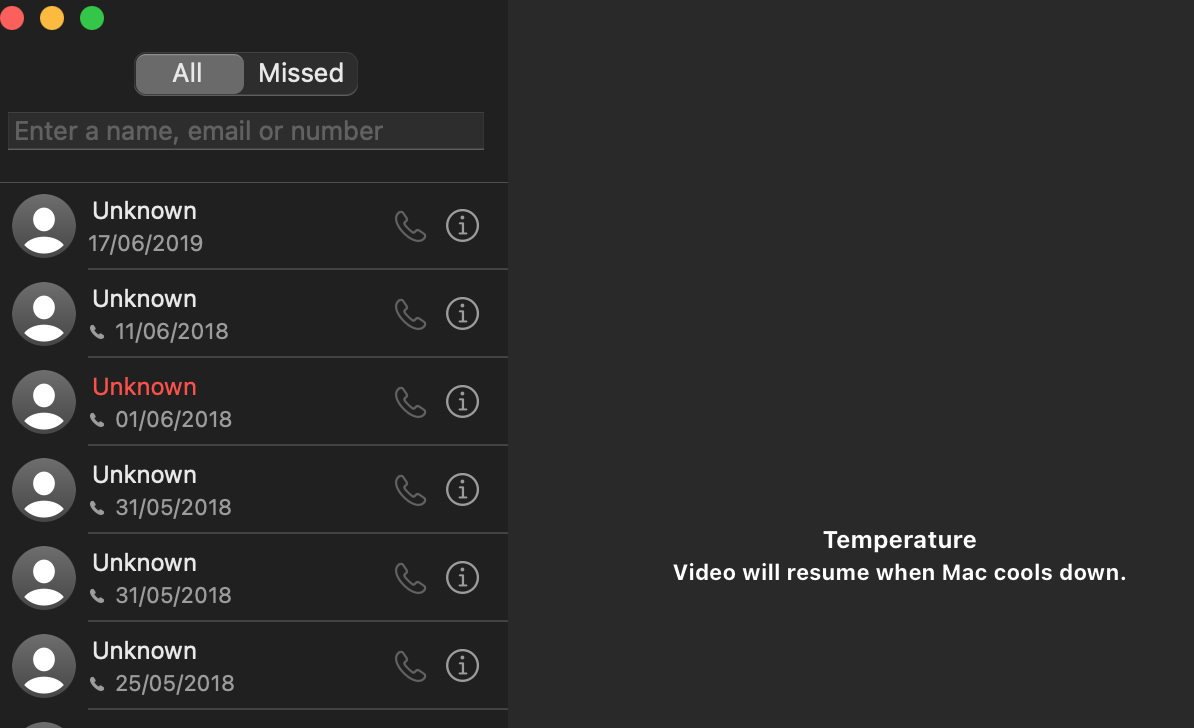

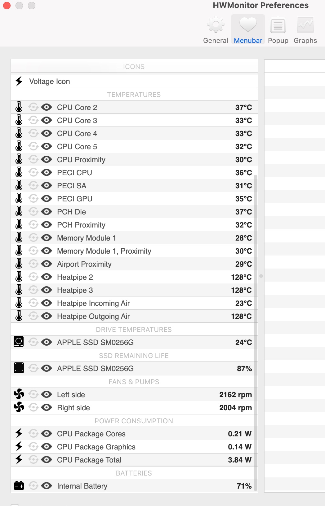

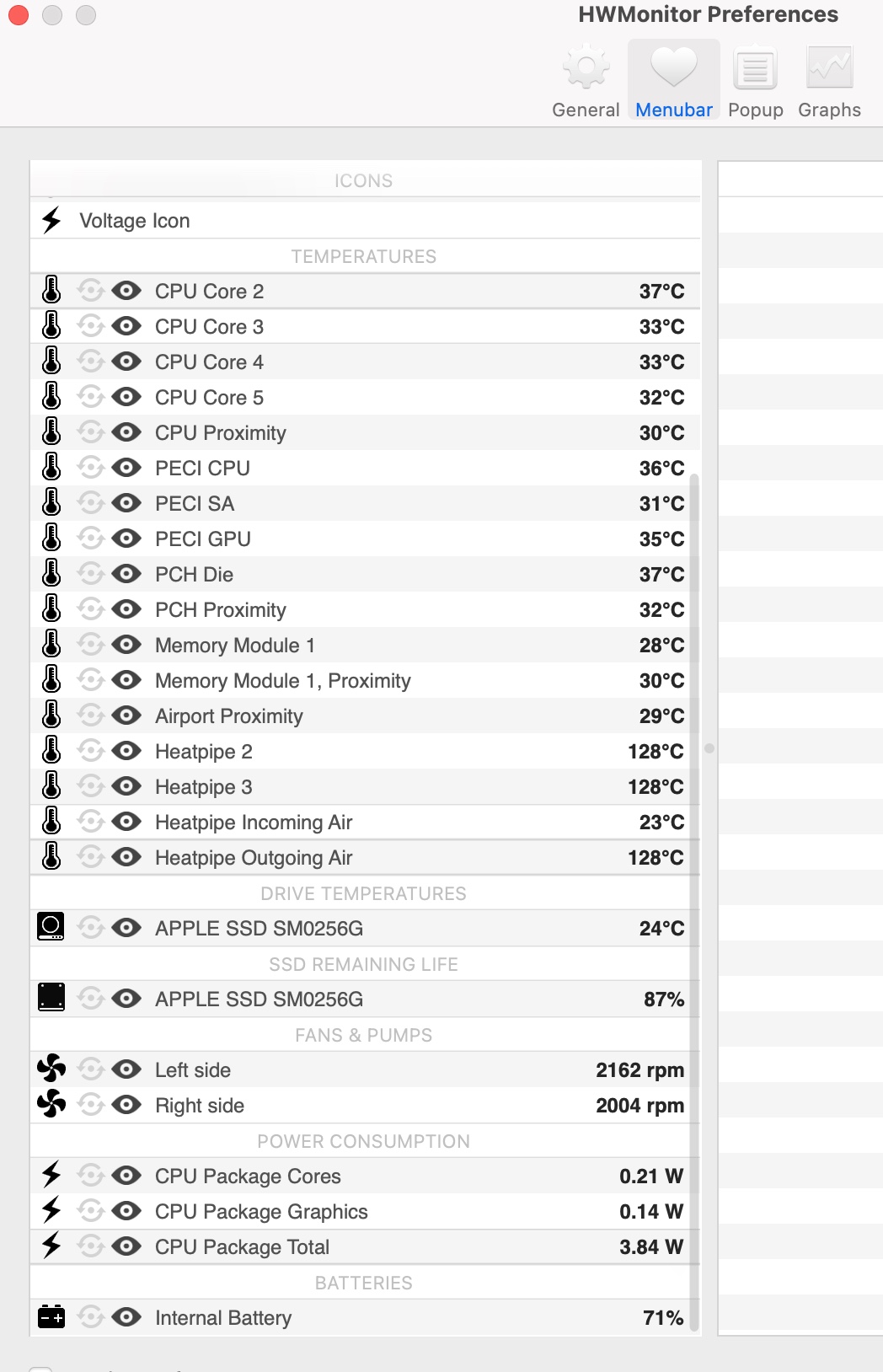

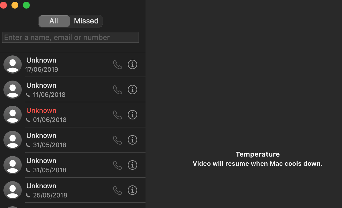

Recently my 2015 MacBook Pro fans have been going crazy as well as the cpu throttling. Going into a temp sensor app indicates that heatpipe 2,3 & heatpipe outgoing air has a temperature of 128C (see photos) which is causing the kernel to think the mac is overheating and the fans are on 6500 rpm all the time. I can’t even use FaceTime at all because it needs to “cool down” when it’s already freezing where I live.
I’ve used a third party app for the fans but the machine is unusable because of it being so laggy. Is there any
software workaround it to make the kernel not think its overheating or is there an easy hardware fix
which I can do? Any help would be much appreciated.

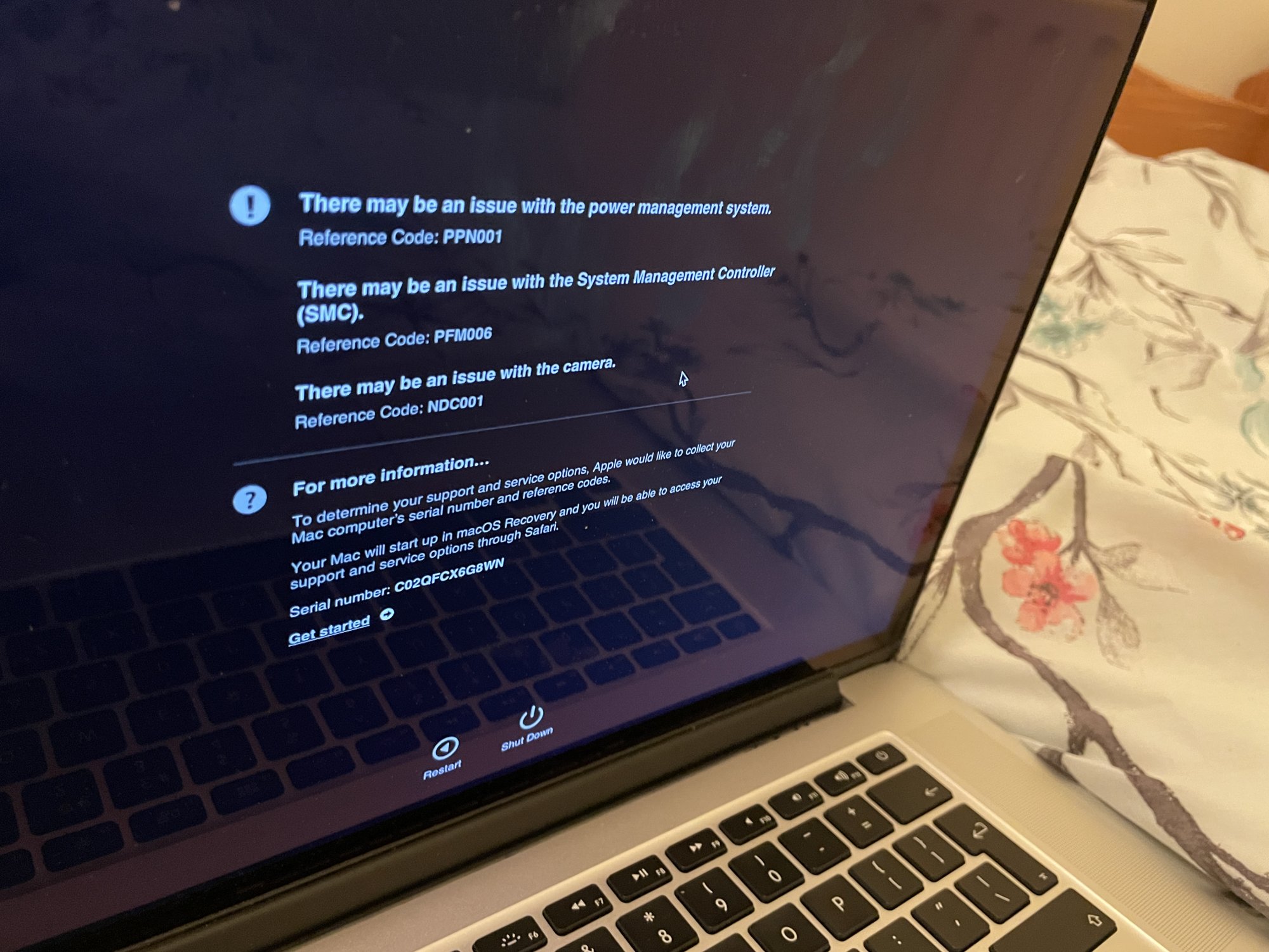

Hardware Diagnostics indicates codes: PPN001, PFM006 & NDC001
Sometimes these codes disappear briefly and Mac runs perfectly for about 10-15 mins before cpu overloads once again!

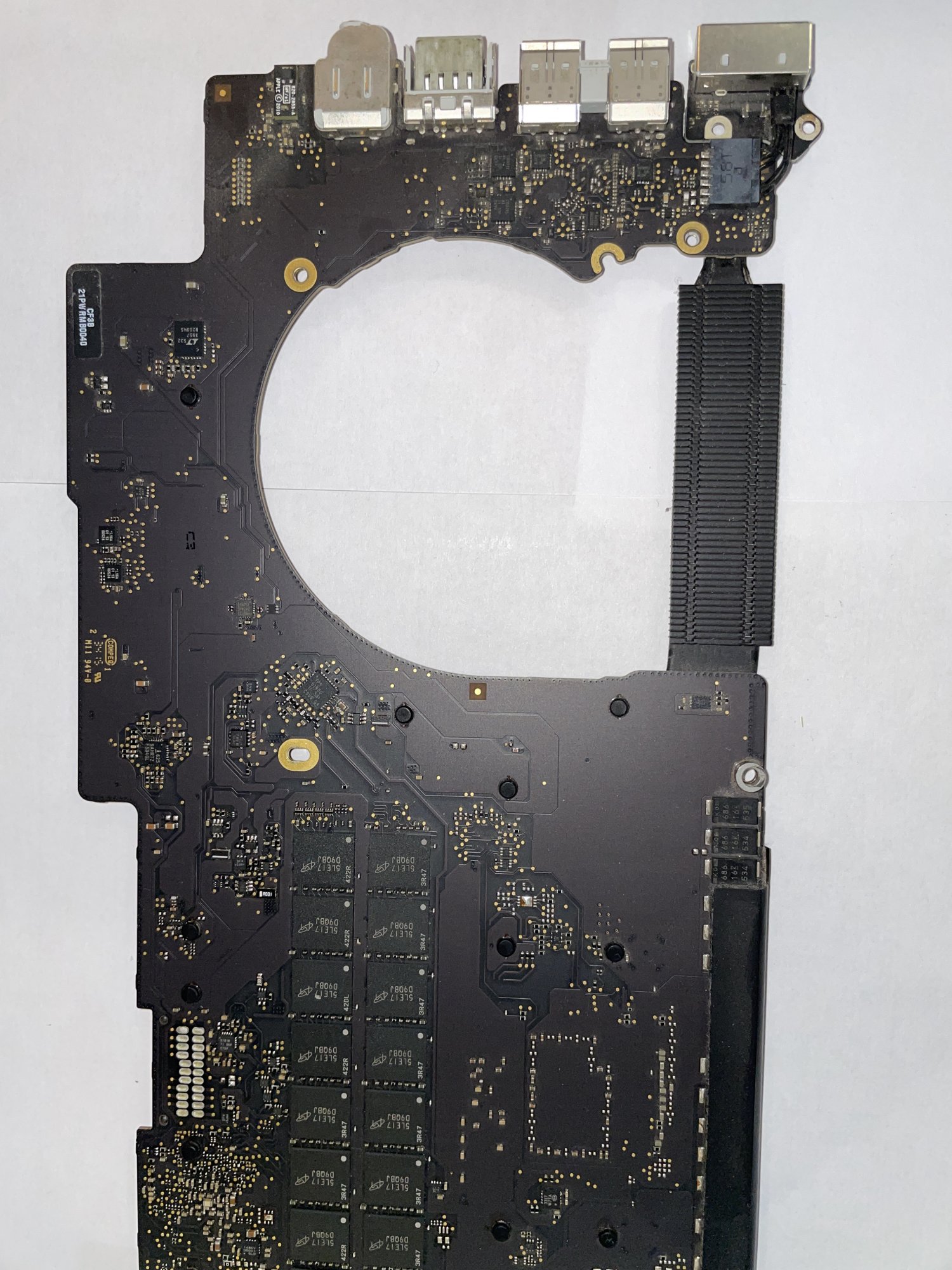

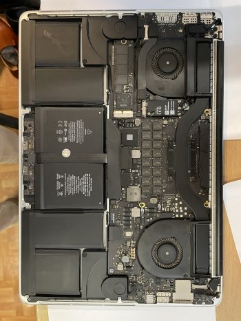

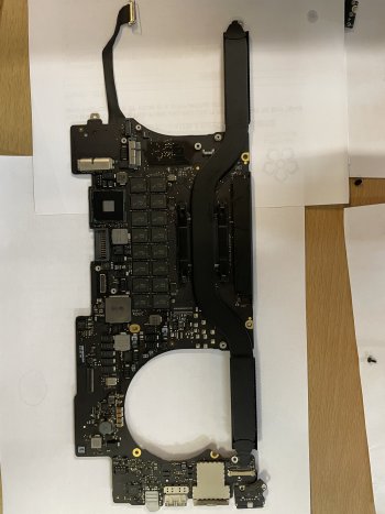

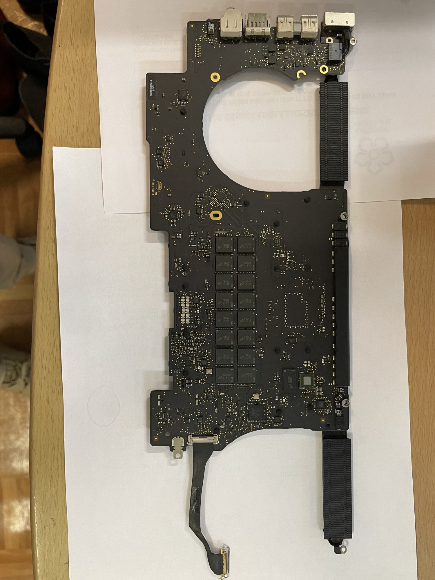

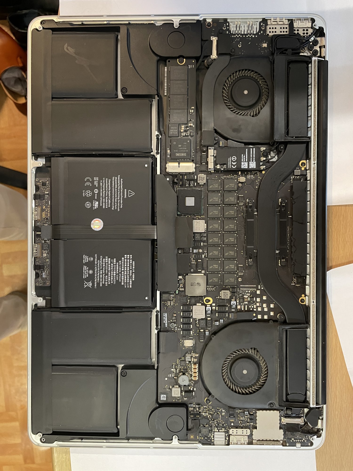

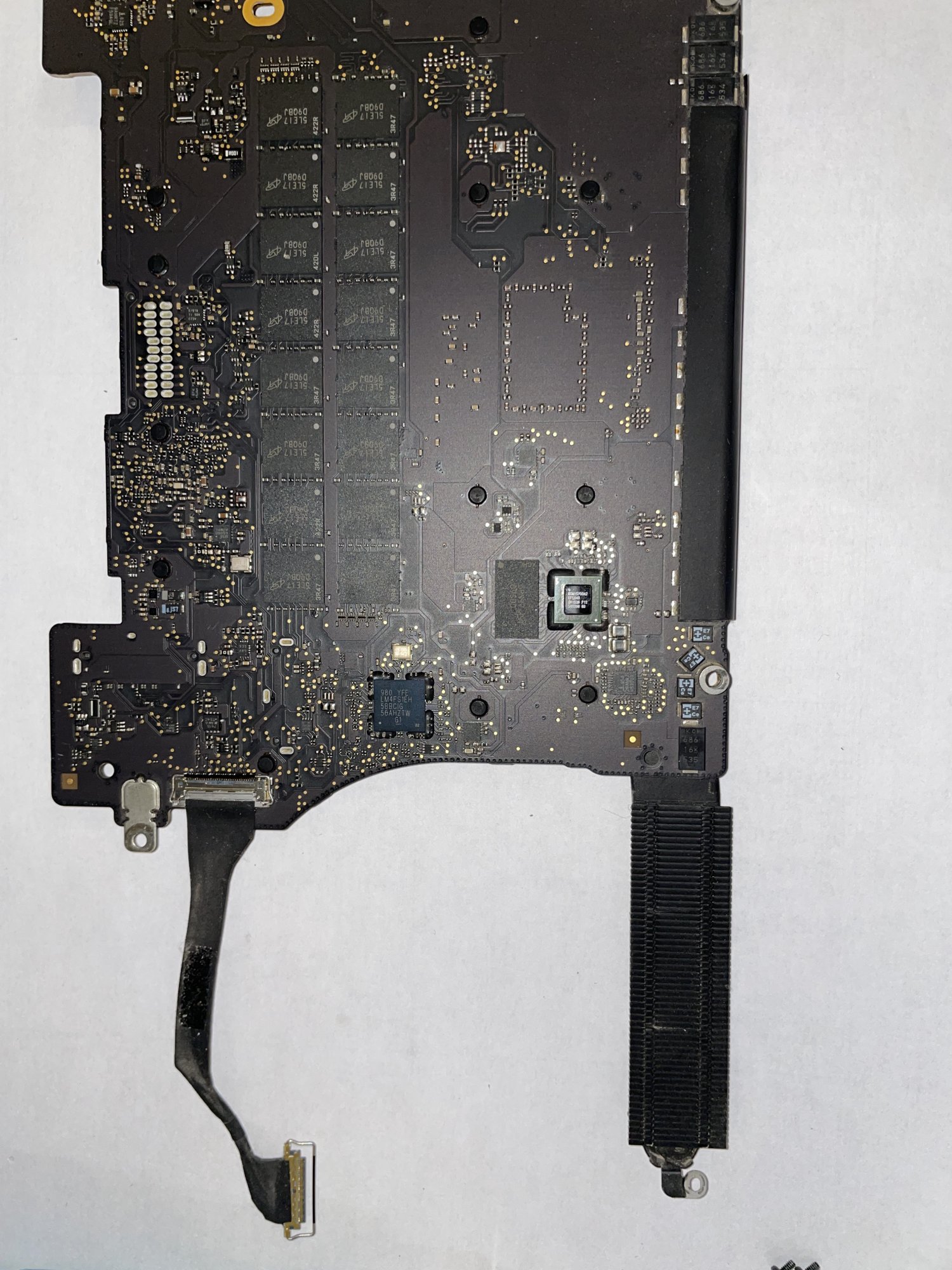

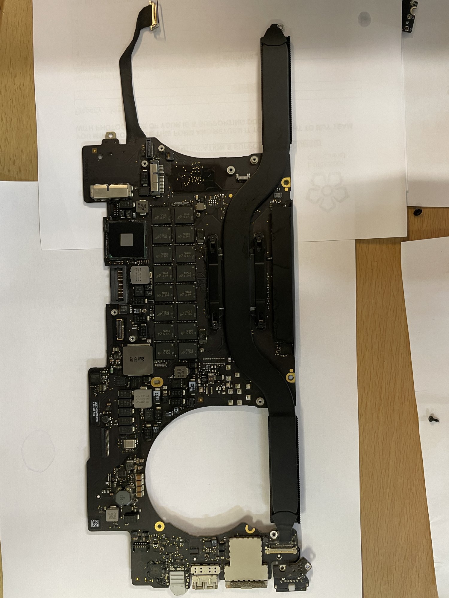

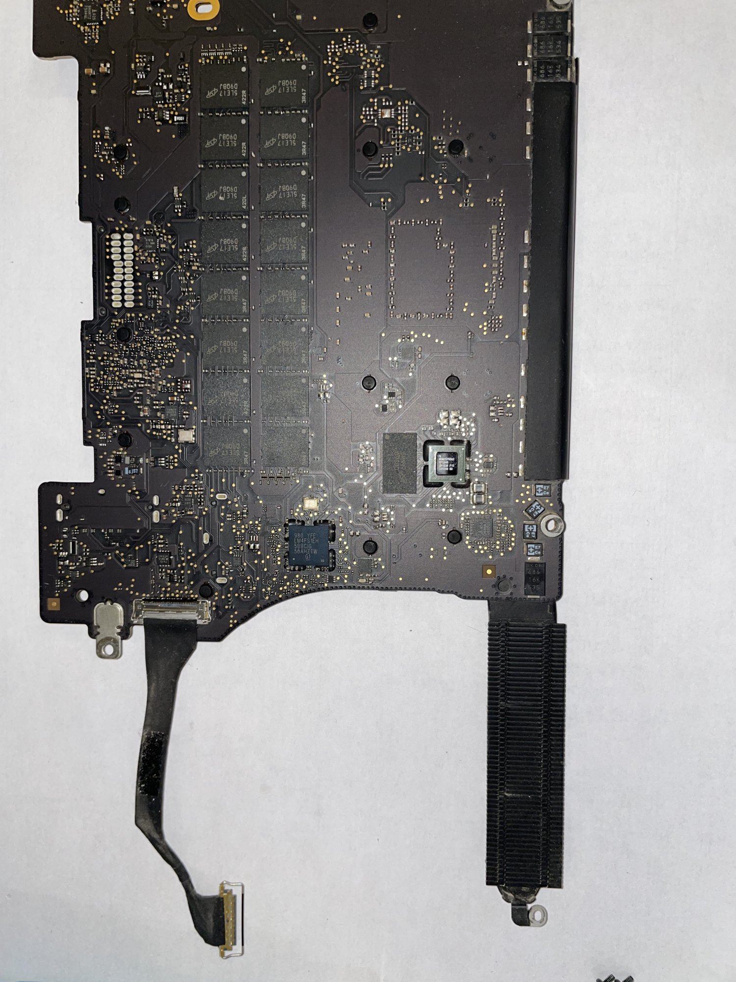

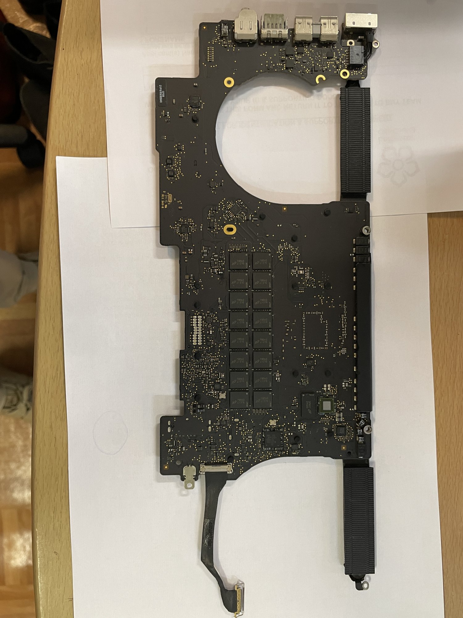

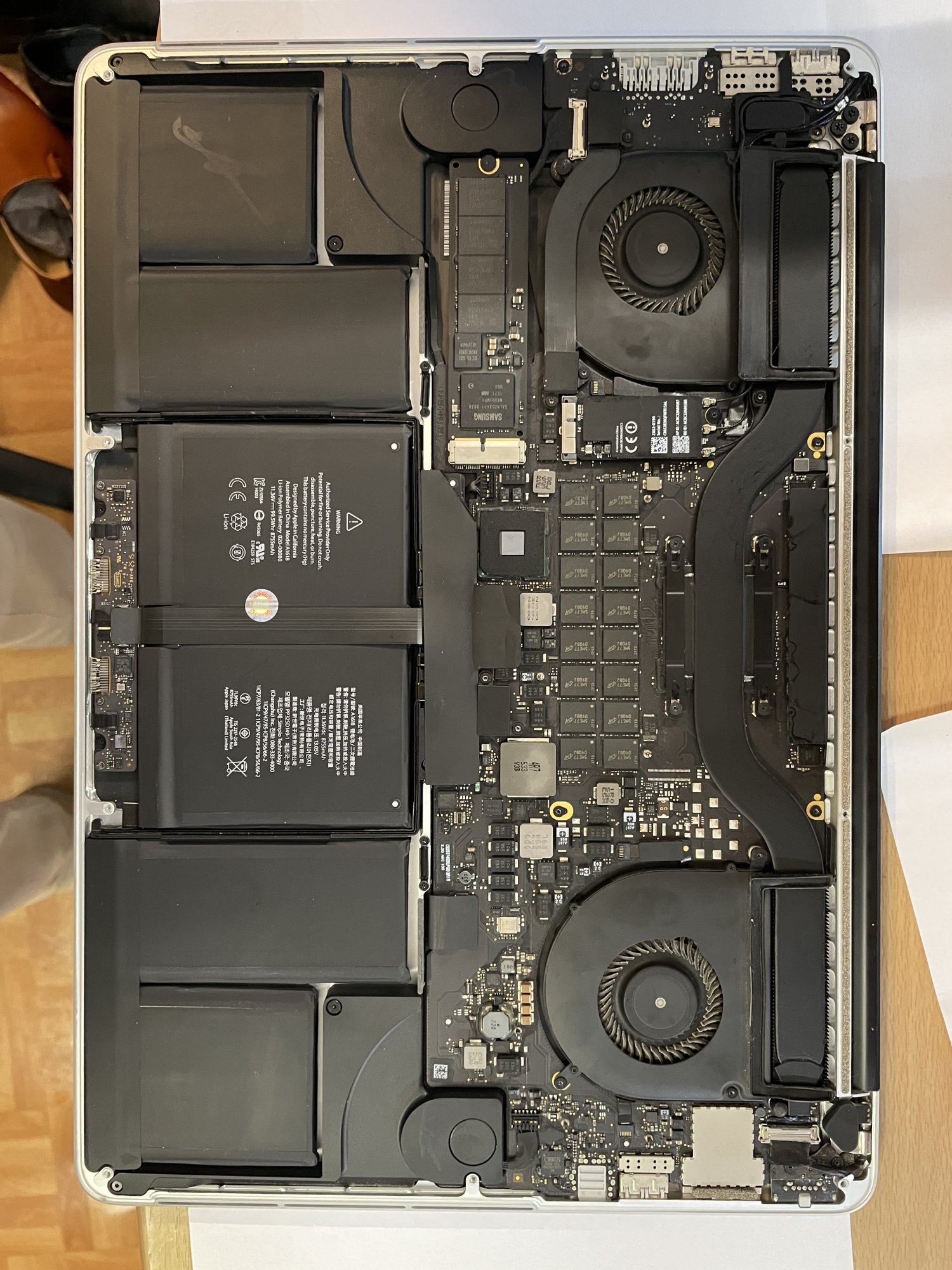

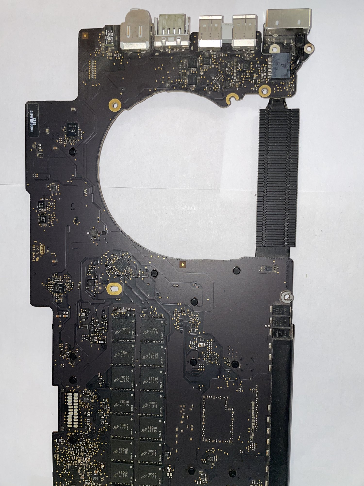

Yes, I’ve watched some YouTube tutorials and I’m familiar with disassembling the Mac. I’ve done it and could not find any signs of corrosion. I don’t recall spilling anything on my Mac either, I’ve attached some photos of the logic board which I’ve recently cleaned. Do you see anything peculiar anywhere on the Mac? Sorry, I’m no expert with logic boards.

The 128C just doesn't jive with the other temperatures, or the ~4W power consumption. And that temperature would seriously melt plastic. I think you've got a faulty sensor, or possibly whatever fan control software you've got running is giving a faulty reading back to the system.
Delete the fan control software for starters, and make sure you get all the kernel extensions and other segments of code it added. Reboot in Safe Mode, then again normally. If all else fails, backup and reinstall MacOS. (I don't say that lightly BTW). Good luck!
Honestly, it's really hard to tell with those pictures --- you'd need to look a lot closer than these pictures can show you. Additionally, sometimes you wouldn't even be able to see issues directly (which is why a good place to start would be downloading diagrams to see which components _might_ be involved), but usually you will when you start to look closer.

This is almost certainly not the software causing this issue -- those monitors simply report what the SMC is reading of various temperatures monitored around the board. This is a common issue that shows up when temperatures are simply not being reported correctly due to circuitry issues, typically due to a short somewhere from liquid damage.
Yeah, the decimal number "128" being hexadecimal "0080" which I'm sure has some significance as a signed integer. If it read 123C that would seem as a more-likely believable number, but 128C is the equivalent of an error code.

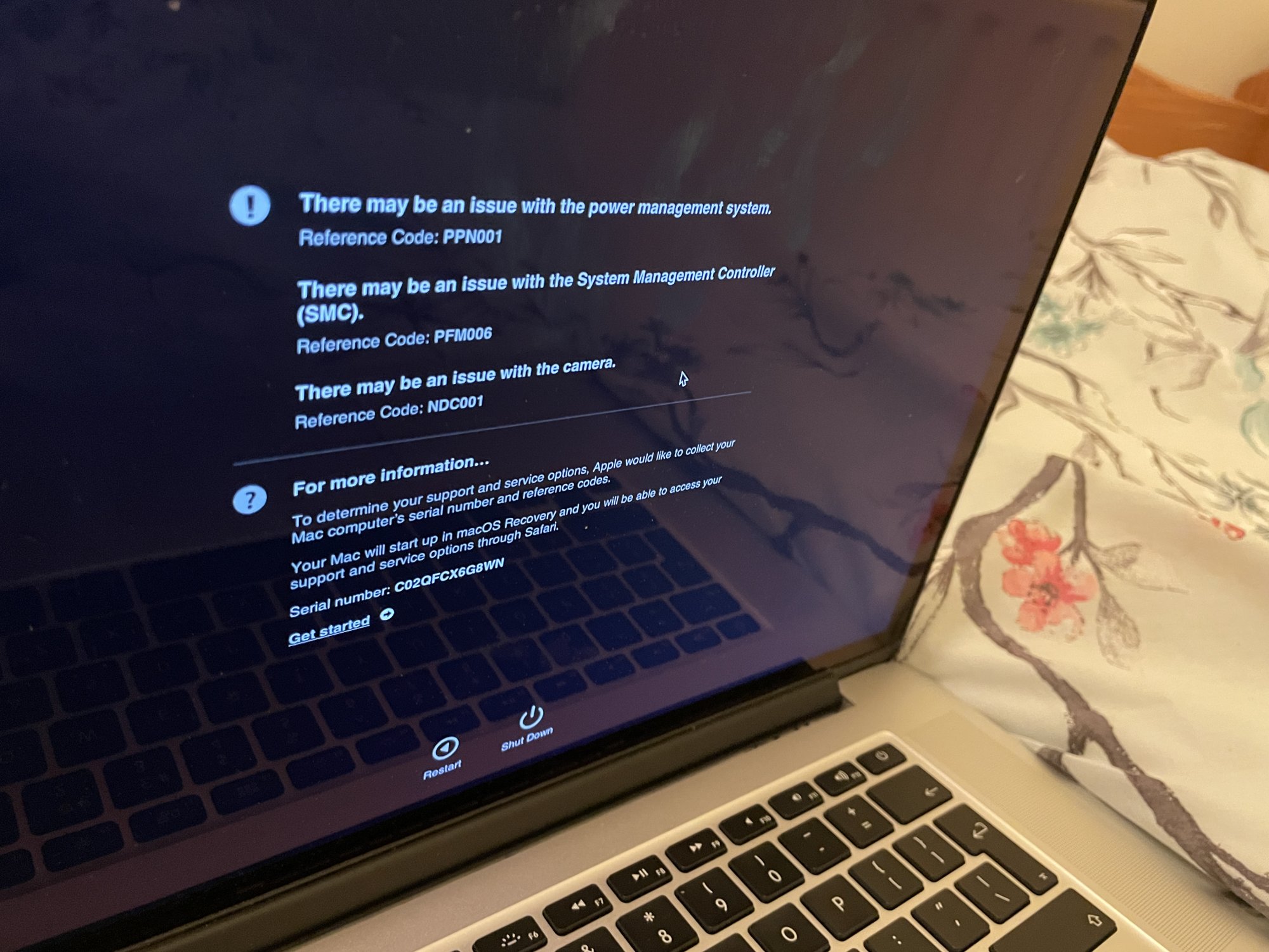

I'm pretty sure 128C is what it reads if it can't read from a sensor. Most likely a sensor is bad. What happens when you run Apple online diagnostics (Option D at startup)?
