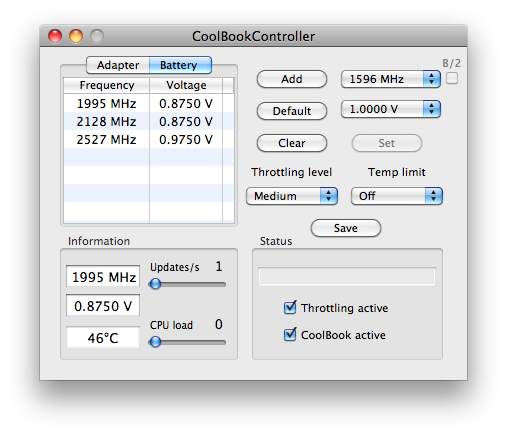

2128 MHz @ 0.8750V
2527 MHz @ 0.9750V
13" MBP 2.53GHz. Thank God for Coolbook, this thing is (or was) so hot. I discovered some incompatibilities with SL and sent a fix to the dev, shortly after he had a SL beta ready. Writing this on 10A432 and 64 bit kernel 🙂
I'm now idling at 50C before it was 60C. Max temps have lowered as well it could go over 100 before at extreme load now I'm struggling to hit 90 (testing with mprime95 torture test). Normal encoding "just" hits 80.
These numbers aren't scientific in any way but before Coolbook it was uncomfortable to have this machine on my lap, now it isn't.
2128 MHz @ 0.8750V
2527 MHz @ 0.9750V
That's as low as you can go with 2.53 ? I'm at .9000V!
