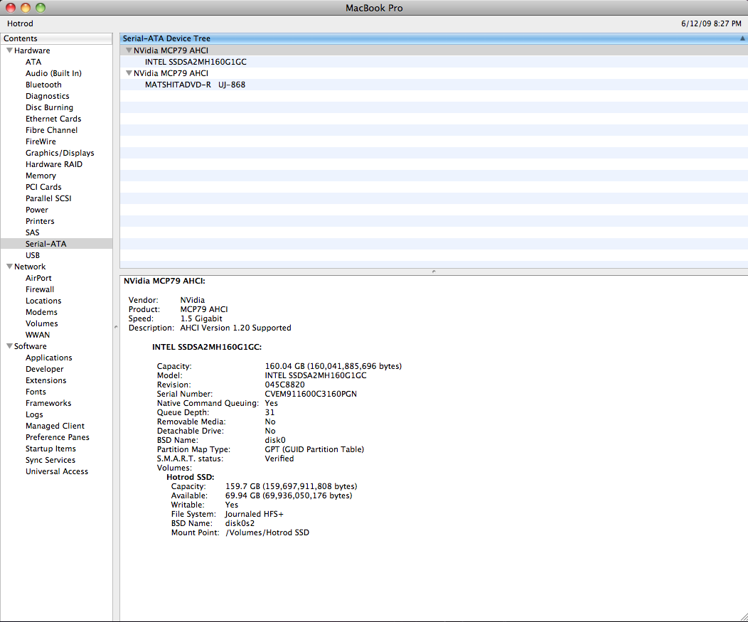

Possible, but I just tried it under Snow Leopard and it's reporting the same speed.
