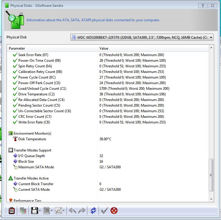

I also tested my 500GB 7200 rpm Seagate on Win 7 X64 (13" MPB 2.53 GHz). It is reporting Sata II. I believe this is probably a power management feature implemented by Apple. Probably something that is software controlled. That is the only logical conclusion I can come to.
