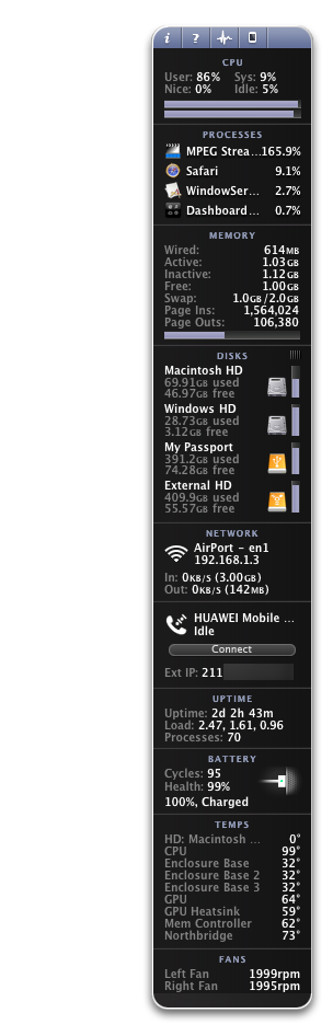

  25. alphaod macrumors Core
    alphaod
    Joined:
    Feb 9, 2008
    Location:
    NYC
    #25
    Not the least worried. Yes that is in Celsius and has been that temperature for the last 30 minutes with no change in fan speed:
    [​IMG]
