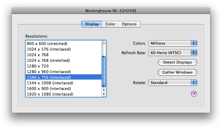

Here is screen shot of what I see on the TV.
How can higher resolutions than the TV native be available in System Preferences > Displays?
What does the "Interlaced" mean?
Just guessing, but your Mac can probably tell that the HDMI connection can output 1080

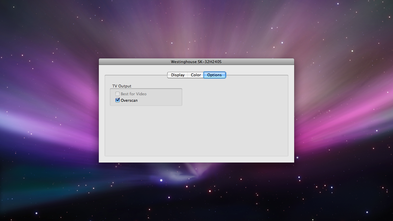

Check under "Options". There may be a "Best for Video" option. Try un-checking it, if on.
It isn't checked and it's grayed-out.
I am attaching a screenshot.

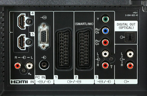

I have a SOny Bravia KDL 32D3000. Because I don't want those borders, I'll go for a mini-DVI to VGA connector on my MacBook. Here is the back of my TV. If I use the VGA port, does that mean I can't connect a jack-to-RCA cable ?

grayed out 'best for video'
Yes, perhaps.
Which resolution is the 720p setting?
Does anybody know why the 'best for video' option is grayed-out and how to resolve this problem? I'm having the same issues and nobody really answered RichardF (I'm not trying to hijack your thread)
