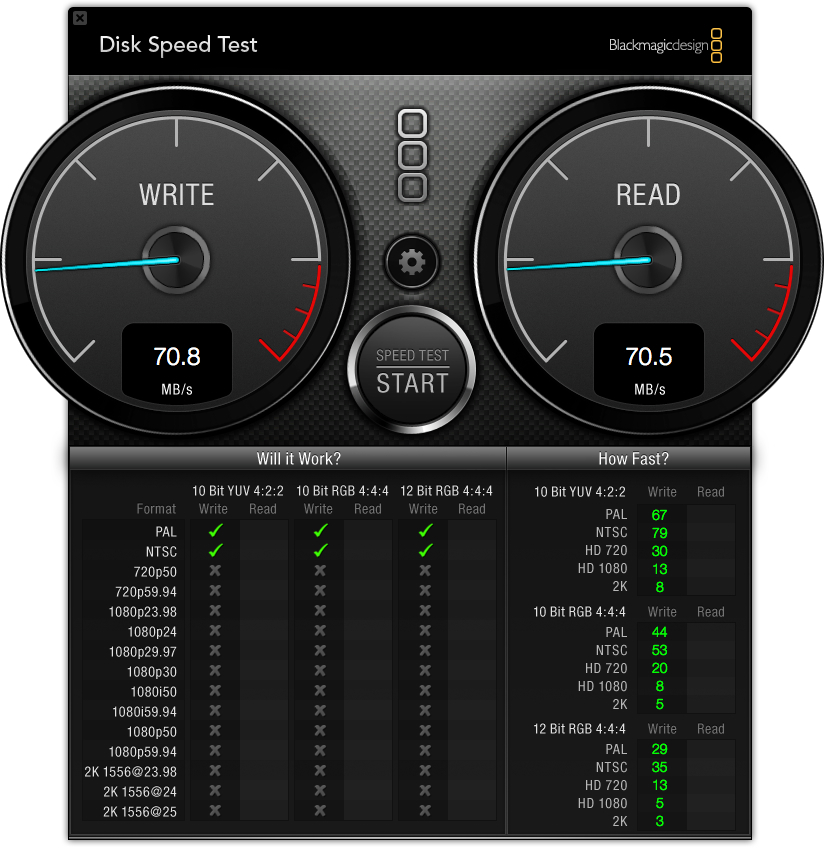

I have a Seagate FreeAgent GoFlex Ultra Portable with USB 3.0. I am only get the speed that I have attached in the picture. Thought it would be faster than this.

It is transferring from the HD of the rMBP. It is flash storage, basically SSD. I used Black Magic Disk Speed Test. It is free from the Mac App Store. I get speeds in the 400mbs with the Flash Storage on the rMBP.

It doesn't seem that low. You have a 5400rpm hard drive on USB 3.0... portable hard drives are not much faster than that.
If the harddrive is slow USB 3.0 is not going to magically make it faster. 70 Mb/s sound about normal for any harddrive that is not ssd.

So even if I had the Thunderbolt Adapter, it wouldn't be much faster?

Nope. A 5400rpm drive isn't able to go much faster than that as others have pointed out. It's not so much the speed the connection can handle but the speed the device can cope with. If you had a new, fast SSD on the end of that USB 3.0 cable you'd see much faster speeds.
Even with your current setup the speed you're seeing is at least double what you'd see in a real-world situation with USB 3.0.

if you want to spend money to get faster transfers, look for external hard rives that are 7200rpm (still doesn't matter if USB 3 or ThunderBolt) Or ever external SSD drives. Elgato makes an external Thunderbolt SSD thats wicked fast.

I just ran the BlackMagic speed test on my 2012 11" base MBA with my new 1.5 TB Seagate FreeAgent GoFlex on a USB 3.0 connection and got about 80-85 on both read and write.
For comparison, when I ran the same test but with my Toshiba Canvio USB 2.0 drive, I only got 19-23 write and 27-31 read.
