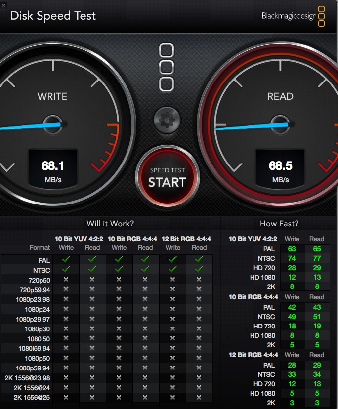

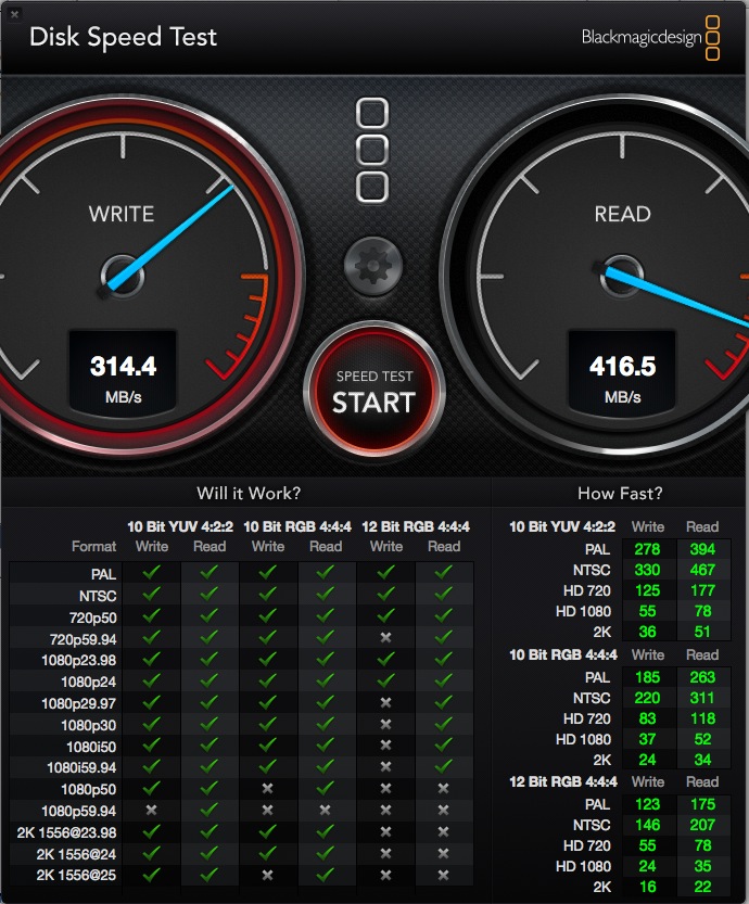

I have a USB3 drive which seems to read/write at 68 MB/s. But the main Fusion dive in my iMac is much faster at 315 write, 415 read. Can I expect more from the USB drive? Wonder if it needs a firmware update?
If it is a normal hard drive hooked up to USB3, then No. The reason your fusion drive appears so fast is because it is reading/writing to the SSD portion of the drive. USB3 is capable of much higher speeds than 68 MB/s transfer, so that is the max speed of your hard drive.

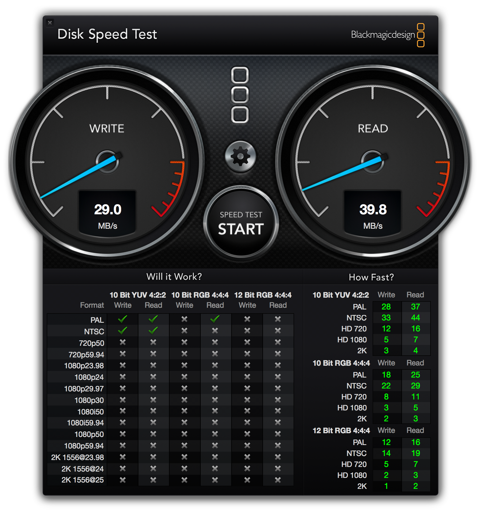

I was losing my mind as my USB 3.0 WD 1TB external was getting 30 MB/s read/write on the right USB port on my rMBP. After connecting it to the left USB, verifying a read/write of 100 MB/s, and reconnecting it to the right USB port, I was getting the appropriate speeds again. You can also checkout the system report and make sure the device appears under "USB 3.0 SuperSpeed" and not "USB 3.0 Hi-Speed". See screen shots below (both are testing the same external HDD on the right USB port).
Screen Shot 2013-05-14 at 2.59.37 PM.png Screen Shot 2013-05-14 at 3.31.26 PM.png

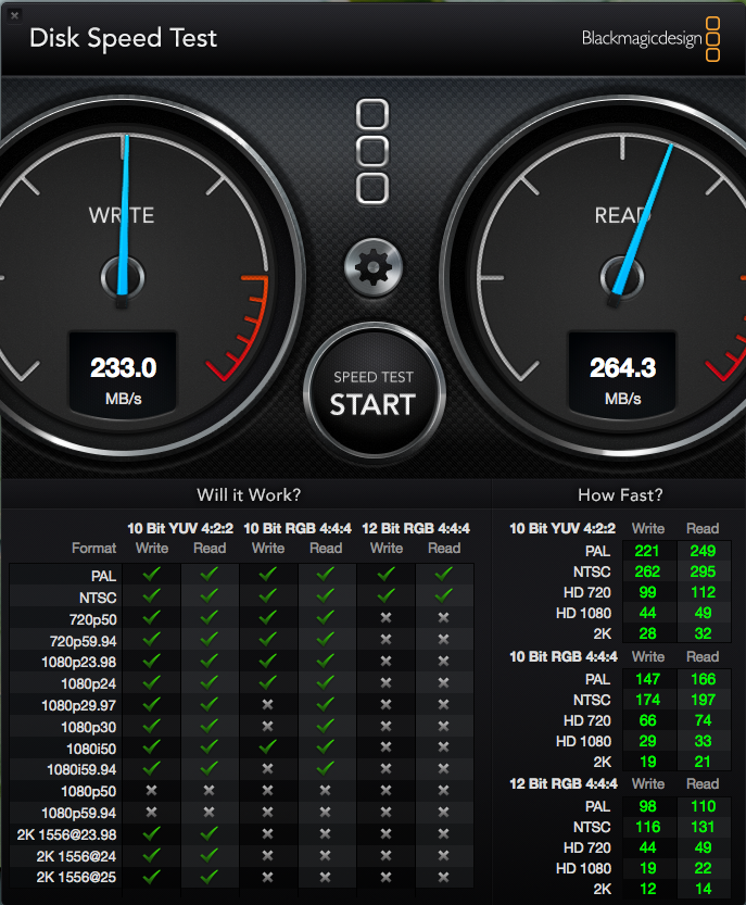

Wow!
These are my USB 3.0 Speeds I get.
2 by 4TB (8TB) Seagate Backup Plus w/ Barracuda 7200rpm drives inside running through Belkin USB 3.0 cables to a Kanex 4 port USB 3.0 hub set up as RAID-0 through OS X Apple RAID.
233/264 write/read

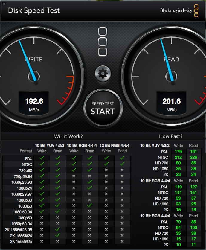

1 3TB Seagate Backup Plus w/ Barracuda 7200rpm drives inside running through Belkin USB 3.0 cables to a Kanex 4 port USB 3.0 hub (No RAID)
192/201 write/read
And for comparison to the 8TB USB 3.0 RAID:
2 by 4TB (8TB) Barracuda 7200rpm drives running as RAID-0 in an OWC Mercury Elite Pro Dual (Oxford 846 chip) through eSata via a Lacie T-Bolt eSata Hub.
221/230 write/read
